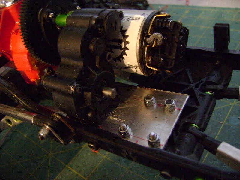

I have had this project in mind since the MSD scale nats ended.Thanks To Slobin
Plan is to build a street legal rig
Started with a parallel upper link set up.
That was done so I could add the power plant to it.

Originally I had planned to use the Cad to Chrome tranny I have with a transfercase aet up,but it was going to be mostly hidden and it seemed ashame to hide that great looking piece of craftmanship...so,it will be used on another build. I had to flop the tranny and make an adaptor plate to set the bias forward.I wanted the weight up front and the motor needed to clear the interior without that big old spur gear sticking thru...
I also stretched the wheelbase out to 12.5ish while flopping the trans using the high clearance links
