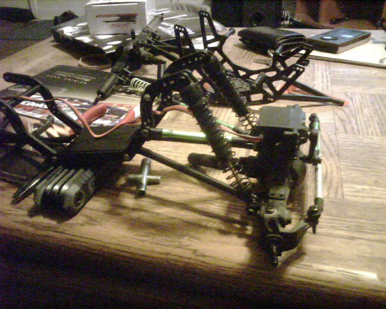

ok some real pics.......
what i started off with

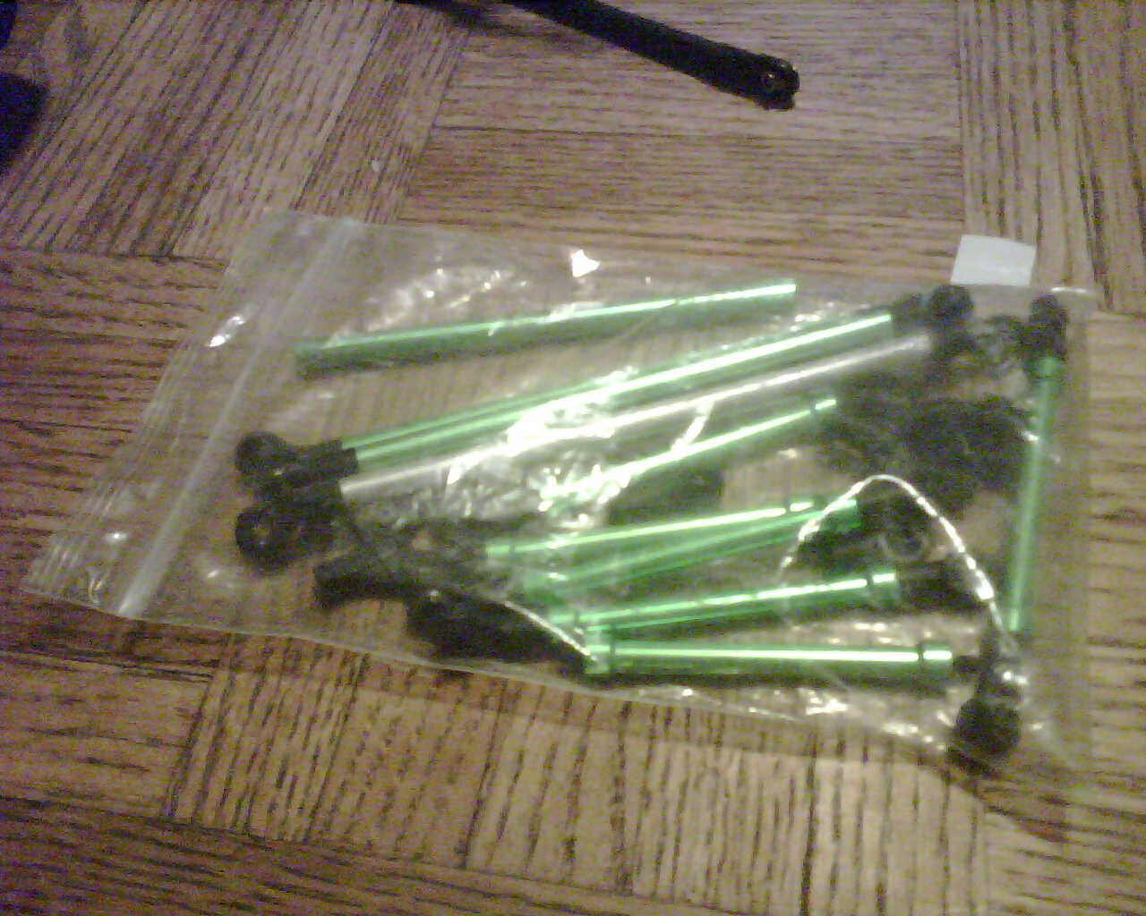

got some used links and ends!.. thanks!....

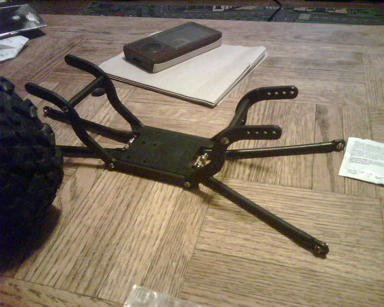

used blackwidow frame
and the rig pre make over

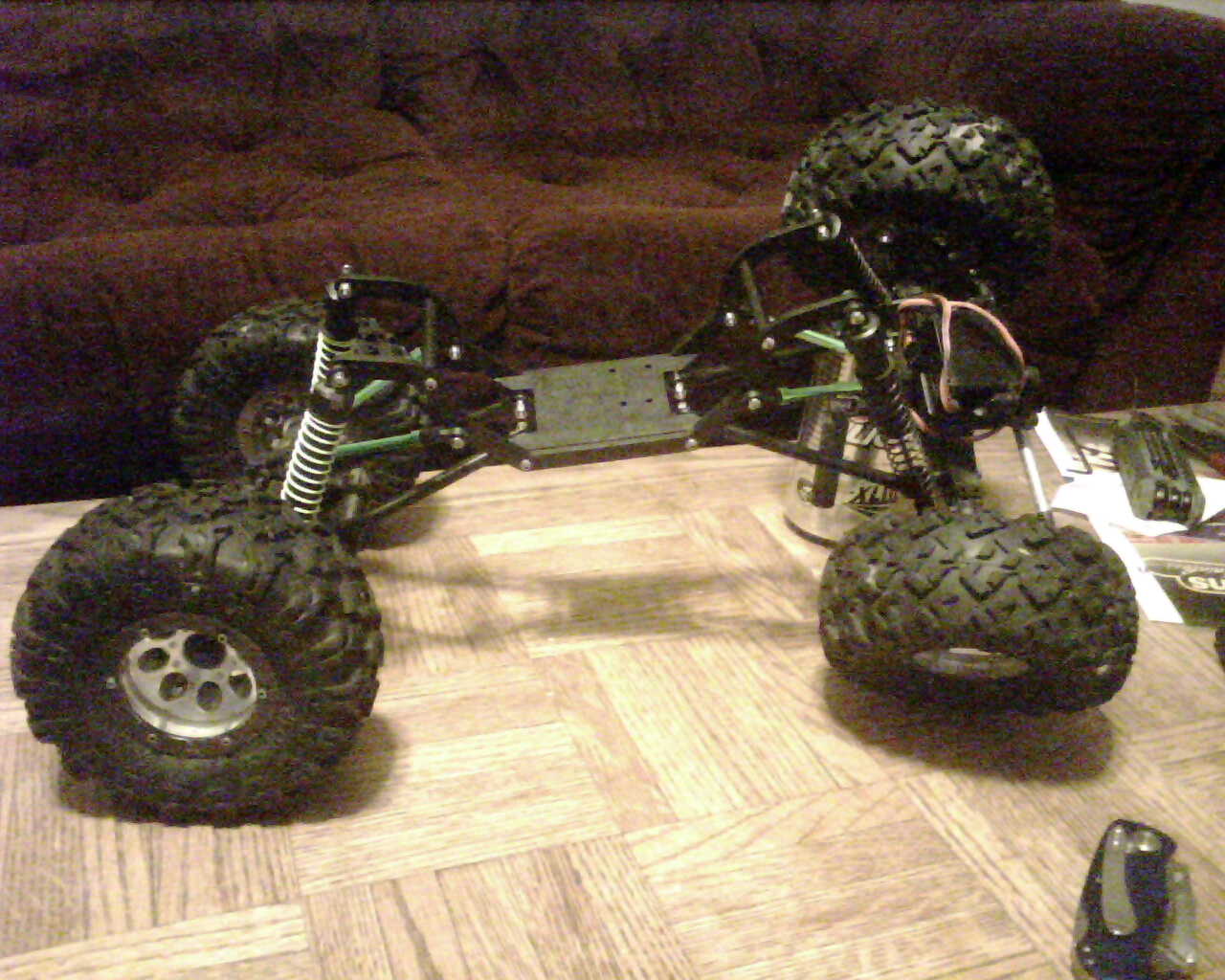

as i started swaping to the new frame things seemed to fit ok, the RTR hardwear is junk and wasnt eveny usable relly for mock up.

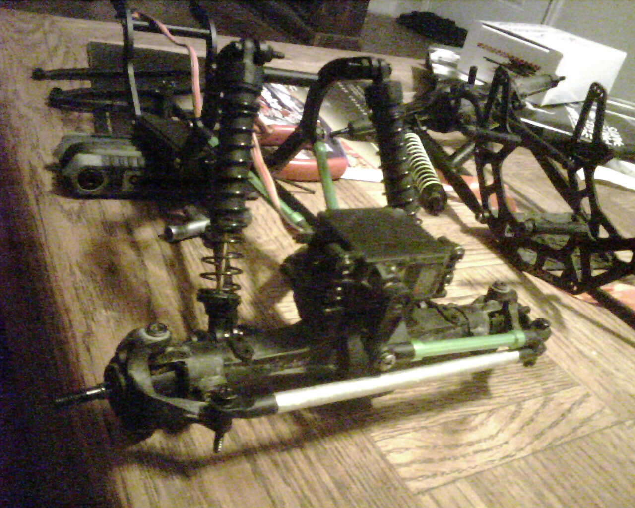

i played around w/ some of the extra stuff i had and i came up with this for steering
i really like how the steering worked out, but im afraid the stock plastic knuckles wont last long. just hand cycleing the steerign i see a lot of flex where the drag link and tie rod connect to the nuckle.

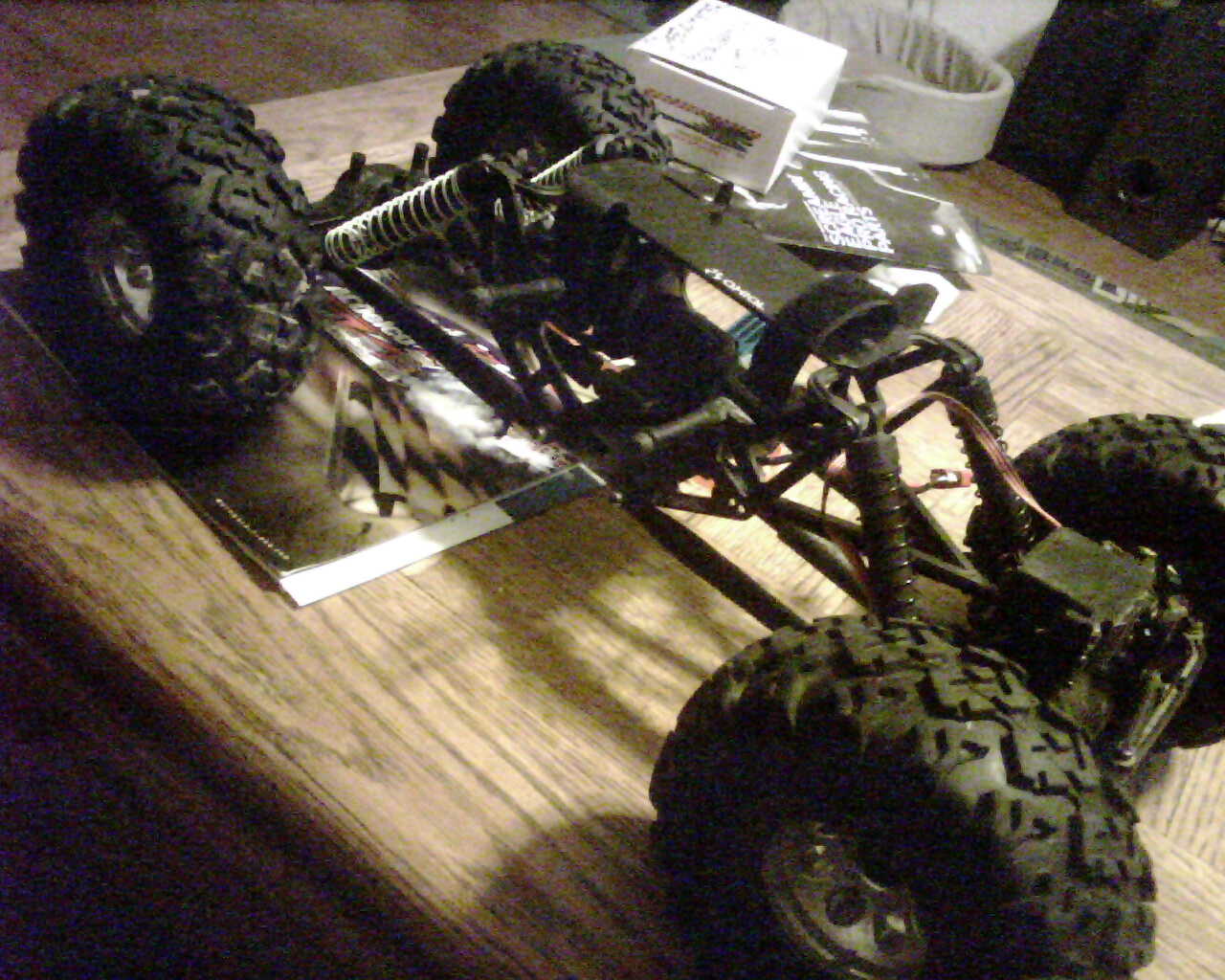

all most a rolling frame. i was a bit shocked to find otu the button head hardwear was a good 30cents per bolt cheaper than standard allen head.

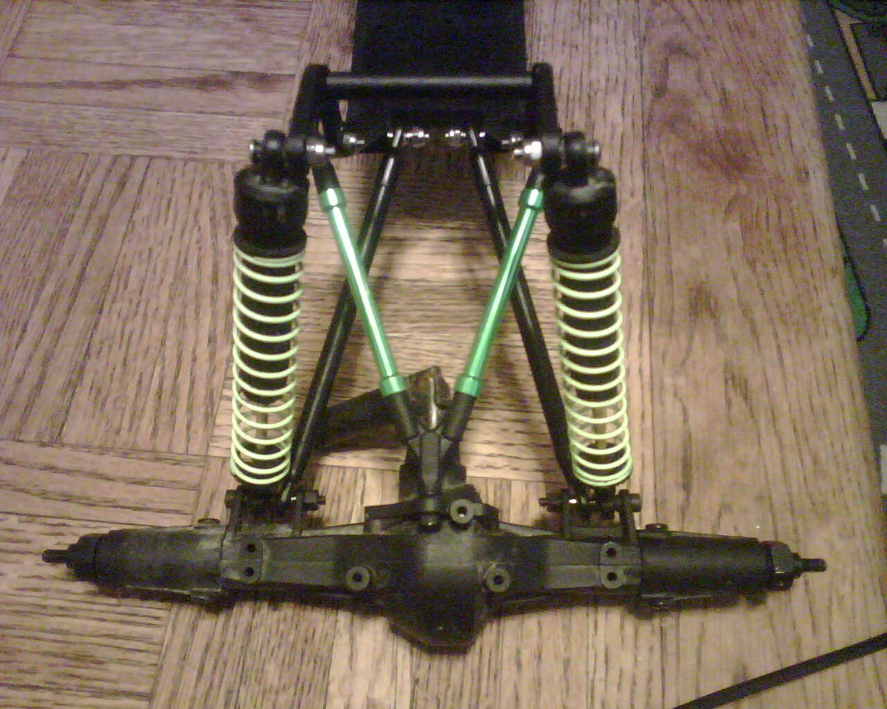

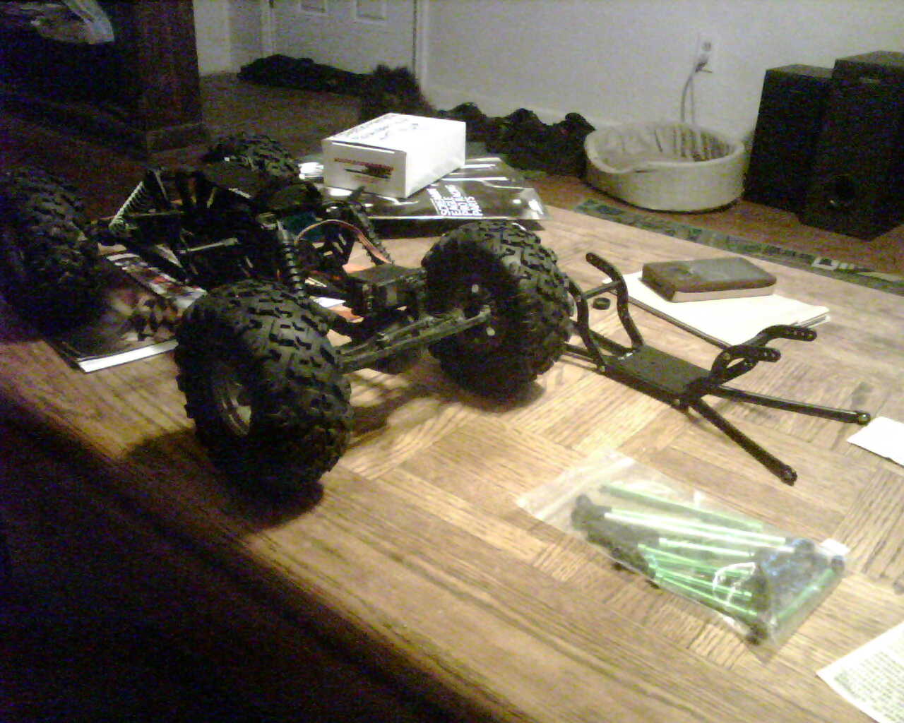

the links fit vey well and have a good duble triangulatoin affect.

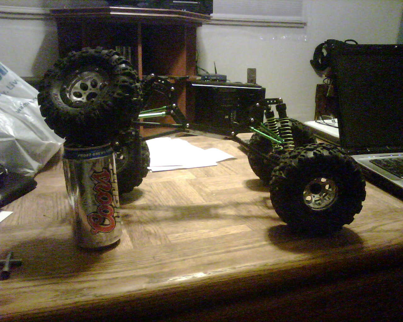

this is my max articulatoin, totaly reduced from the stock frame. wich is probably a good thing. the stock set up had so much flex i could roll the truck over just cralwing up a small rock.
i dont paln to actuly run the rig w/ the spring set up in the pics, its just how i had things on the old set up and didnt have motovaton to change them yet. i paln to run internal springs.
sorry for the crummy cell phone pics but thats all i have for a cam right now.
i need to drill the skid plate for the proper tranny locatoin still.
