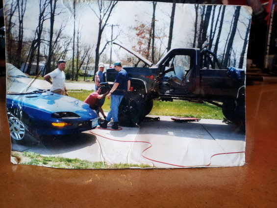

Upper right-hand corner, behind the pens and markers, there's a pic of a greenish-blue car w/ recessed headlights. Nose looks a little stubby to be a Camaro, thought it might be a Grand Prix, Grand Am.

Good eye... My 1996 i got rid of in 08 when i got my silverado... Had an 86 too.. Z with t-tops.... Liked that one more.. If i could have a 2002 with a 2013 zl1 motor id b happy.. Oh t-tops too....

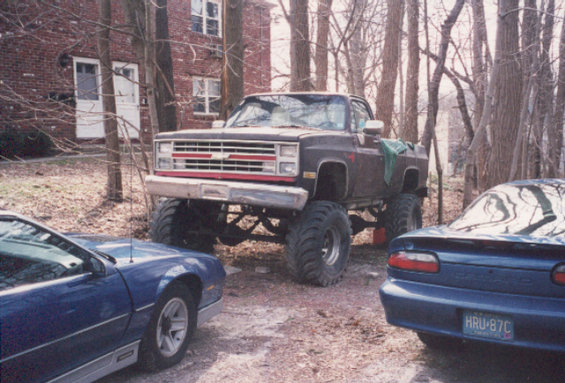

here is the full pic of what you saw..
this was my baby b4 i lowered her..
due to NJ lift laws that is too high.. and wasnt done..
13" leafs... 3" body lift.. getting ready for militaries and 53" boggers
my chevy family.. sniff sniff.. still got the truck though..

Dual F-bodies?!?!?!??! Ouch! American Family Insurance made dang sure I never got one, let alone a pair. Instead, I get to enjoy a pair of ex-rental Impalas ('00 & '08 ).
Anything else planned for the AX, or just runnin' it like it is for a while?

well i have a 05 trailblazer ext (liability), 08 silverado (full coverage), 78 mud truck (liability) and am at about $2500 a year... so i cant complain... it didnt change from the camaro's to the trucks... i want a zl1... i can afford it and the insurance..problem is wife doesnt drive a stick and I will not own one as a automatic....
you asked
