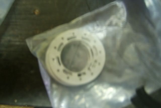

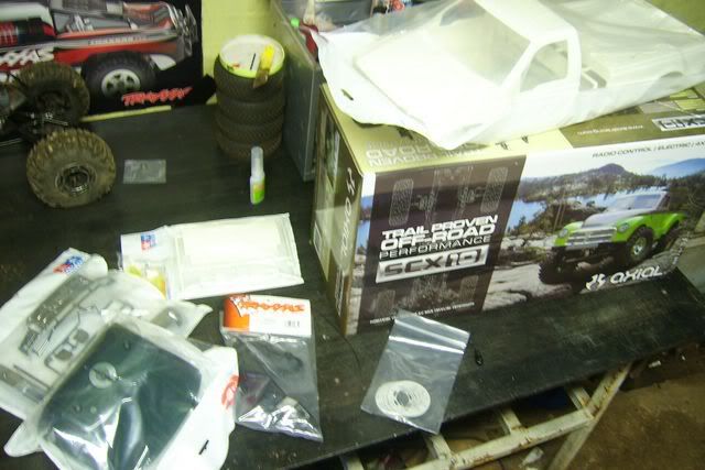

Just got my order in from RPP Hobby. Going to try out the scale thing.
My plans are Slash electronics for now until I get something better. I wanna go fast.
R2D Tranny turned aroudn backwards.
RC4WD Scale lights
Eventually build a tube/flat bed deal.

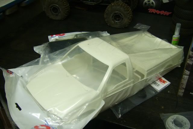

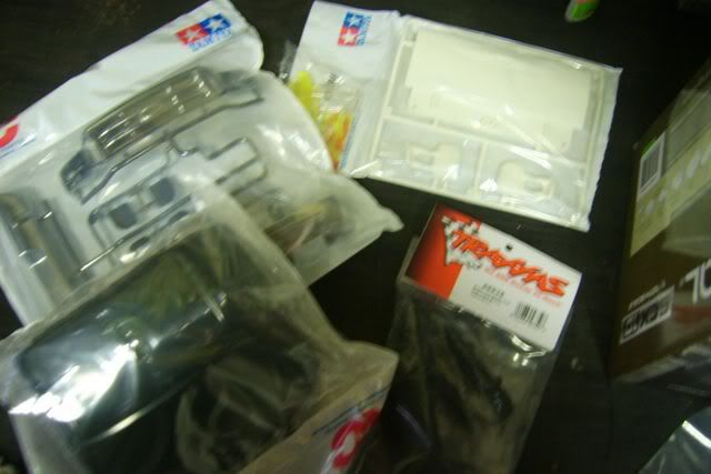

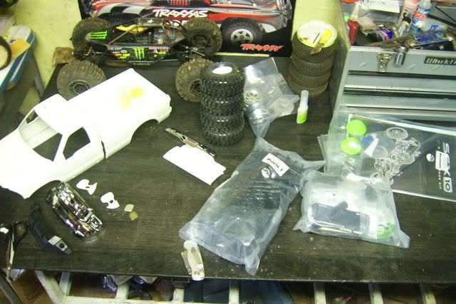

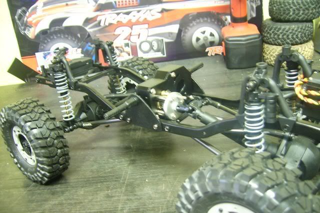

Today I got the SCX Kit
F-350 body, bumpers, lights, tailgat, mirrors, the whole shebang.
Traxxas Summit front bumper
Got some rock rings from 62PYRO
Here are some build pics so far. But you know what they look like.
All new parts.
Rock Rings from 62PYRO
Ready to go.

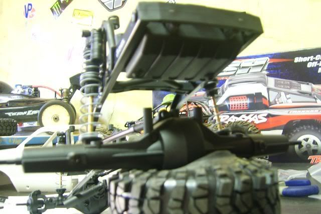

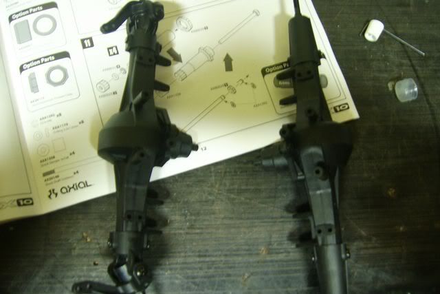

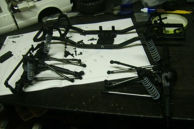

Axles Together

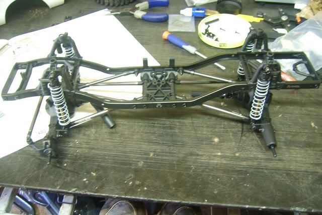

Chassis, Shock, Links all together.
Thats as far as I got tonight. Ill post some more pics as I get some more work done.

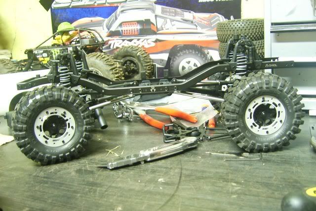

Got some more work done today.

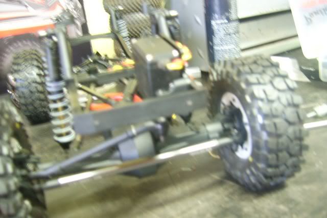

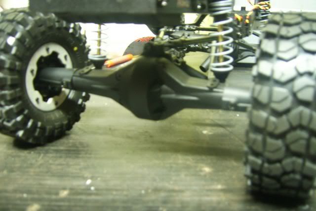

Got axles mounted to chassis.

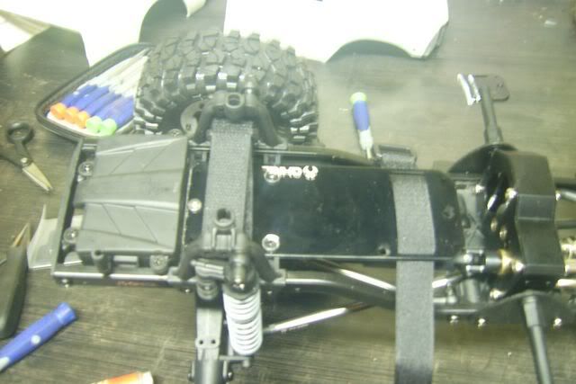

Mounted radio box all the way at the back. Looks kind of like a fuel cell.

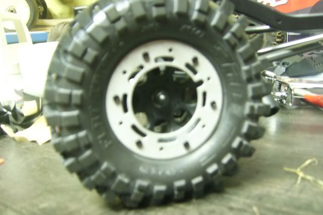

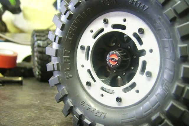

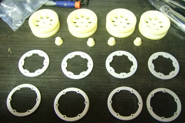

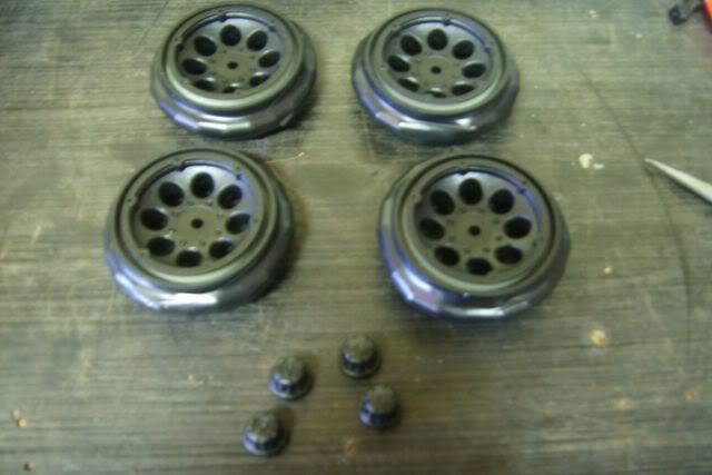

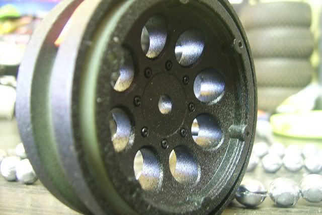

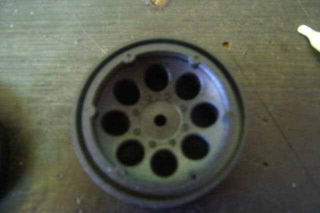

Stripped the chrome off the wheels with easy off and the anodizing off the rings with drano.
Painted the wheels with some Rustoleum textured paint. Looks kind of like a scale spray on bedliner.

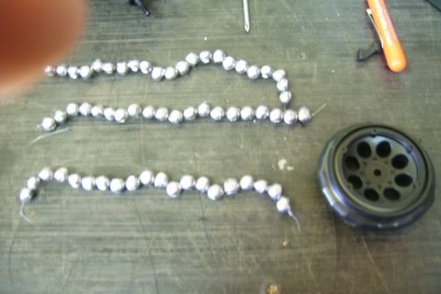

Made some "rope weights" out of some fishing line and weights. They weight about 5oz. a string.
They fit the groove in the wheel perfect.
Wheels mounted up.
Its a roller.
More to come.

Finished the wheels.

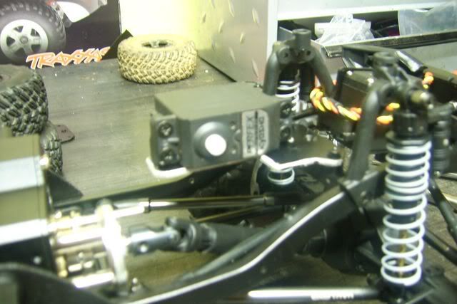

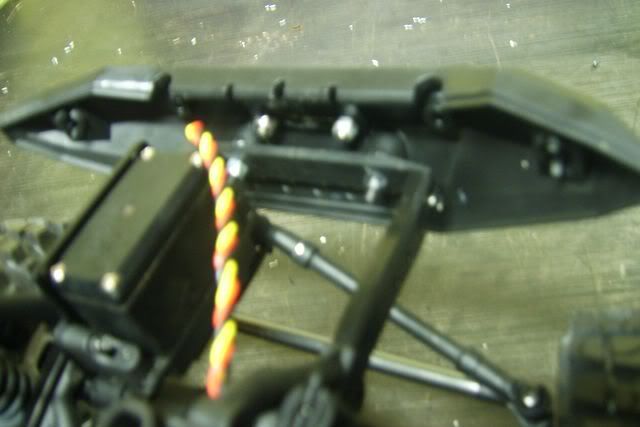

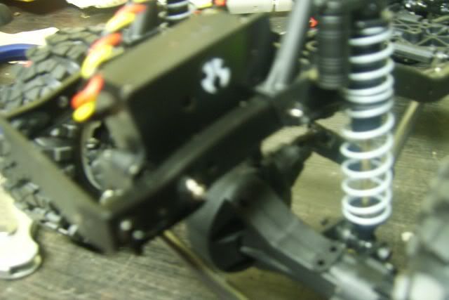

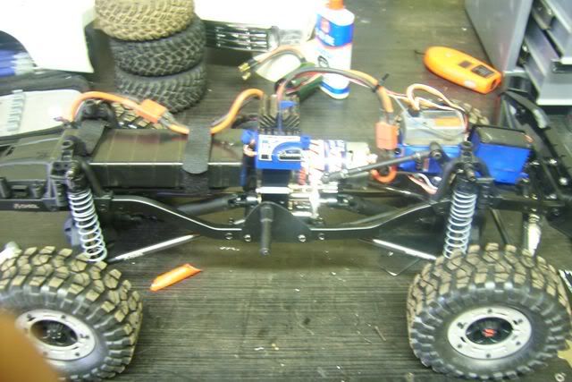

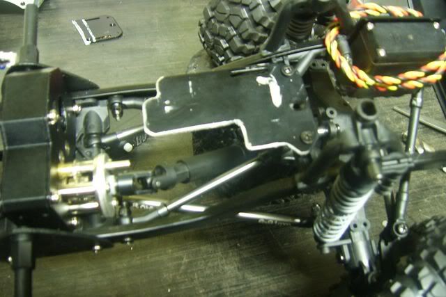

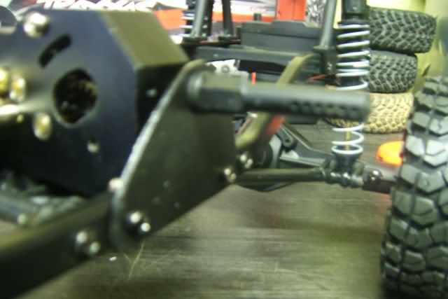

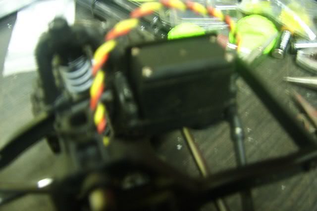

Mounted the servo on the frame.

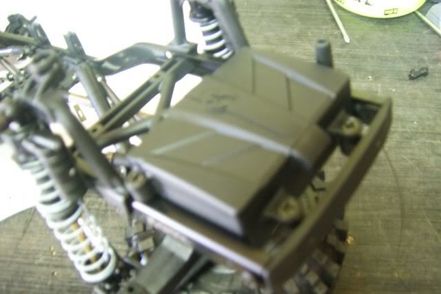

I'd like some more details about the chassis mounted servo and more pics of it if you would please. Thanks
89crxsir is offline   Reply With Quote
Old 06-07-2009, 08:37 PM   #7
Join Date: Feb 2008
Location: Mount Holly
Posts: 224
Quote:
You dont have to drill any hole or anything. Use the stock servo pate and find a little bit longer counter sink screw and 2 nuts. You have to take the 2nd stock crossmember out from the front. One side bolts up through that hole and the other bolts up at the front most hole on the shock tower. Only thing you have to do is trim the crossmemeber at the shock towers a tad where it sits in the c channle frame so the servo plate sit flush to the chassis. just hold the servo plate up and you will figure it out and see what you have to do. Nothing hard to it at all. Here are some pics but they turned out blurry.

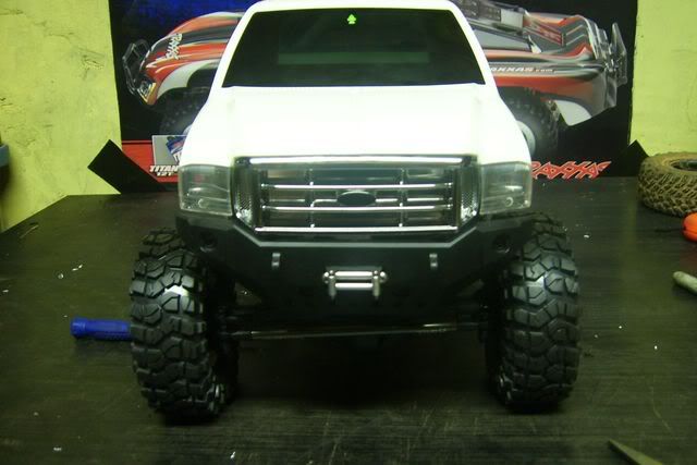

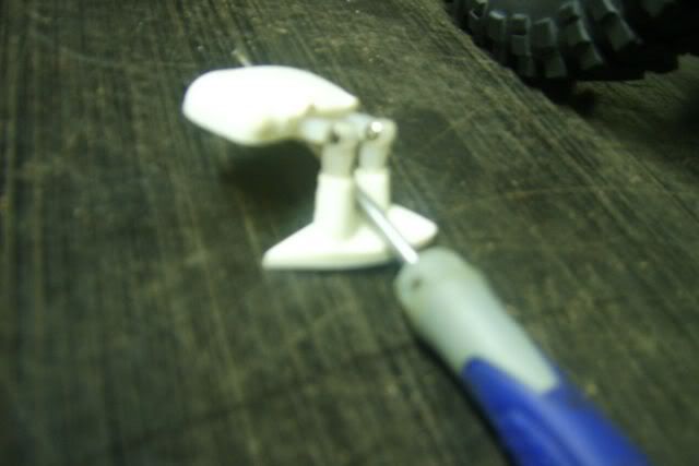

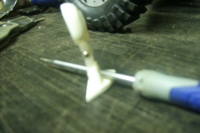

Trimmed the ears off the axles.

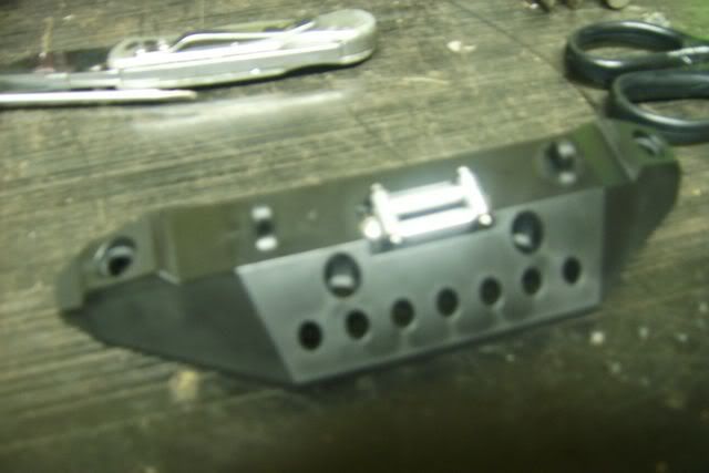

Mounted a fairlead to the bumper.

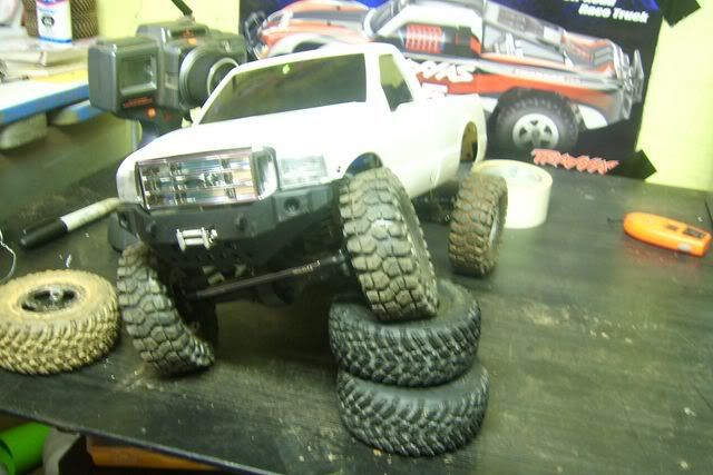

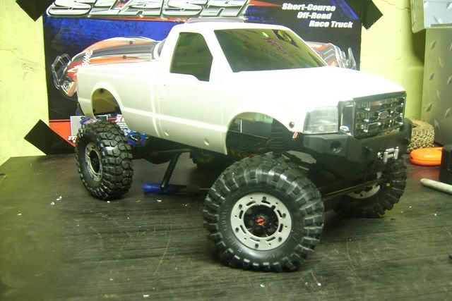

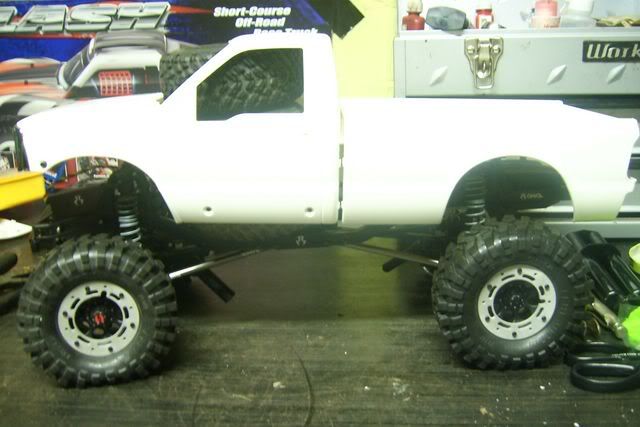

Body sitting on it to get a idea of what it will look like.

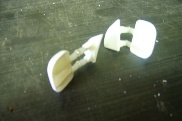

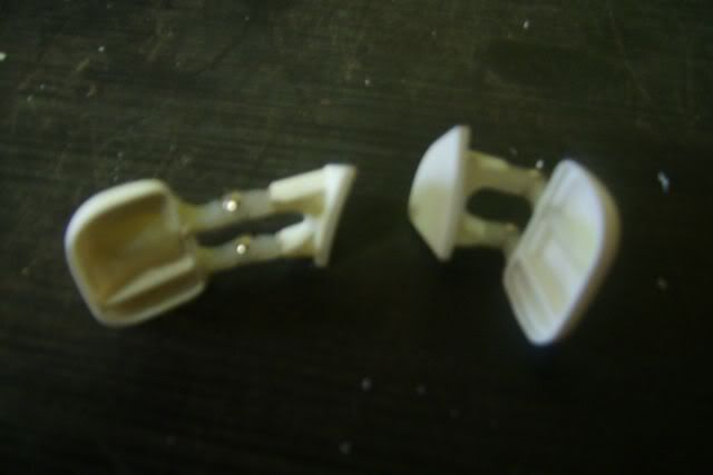

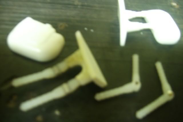

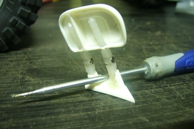

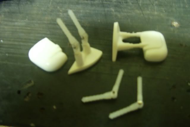

Started on some hinges for the mirrors so they will fold in.

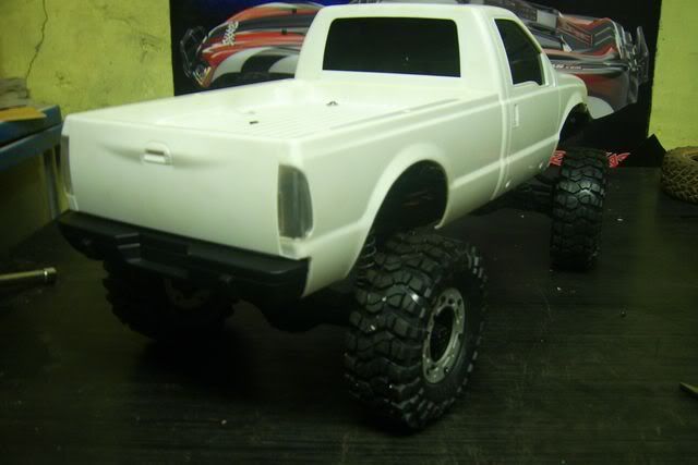

Got some more done tonight.
Got the mirrors all glued up. Just have to smooth out the glue and get them all nice looking and they will be done.

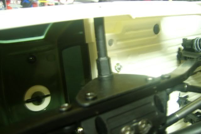

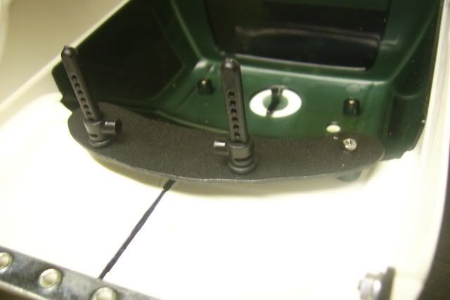

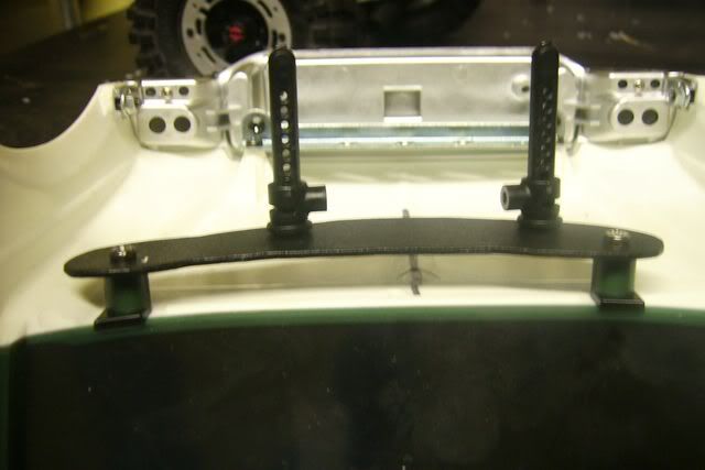

Got all the hardware for the body finally and got it partially mounted.
Only holes I drilled in the body were for the rear posts.

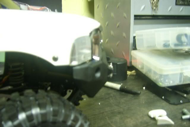

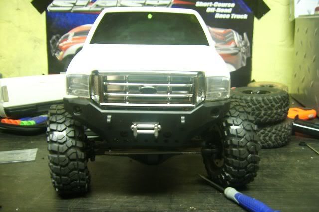

Also got the bumper mocked up. Still have a trim it to fit the grill and line it up a little better.
Side view of bumper.
Body on.

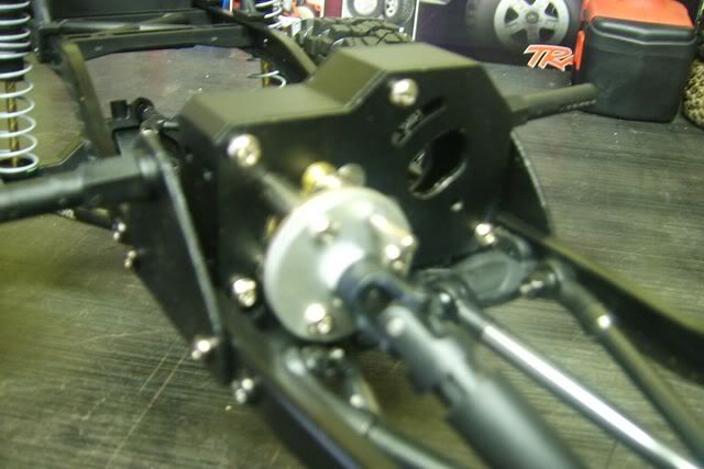

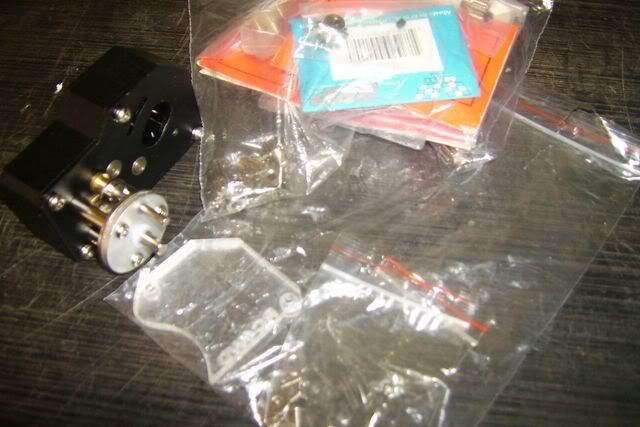

Got the R2D tranny and a lot of pinion from mississippirocs today. Thanks again man.
Mounted.

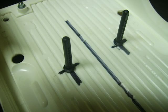

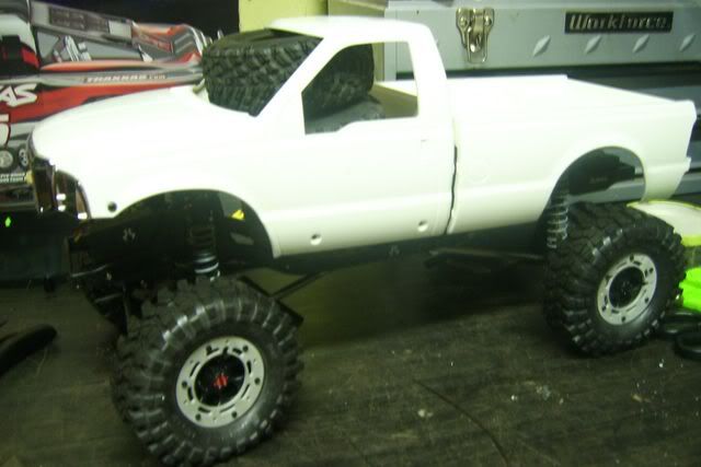

Then finished up mounting the body. The body posts just position it and the s side plates have a screw that hold the body down. Got this idead from gearguy70.
Body attached.
Then started modded the battery tray a little to get it where I wanted it.
Made a servo mount for the dig servo.

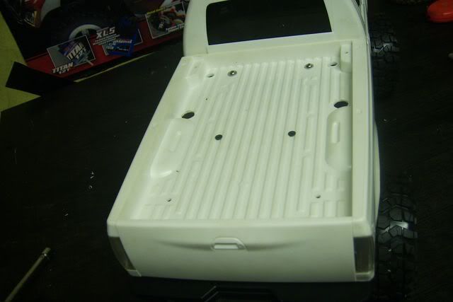

Also started filling unnecessary holes in the body and bed.

I like the fornt bumper. I'm going to order one for my F-350. Where did you get your fairlead ?

Its for a 3 racing winch. Contact 3racing directly and they will sell you a replacement base and fairlead for like 5 or 6 bucks. cant remember exactly how much. Its fits the place in the bumper perfect.

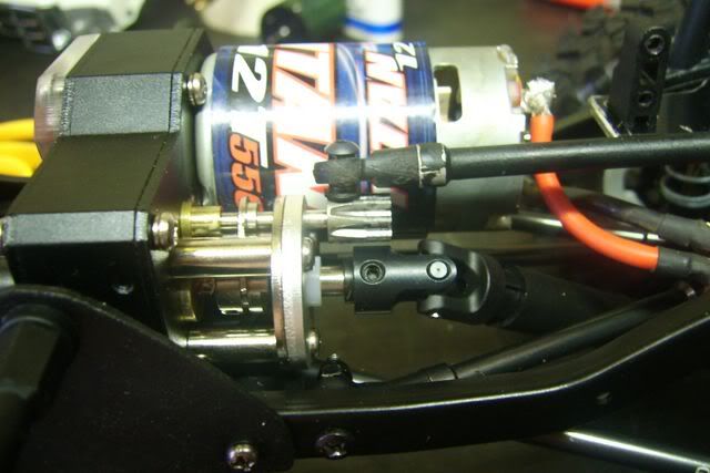

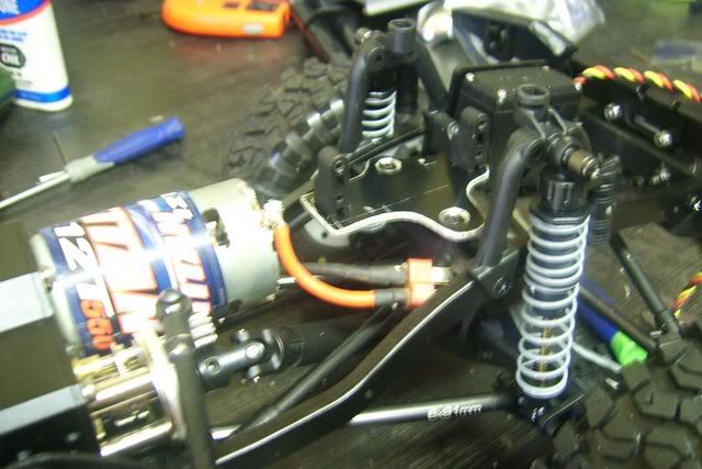

Then I decided I HAD to try it out so I through some Slash electronics on it for now. Tried putting the slash motor on the r2d and the hole in the r2d wasnt big enough. Figure it was time to break out the dremel and go to town. Took it all apart dremeled it out went outside and washed all the shaving out with some soapy water and blew it off with the air hose. Put it all back together and see if it wokred by just hooking a battery straight to the motor and one of the pins for the gears came clean out the side. Got to looking on one of the little brass bushing that holds the pin in fell out. OHHH MAN. That sucks. So I went on a scavenger hunt and after about 3 minutes I smoehow found it laying in the grass beside the garden hose. lol Lucky me.
Had to make another dig servo mount cause I didnt leave room for the motor. oops.
The electronics arnt in the final spot for now. This is jsut for testing. Going to move the esc and receiver later on.
