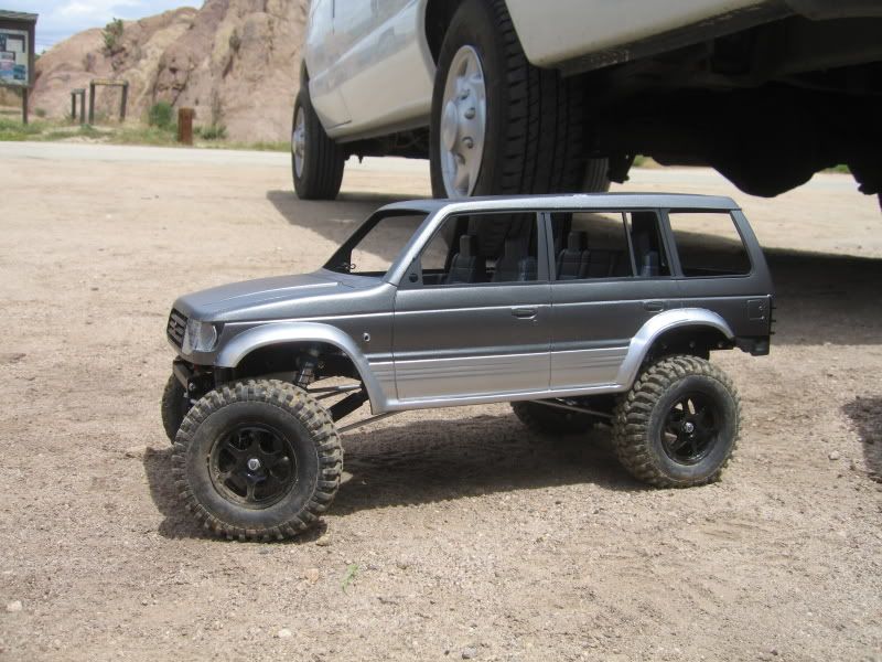

nascarkeith-
thats the exact gunmetal I used on the Montero, also with silver from duplicolor:
