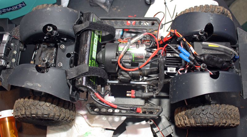

So I added something to my Deadbolt that came with this Castle decal..
It wasn't a Castle ESC, I added a Castle BEC. Couple of times I had brown out even with the stock electronics. I left the BEC at it's factory 5.1volts since I still have the stock Tactic servo.
Since I can not stay out of the water I went ahead and waterproofed it with a generous coating of liquid electrical tape.
And all mounted up.
Here is a shot of the overall layout of my Deadbolt. Things are getting a bit tight toward the rear of the truck with my winch controller, BEC, receiver box, and ESC but luckily there is not much that can be or needs to be added.
I have yet to give it a good field test but around the house everything seems to work well.
Hopefully more to come soon. Thanks for looking.
