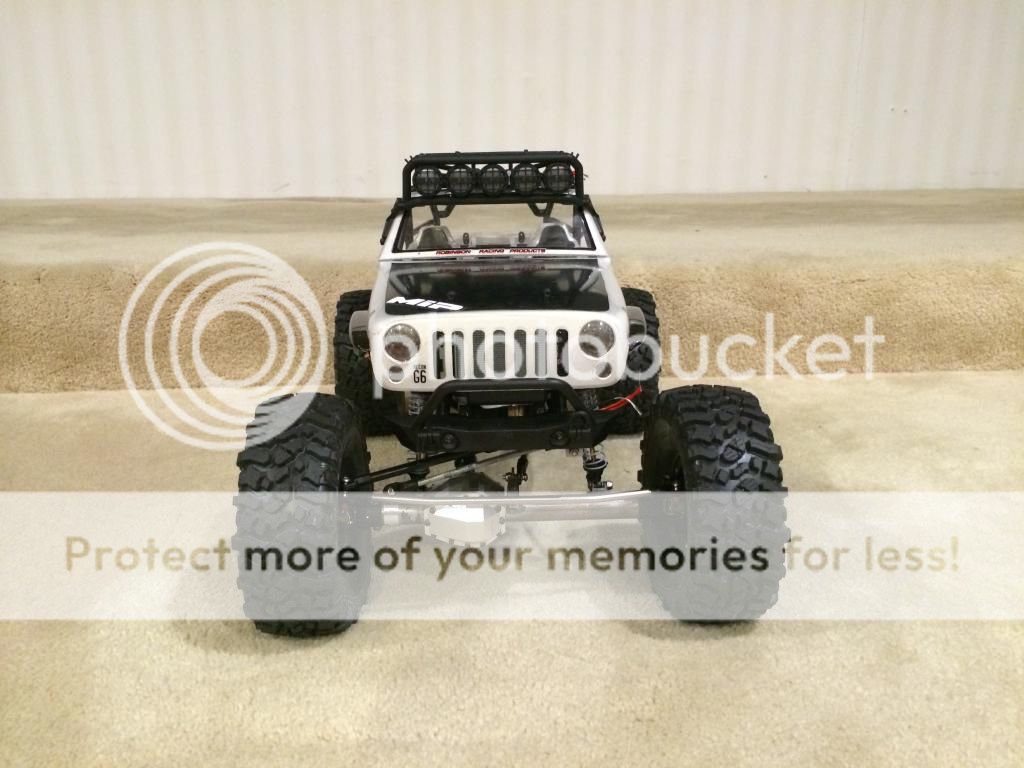

Here is an idea of the difference in size.
svt923 is offline   Reply With Quote

The Wraith axles do look closer to a real axle but they will be much wider than the body. This will give you an idea of what Wraith axles under an Axial Jeep body will look like:
The best option would probably be the SSD D60 axle housings. They are replacements for the SCX10 axle housing and use all the same internal parts, knuckles, chubs, and axles. You can pop off the stock cover and give it a coat of red paint for the ARB look.
SSD D60 Axle Case for SCX10 (1)
