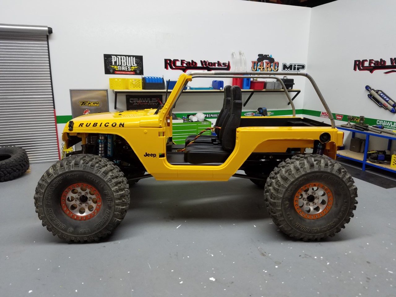

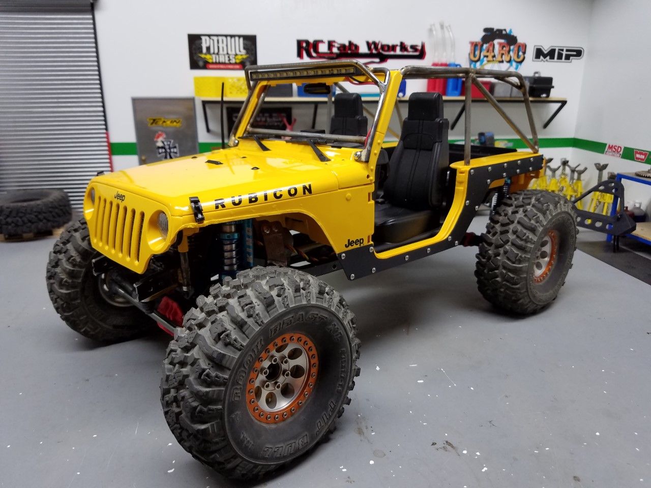

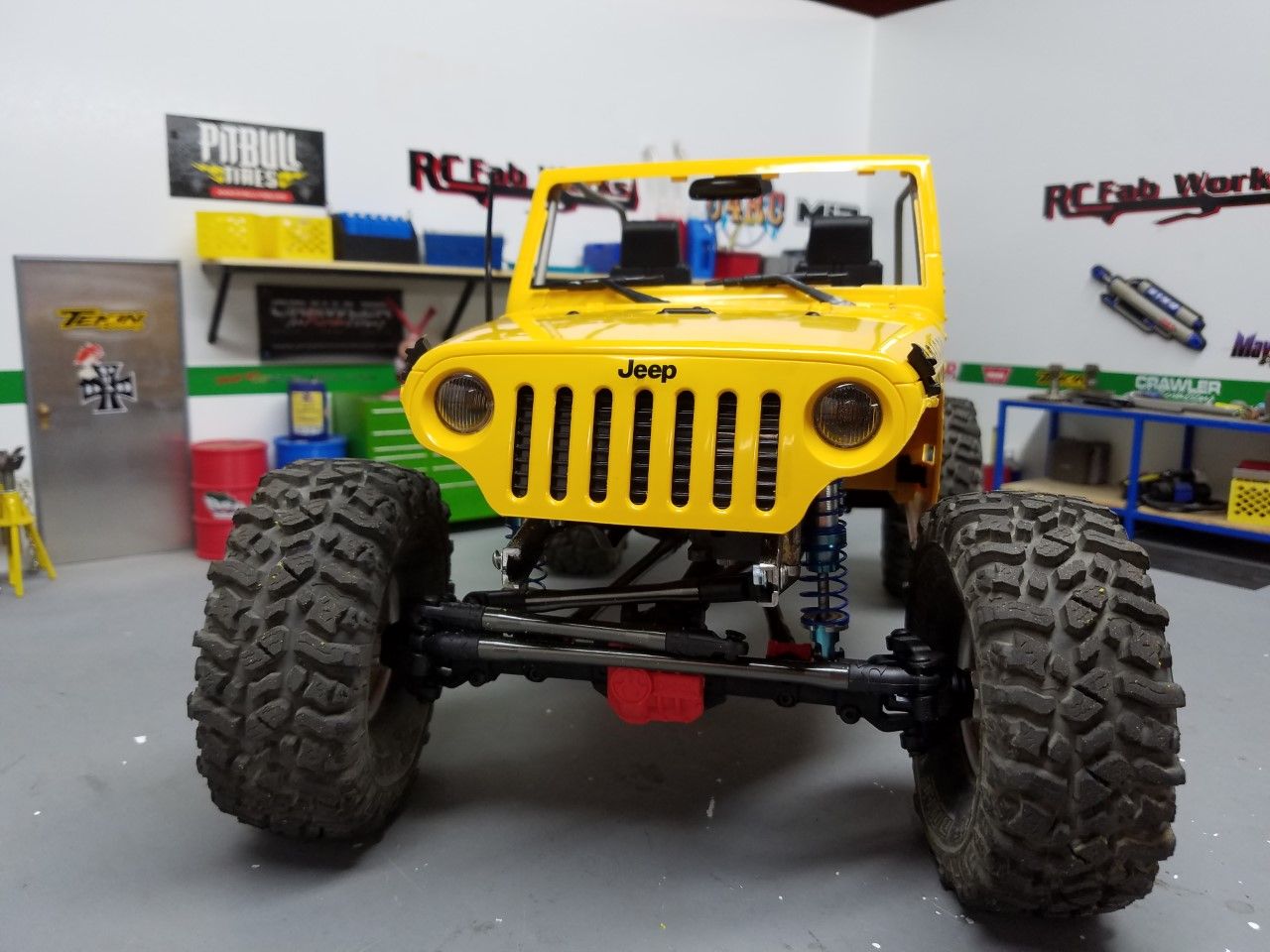

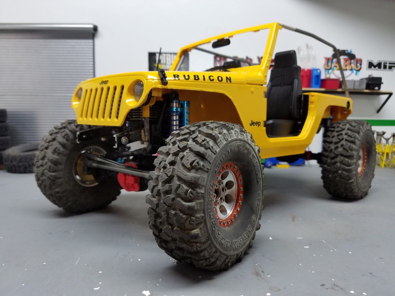

Here's a few pics of the SCX 10.2, I leaving the WB at 12.3 and right now just slow in cutting up the body...till I get a look in my head of what I want. I don't want to go back and add plastic. So the look of the body will change and the rear tail lights might come off, don't know yet. The Pit Bull rock beasts are the new 1.9 XL's

Looks awesome, I need to get myself one of those China JKs to build a replica of my 1:1

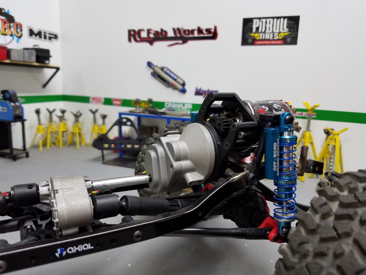

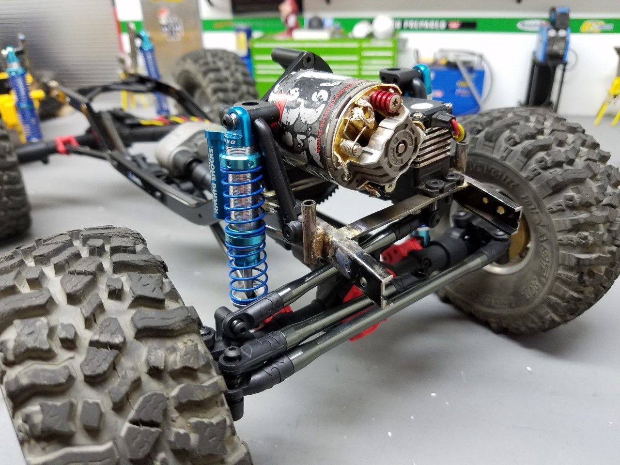

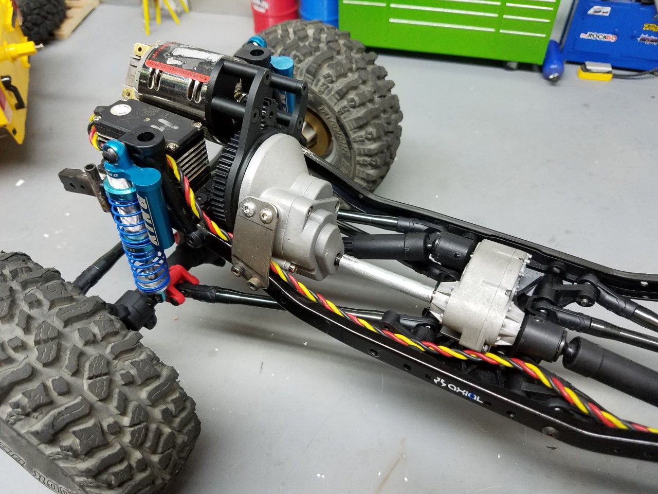

Finally got this R3 Scale Single Speed Transmission to fit this chassis, 3 hr's later and bitching at it...lol.. had to keep flip the transfer case, re-clock the trans and to get the shafts to work right...l...Also had to make sure I could run a brushless motor too

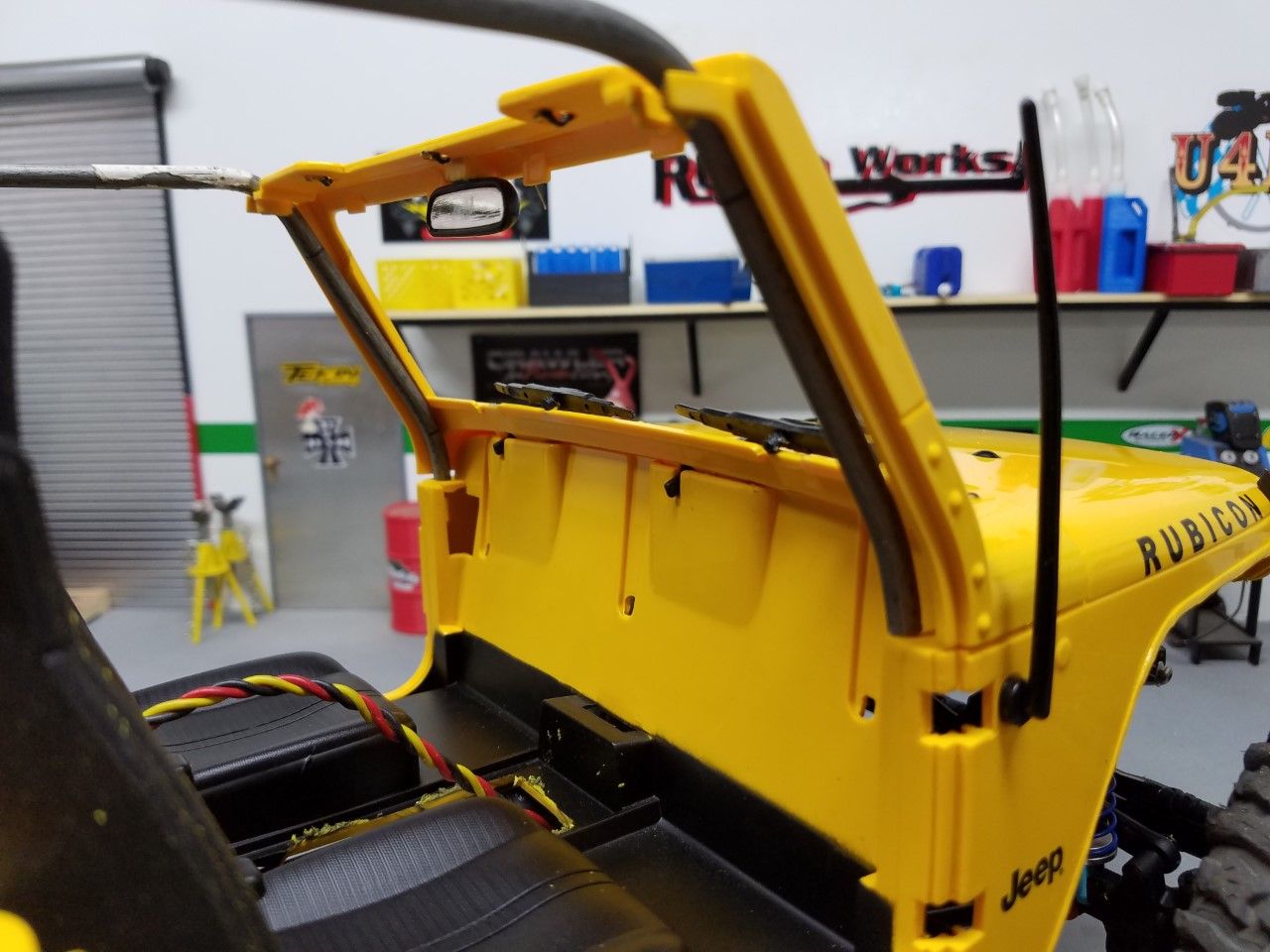

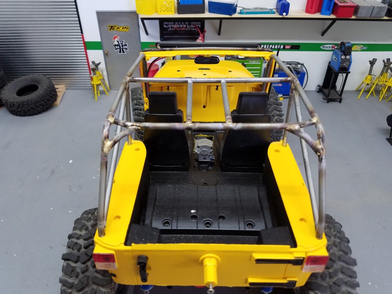

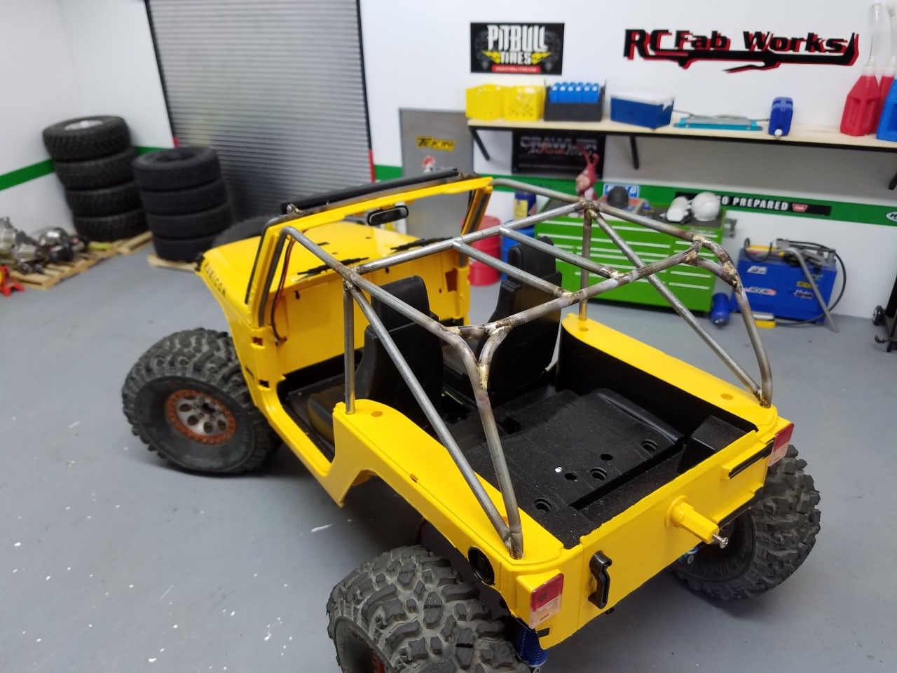

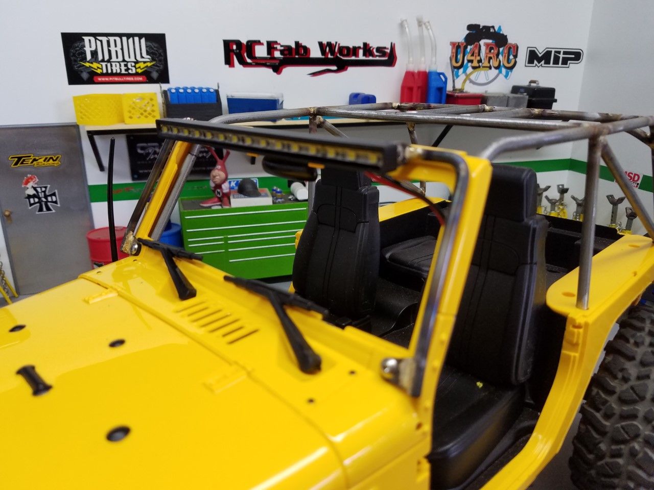

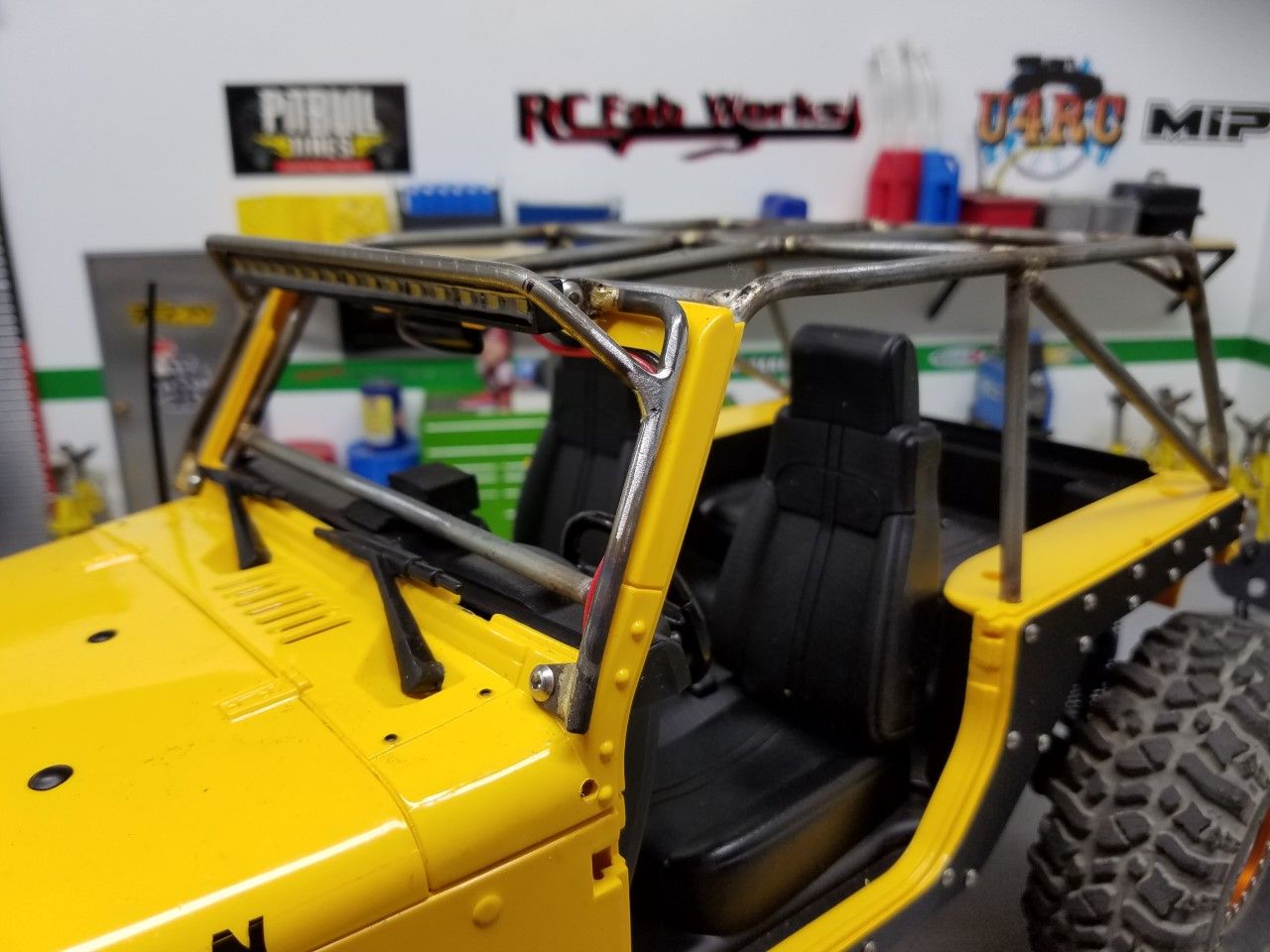

Starting some cage work with a MadDog 5'' light. Did a windshield hoop to try and keep the rocks from taking it out.

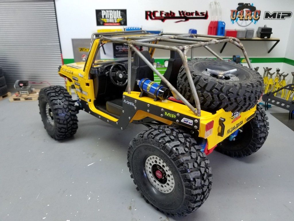

Is it done yet...

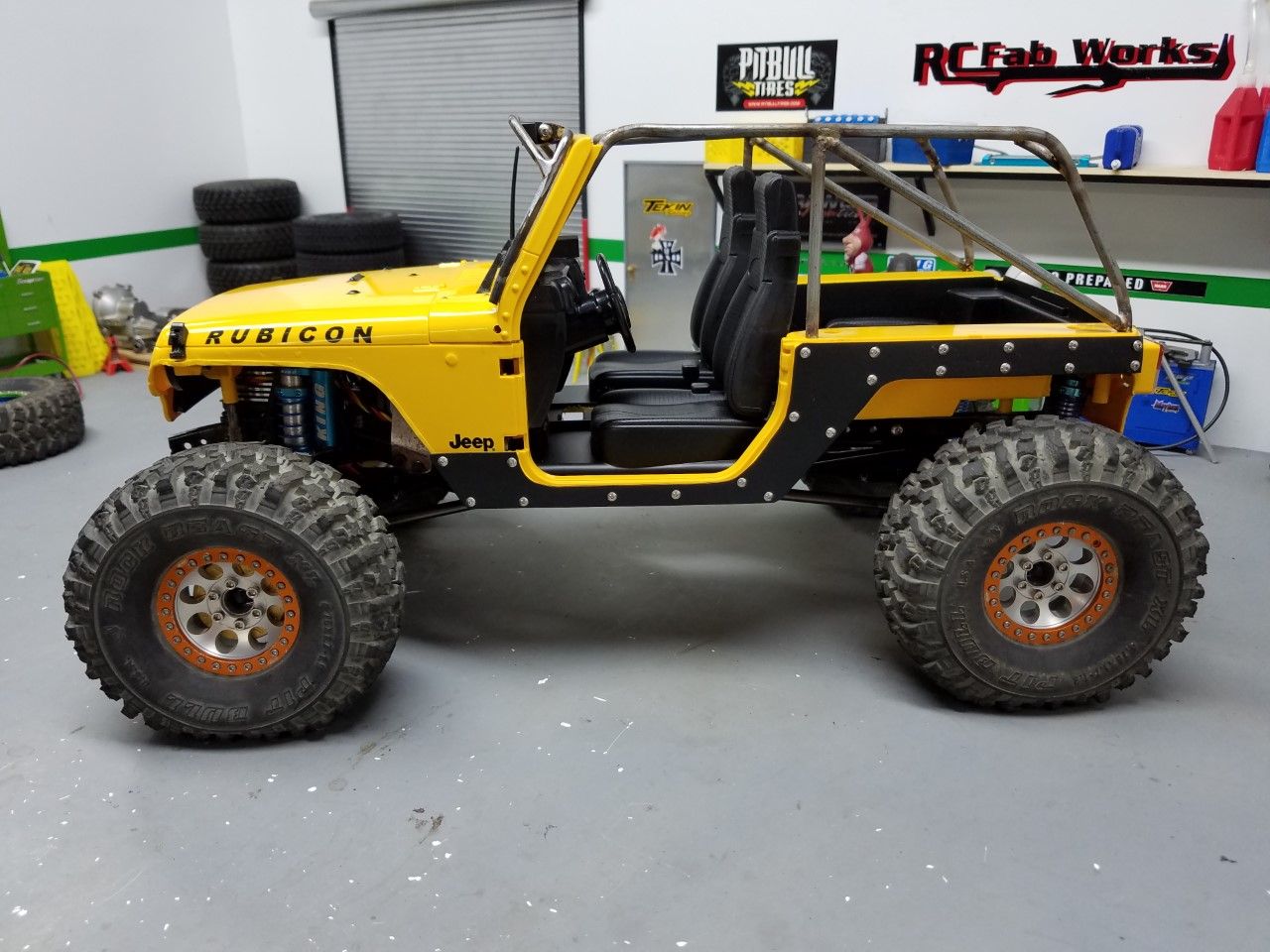

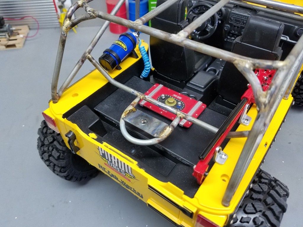

Put a little light guard on and added some more to the cage.
Got my side panels made and on...not to bad
Still not sure about the tail lights
The Doc is offline   Reply With Quote

Looks great that's some good tube work you got there

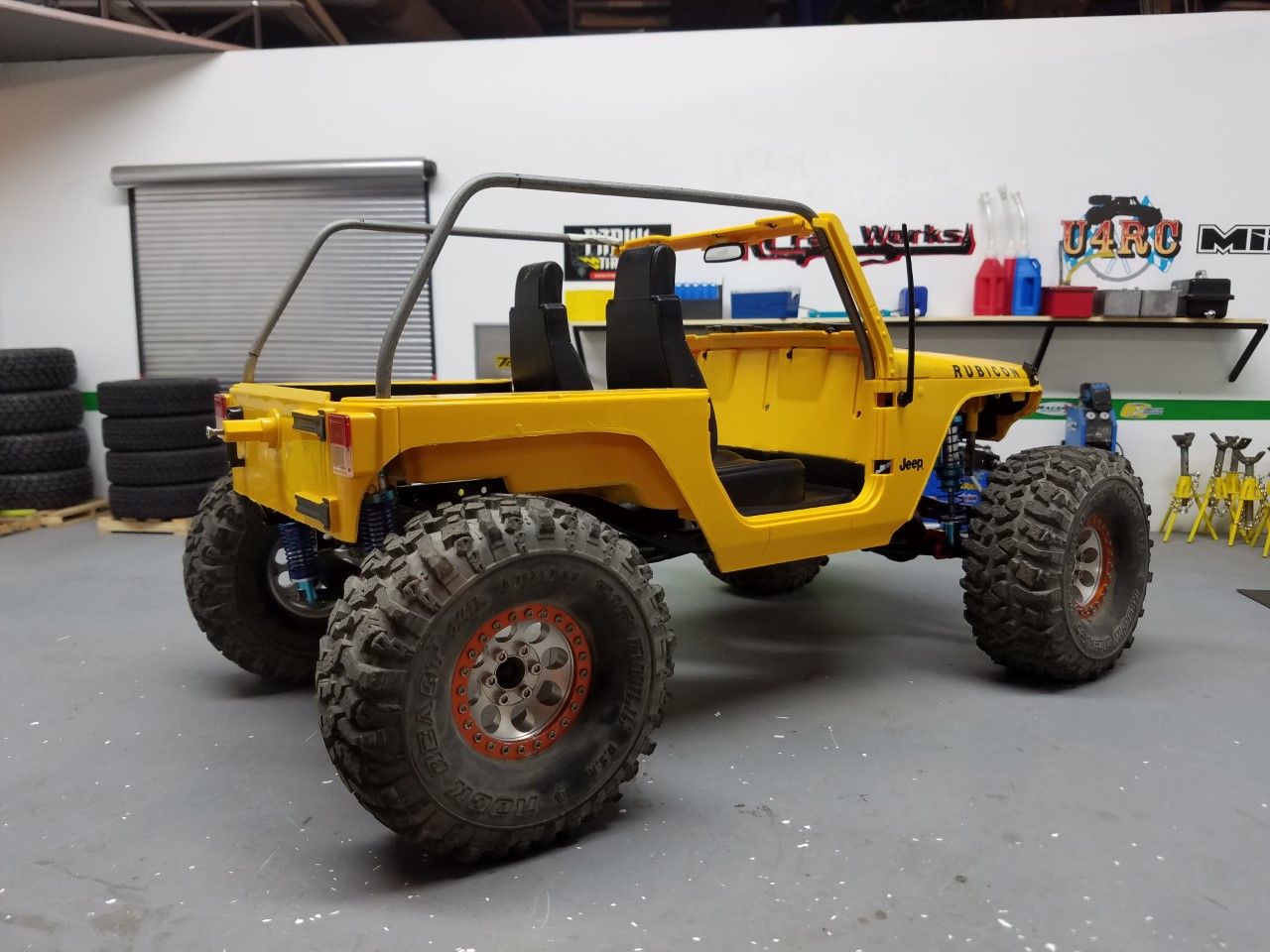

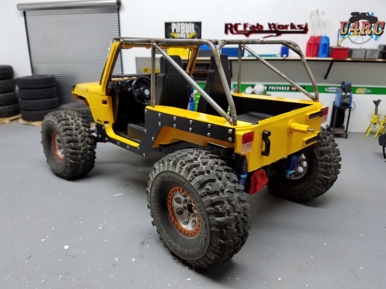

More progress Can't wait to get out and run this thing

nice job. Just remove the windsheild frame.

Gotta keep the windshield frame imo.

Always wondered what a China Jeep would look like on the 12.3 wb. Looks killer

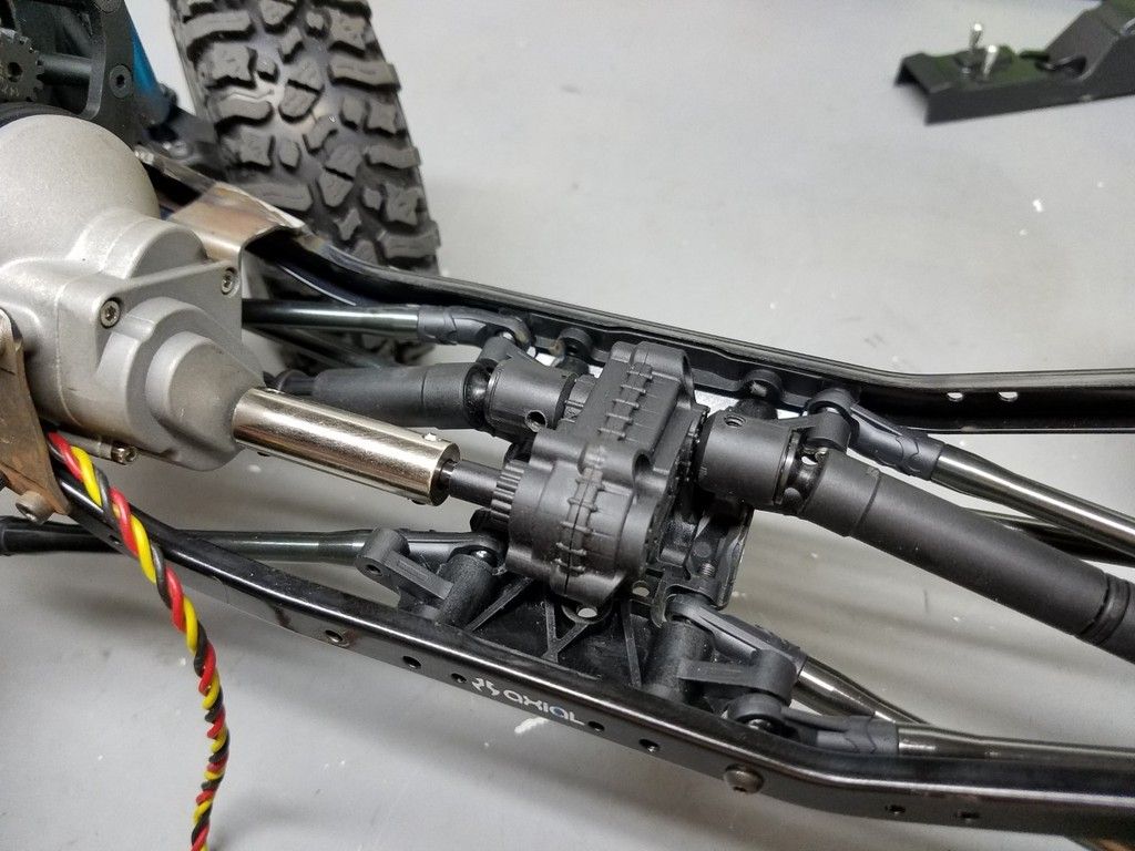

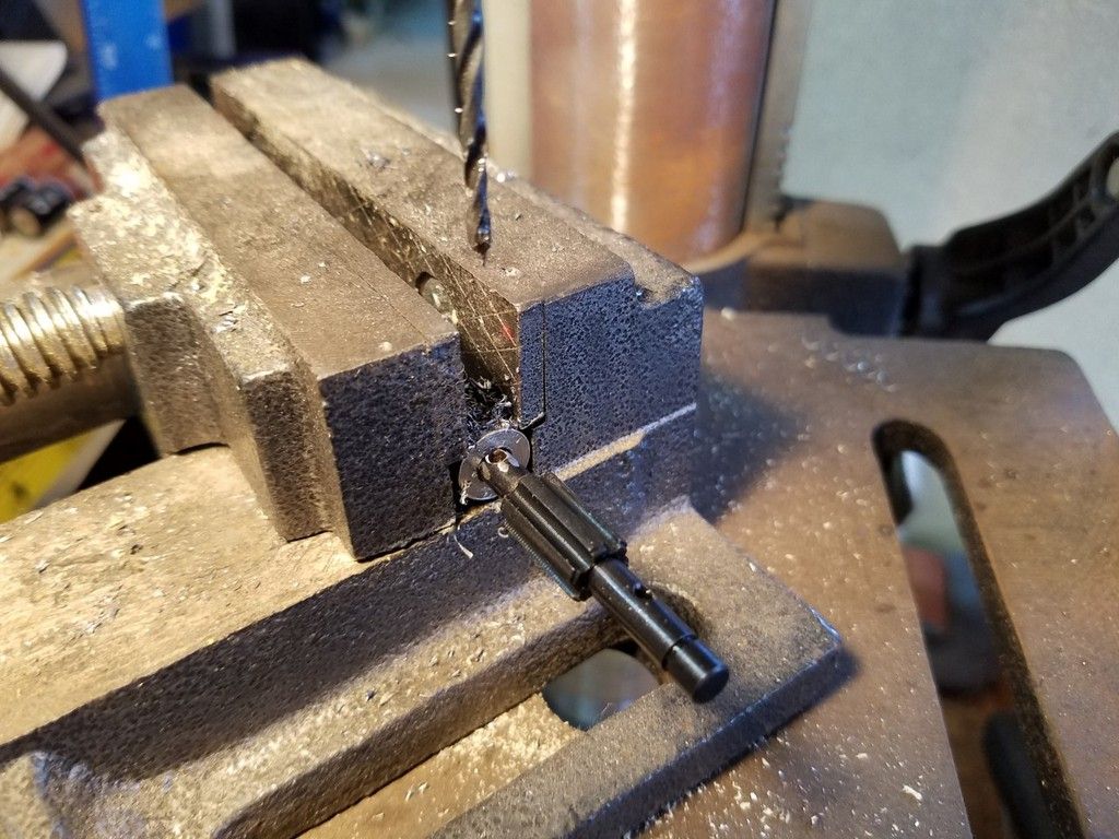

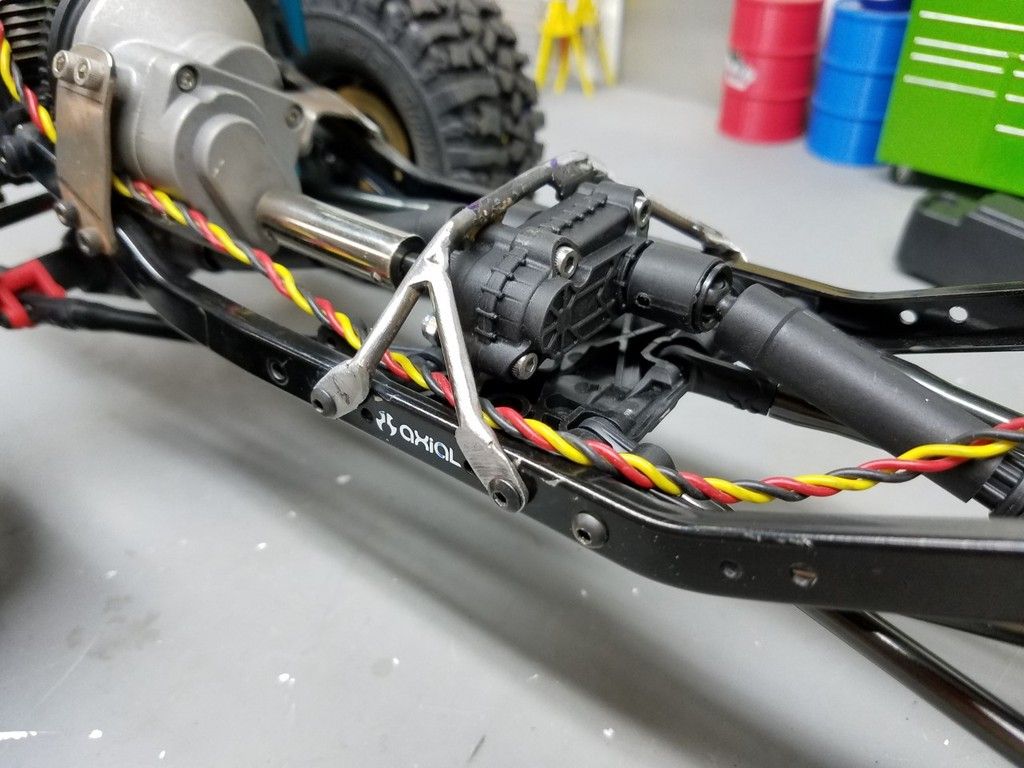

Decided to change the transfer case and go with the stock SCX10.2 one. Redrilled the main shaft for a cross pin and shortened it and it fit right in
