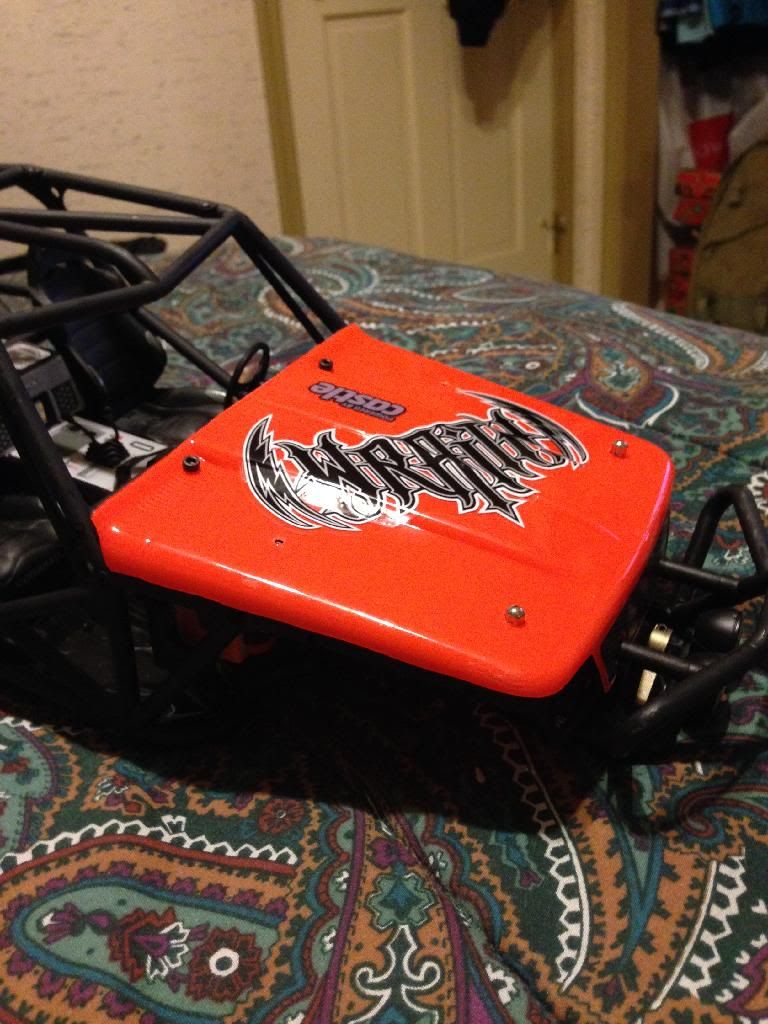

Also cut the bonnet but now need a way to keep it shut. Not a fan of the magnet idea so trying to find some pins that i can get here in the UK
burgerboy78 is offline   Reply With Quote

Traxxas 3727 battery hold down pins in the front holes under the hood.
Like this
Cmarcan167 is offline   Reply With Quote

This is what a lot of people are using trx3727 its a traxxas part fits great and easy to get.
vegas1973 is offline   Reply With Quote

I got the Traxxas parts from Modelsport and used 6mm p-clips for the hinges which I got off ebay, the parts cost well under a tenner

Thanks fellas! That does seem the neatest way to go about it. Just ordered them up

Bonnet pins also. the pins aren't to everyone's liking and are definitely not scale but i like it
