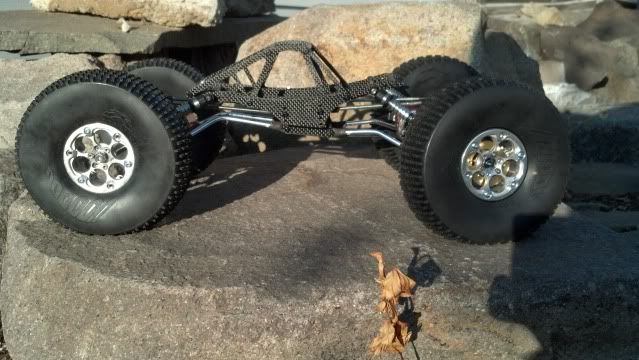

With the SCX icon shocks we decided to limit each one internally with a traxxas aluminum ball end. Stance and flex seem to be perfect.
The DLux modified Axial shafts are a great choice and provide lots of steering. The drive tangs are oversized and don't fit through the RcBros tubes without modification. Instead of boring out the tubes to a larger inner diameter, we decided to grind down the drive tangs .5mm. Which also helped take out some of the wobble.
The RcBros parts all fit PERFECT and are very strong. The aluminum really polished up nicely too! I had to take the truck outside and get some pics of it in the sunshine to really do it justice!
