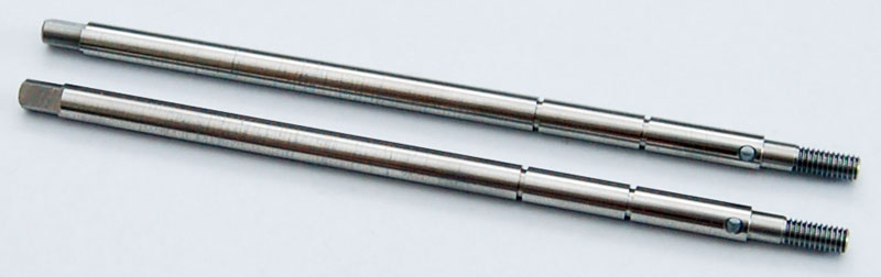

http://rc4wdstore.com/index.php?cPath=63
Extended Punisher Shaft for for HPI Wheely King
SnoopMaxx is offline   Reply With Quote
Old 06-04-2008, 04:25 PM   #12
Join Date: Sep 2007
Location: Denmark
Posts: 887
Steel Straight Axle for HPI Wheely King
Eliminates rear steering and transfer power more efficiently!
The extra material and high strength steel make these axle shafts much stronger than stock! Made for hardcore rock crawler!
  • Made out of 303 Stainless Steel
  • Advanced spline machining technology
  • Designed to work with Straight Axle Adaptor Part # X-0370
Installed on our straight axle housing:
Steel Axle Kit for HPI Wheely King
Tired of keep on breaking the Drive Shaft and have to open up the entire axle just to reinstall a new one?
What's included:
  • 2x Axle Shaft (Left & Right) for Wheely King
  • 2x Drive Shaft for Wheely King
