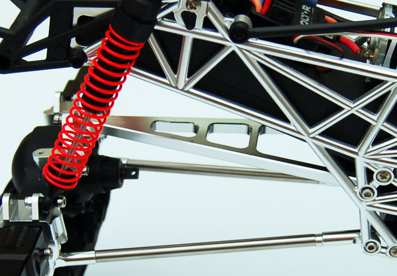

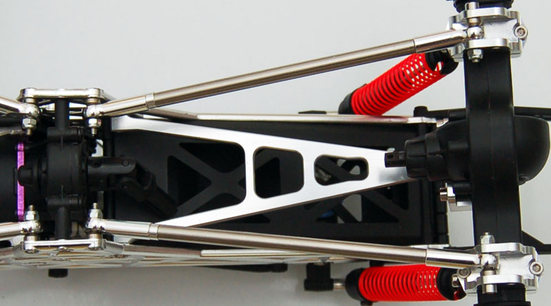

http://www.rcpcrawlers.com/product.p...&cat=18&page=1
http://www.rcpcrawlers.com/product.p...4&cat=0&page=2
so get 4 of the yokes above
and just order one set of the drivelines right
check them out and tellme if this will work
wheely king 69 is offline   Reply With Quote
Old 12-22-2007, 02:23 PM   #12
Join Date: Dec 2007
Location: roanoke,tx
Posts: 153
dam all that aluminum looks killer.how much for all that.i think the extension kit was 45 or so was'nt it?
