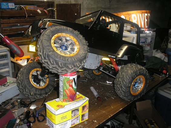

Got a few things done on the big jeep project.
MF axles
Summit trans
proline beadlock 40's with moabs
I will switch to rock locks when I get some more $$$
I'm going to try a 775 motor but it might be a bit too heavy so maybe a 550 or holmes puller motor.
Currently waiting on revo ends to make links. Axles will be 4-linked with the uppers mounted on the diff housing with a peice of aluminum, shock hoops for the front are also in the works. stay tuned for more.
You can see a unfinished shock hoop laying on the table, bent fron 1/4" steel rod.

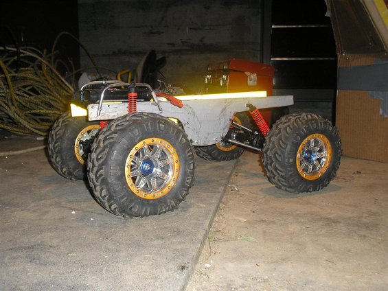

Finally getting over a cold and got some time off to work on this pig.
shock hoops mounted up, upper link mount roughed out, and links mocked up in the front. I need to widen the rear axle then work on upper links for it.
Body is sitting higher then it will when it is all done, I am in the process of looking for wheel wideners or a 40 series rim with more offset to get that full size axles under the jeep, that way it will look better with the 40 series rock loxs.
Thanks for looking.

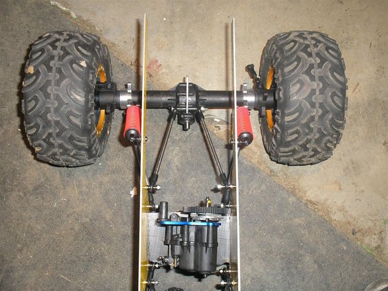

Little more progress
Got the driveshafts on, and created a link for the front steering. Also trimmed the fenders off the body, not sure about the height, I might try to lower the body a bit but I need to get the rock loxs on before I make up my mind.
Crafted some delrin servo mounts for the front axle, just one more set to go for the rear.
Not sure what happened to that last pic but you can still see the mount so whatever.

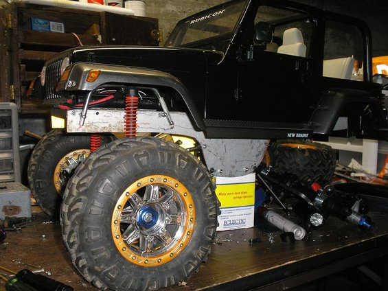

narrowed the axial rims and mounted up the rock locks to see how they fit, I think I'm gunna need a quarter inch or so on each side.

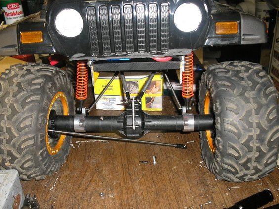

Got the wideners on, I don't wanna go any wider and I can't go any narrower so this is going to have to be it.
