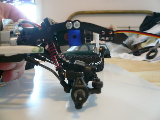

Rear is 4 linked! Finally had some free time and decided to spend it on the micro. The rear is essentially done and will require minor tweaking once the front geometry is figured out.
Some pictures:
Keep in mind the front axle is still parallel to the ground, although there are no upper links which I'm sure will limit the flex slightly.
Full rear droop:
Full passenger side stuff and driver side droop, no rubbing on sliders or frame:
Front: I NEED HELP!!!
With the servo there I am having trouble figuring out how to link it. Any ideas?

Made some more scale accessories. Got some light buckets mounted up, just waiting to install my rectangular LEDs in them. Painted the Gobi. Got the front suspension figured out. Little bit of rubbing still but only on full lock.
