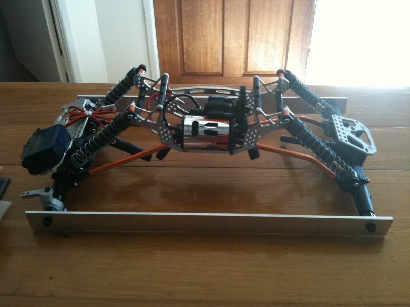

Old 02-24-2011, 04:11 PM   #9
Join Date: Feb 2011
Location: Brisbane, Australia
Posts: 12
Thanks Flizz....
Here is where I'm at, lower links added....sorry for the photo, was done with my phone camera.
I'm assuming the top links will level out the link plates, are they supposed to be parallel with the ground?
Hemi Metal is offline   Reply With Quote
Old 02-24-2011, 10:18 PM   #10
Join Date: Apr 2010
Location: Central FL
Posts: 509
Your link plates will usually be pitched away from the chassis toward the ground. The idea is to keep the drivelines relatively straight between the tranny and the axles.
Overall, rigs lookin pretty good Hemi

Old 02-27-2011, 03:45 PM   #12
Join Date: Feb 2011
Posts: 12
Quote:
Thanks version_three, that's good to know about the link plates. I assume the top links will pull them back slighly but not enough that the shocks hit the front plate.
