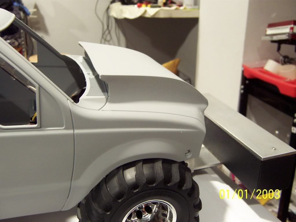

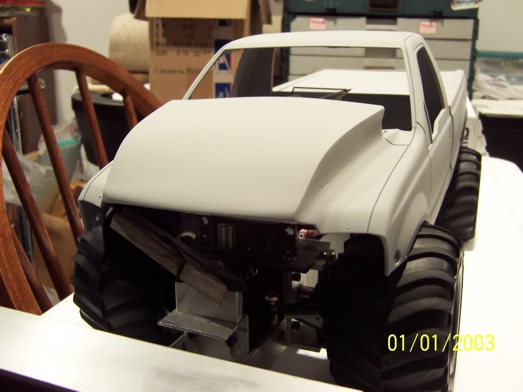

Ok here is how I do it...unfortunately I missed a step or 2, but I thinkt his will help some...
1st my stepfather Jeff (crawlingfireguy) wetsanded the body down as castrol did not want to remove the paint
I then decided what style hood we were going to do, and how much of the hood it would cover and blah blah blah... I then lay the body on its side and traced the hood contour onto paper
Then I tape the paper on to styrene... I usually use .060
I then cut out the bottom where it will sit the hood, then I cut out a very rough idea of how much lift I want it to have
after I decide how much lift I mock it up to the body and make small adjustments to get it to sit as flush as possible, after that Ill usually make that my "template" piece. I then cut to new pieces for each of the sides
then sit it on the body, eye it up and put a drop of ca at each end and his it with activator... now that its held in place, I then use the plasic weld glue to fill all in and get a really good bond
Old 12-04-2006, 09:02 AM   #12
Haters gonna Hate
1BadJeepBruiser's Avatar
Join Date: Mar 2005
Location: In the Basement building Hiluxs and shit
Posts: 7,522
After that I get the 2 sides glued I then make the top, this was a PIA on this body since the scoop contoured outward, Jeff actually held the body upside down and I traced it onto the styrene then began cutting...it took a while to get right but it then started to come together
In the process of making the hood, we decided a visor would be cool, so we started on making one of those as well
Now I know I missed a few inbetween steps, but after ALOT of filling, sanding, filling sanding, we finally got a coat of primer on it to see what is left to do...its coming along nicely
Now this is just a basic cowl hood, we went with a large cowl because this truck is a pulling truck and we wanted it to have the feeling of it having a HUGE engine under the hood, its also going to have huge straight stacks coming out of the bed
The possibilities are endless, it just take time and a little imagination.
Hope this helps a few
