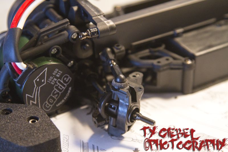

Finally picked one up.
I started assembling it earlier today.
First thing I noticed is the four nylon gears that go into the sealed diffs.
I put 5K in the front diff and 3K in the rear diff.
Everything is plastic, but seems really stout.
There was one gear that worried me a little, it sits on one of the shafts on a hexagon section, it seemed to have a little play, but in the end its probably not as bad as I think.
One thing I am really impressed with is the thickness of the motor plate and the bracing on the transmission.
Front gear box assembled.
Front gear box completely assembled with a Castle Creations 4 pole 5700 motor.
I will get more photos of the progress tomorrow.

So this is how this rig was sitting this morning when I went out to the shop.
With the differentials in everything else went together pretty quickly.
The Savox 1251MG low profile servo leaves a lot of room in the chassis.
I trimmed part of the battery cover to clear the wires.
Bottom loading battery.
The XV-01 is reasonably sealed up. I can see a few places where dirt will get in, but for a factory job it is pretty good.
I built the shocks with 45 weight oil in the front, 30 weight oil in the rear and the longer rod ends on the shaft. The belly clearance is about 1" and the car is a little springy. Tomorrow I am going to start playing with the suspension, get the belly clearance down to 3/4" and go from there.
I did take this for a little tarmac test drive today. It is pretty fantastic, basically I was really impressed and this is the best driving 10th scale rally car I have ever driven. I have a little bit of tuning to do, like addressing the understeer and springy suspension, but overall it is incredibly smooth and stable.

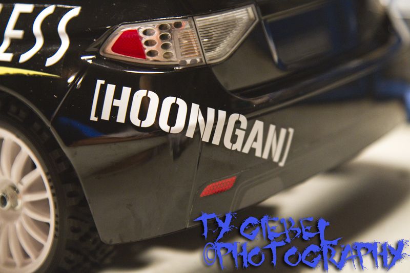

Played with the suspension today, put the shorter rod ends on and went to a 70 weight oil front, 50 weight oil rear with the 3 hole pistons. I think it is still too springy. After a test session tomorrow I will figure out if it needs the one hole or two hole piston.
I did get the belly down to 3/4" rear and 5/8" front. The front has quiet a bit of weight on it causing the front to droop down a little I am still planning to switch out the shocks, but need to get some drive time on it so I know exactly what I am needing.
I also worked on painting the body today, I almost went with the stock paint then decided I needed a new paint scheme for the 2013 CRC series and this body was the perfect one to play with some ideas.
And yes I just happened to have extra functional tail light and head light buckets sitting around.
I still have a few more decals to put on, but the body is pretty close. Tomorrow I should be getting some dirt action photos.
