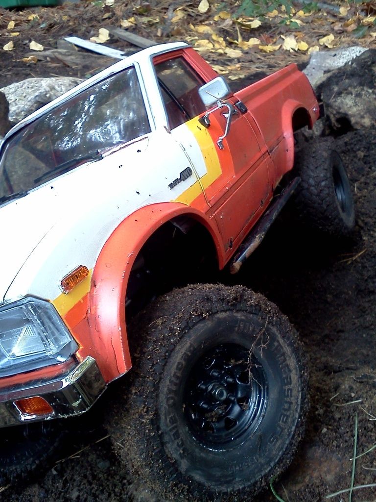

Out in the yard for a few minutes today...
Like all of my builds, I run them and flop them and roll them and have fun with them...

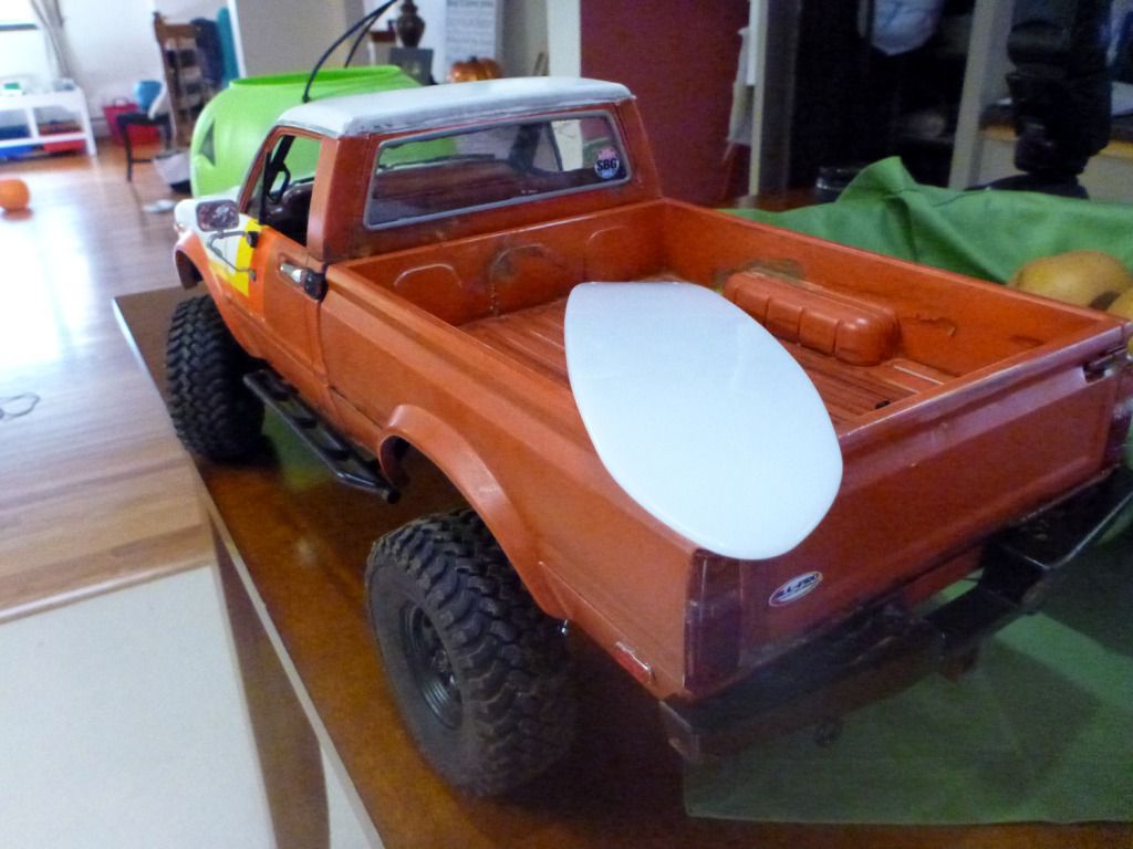

Better pic of the cage.
Nice longboard from Tamiya's scratch and Dent bin...not a bad shape, but need a nose that is a bit more blunt for me...have to fix that. It's a 10.75" board so I can take some length out of the nose and reshape.
