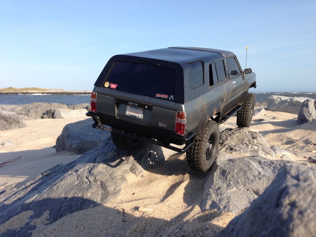

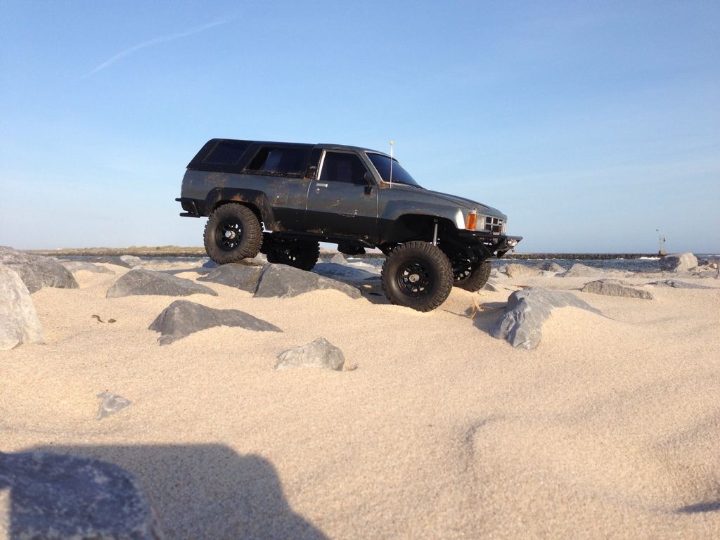

So I really wanted another tf2 but I just couldn't afford the price of a complete kit. I have had an idea for an existing build to convert it over to a tf2 so I hit eBay and found the parts I needed to get it up and running for roughly half the cost of a new kit. I started with a complete chassis, ultimate yota axles with steering and the rest I borrowed from the scx10. I drilled the tf2 cross member for the axial Trans and used some fasteddy spacers. In order to make the electronics tray work I had to move it backwards, re-drill the mounting holes, space it slightly and give it a tweak to clear the drive shaft. I also mounted the steering to the drivers side so the linkage is set up correctly. My only complaint with the tf2 is the rear shackle set up. If you want to run a soft suspension the shackles have to much angle and will collapse. I fixed this on my clone style tf2 by adding rear bruiser suspension. My last truck has had good results so this one saw the the same mod in the rear.
The wheels and tires are from SDI, they are a non bead lock plastic wheels with the best off set I have ever seen for keeping the track width nice and narrow. However, this was an issue with the steering. My solution was to kick it old school and I narrowed the back side of the rims which pulled the tires in nicely and allowed for the clearance needed for the steering. Being short on cash I couldn't afford the nice RC4WD shocks so for now it has some home front shocks from recycled TLT parts and some turned down TLT shocks in the back.
You guys know the body, it's none other then the OG 4Runner built by Rich AKA Pardonmyn00b. The body fits the TF2 perfectly and the truck looks so much more realistic with the yota axles under it and the leaf spring suspension. The bumpers and sliders that come on the tf2 were similar to the ones that Rich originally built. I trimmed the ends of the front bumper slightly, added a Juggsterr winch and control box with power wires, and trimmed the sliders to match up with the body
This body was no shelf queen so it has it's fair share of battle marks, I went through and added some rust where the trucks are known to rot...owning a 1:1 sas 86 runner myself I know of this all to well...
The fresh leafs still need a chino tapper added and some 12 gauge wire insulation to get rid of the shoulder bolts but it's already tucking the rear tires pretty good. When money permits, I'll pick up the correct shocks, 2 speed, and tcase as I already miss the gear shifting factor when compared to driving my other tf2.
I got a couple more pics coming, stay tuned.

Now that's a scaler, you could show 95% of the world those pics and they wouldn't know it was an RC.

Quote:
Thanks Jason, Rich did an amazing job on this body. It was worthy of a scaler platform. Don't get me wrong, it looked good on the scx10 but the axial axles gave it away. I feel that if I spent some time weathering the frame and with the right camera work it would be really hard to tell.
Forgot to mention I also installed some of Rich's inner fender wells and radiator support kit
