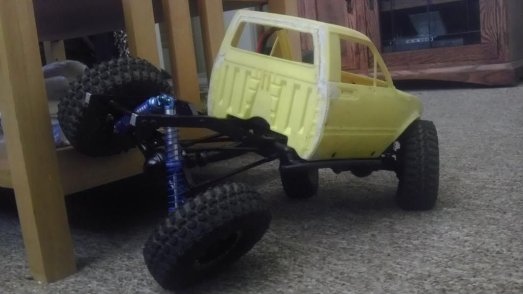

3link and 4link. 90mm King Shocks up front and 110mm King Shocks in the rear.

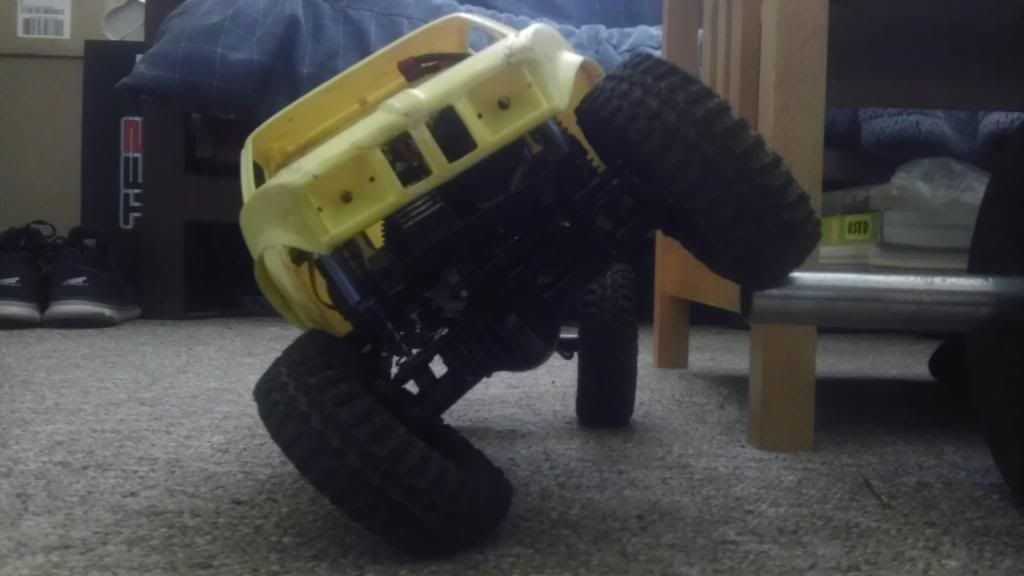

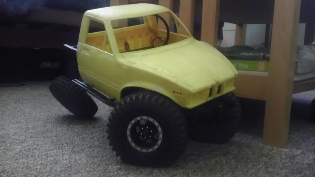

TF2 - stock front leafs and shocks, 4-link rear with 110mm dual spring shocks.
