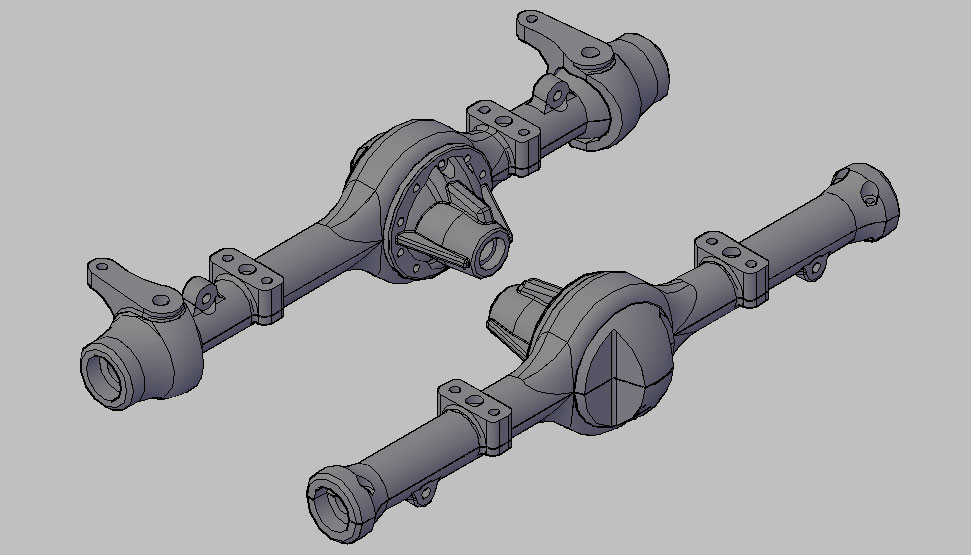

Click the image to open in full size. Click the image to open in full size. Click the image to open in full size. Click the image to open in full size. Click the image to open in full size. Click the image to open in full size. We have converted Fracture's design into a format that we can use for manufacturing. We hope to get some protype out within 2-3 weeks...

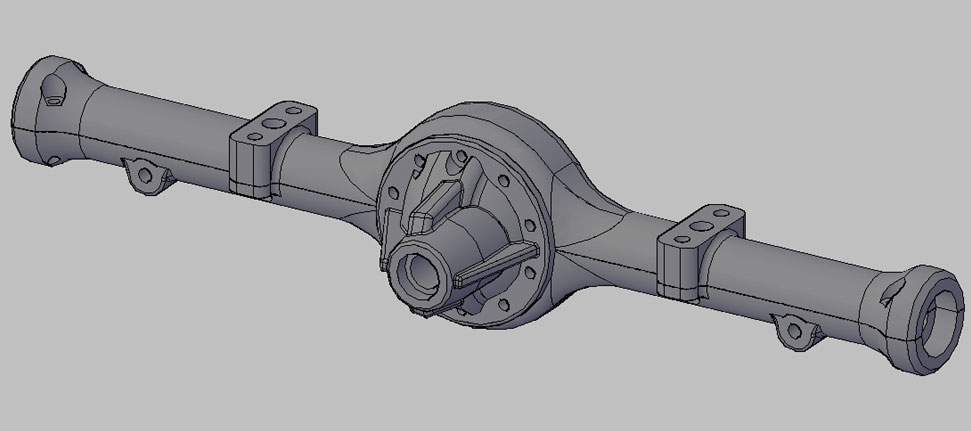

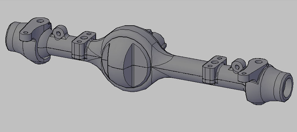

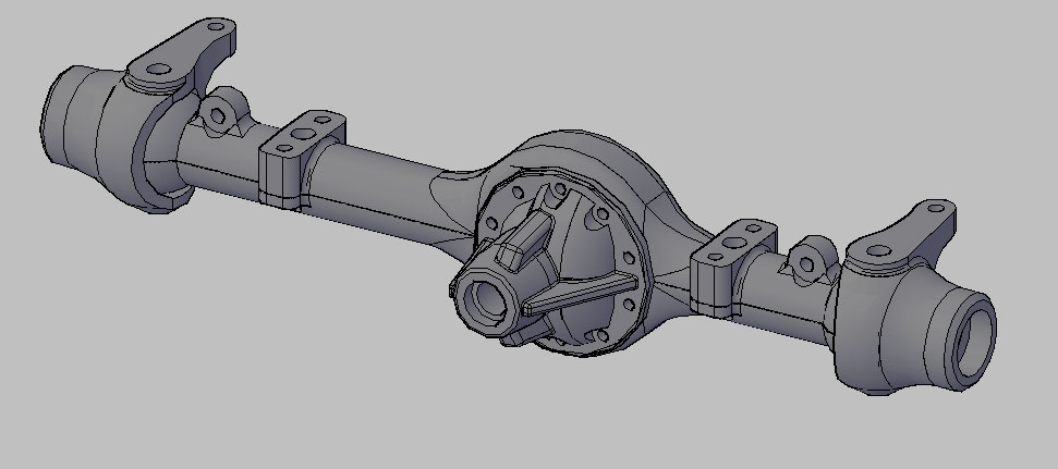

Are the ring gears on the right side on both front and rear end? These will be a little harder to fix than the T60's.
In this pic they look like they're both on the right side and the truck split in two or collapse together No what I mean?
Also noticeable in the first pic.
Thundermaxx is offline   Reply With Quote
Just noticed that.
RC4WD, please make note and recheck this.
Thundermaxx makes a good observation. Hopefully this will be resolved before they go into production.
chino63 is offline   Reply With Quote

Web Wheeling
Etype R's Avatar
Join Date: Jan 2005
Location: Twin Cities
Posts: 2,837
Default
Good catch... One of them is backwards, make sure the pinion is on the same side of the ring gear as a TLT axle.
Etype R is offline   Reply With Quote
Yeah my bad
I realised that while mocking the design up on a vehicle, I told rc4wd to check that and mirror the rear if needed, it definitely is needed isnt it
I assume they wouldnt let something like that happen again anyway...
Final bearing width is same as before, I cant remember what is is, exactly same as tlt I think.. does 6.6" sound right or is that something else?
I havent figured out how to mount the upper links yet, they will need some sort of strut/beam/plate, the lower links and shocks can just bolt onto the axles with tlt shock mount type things.
tlt mount spacing, I think that means front will be direct fit on bruiser, of course the u-bolts can always be slid further apart on the rear axle, it just wont be held quite as securely.
