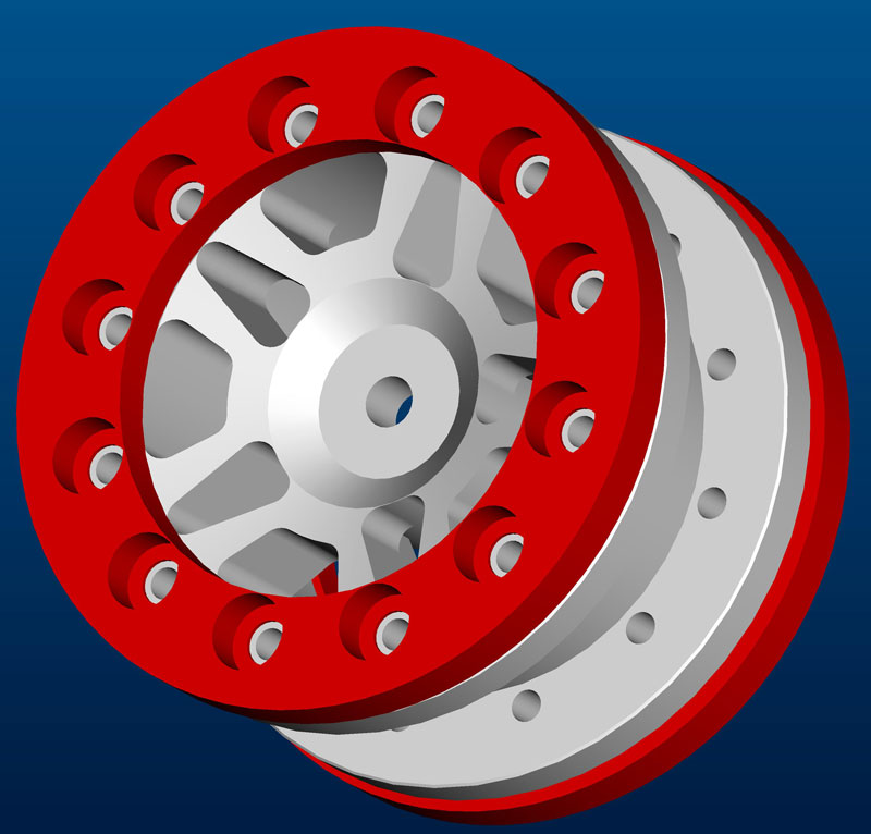

please let us know what you think and what color the factory pre-installed ring you guys want

How about less screws? Ya shouldn't need to many screws to hold the bead.

YES, YES, YES!!!
x2 on less bolts though... I think 8-10 per side should work fine.

People, the whole point of these custom beadlock wheels is to look scale! Have you ever seen a 1:1 beadlock of this style (not hummer style) with 8 bolts? No. The extra bolts make it look 10x better and not just any other gay rc wheel. I'm really digging the design, maybe include a gunmetal color anodized ring?

Ok - if they were to make it scale then, it would only have 15-18 bolts... total(on one side), not 24. The Hutchinson Rock Monster's have bolts on one side that hold the whole thing together. But 24 bolts on a wheel that small is a little exessive though, unless they are really small bolts.

I think smaller hardware would look better but then you will run into issues with stripped threads or broken fasteners. M3 hardware definately has the durability to be repeatedly installed/removed but the smaller stuff in my opinion doesn't. I have run into a few issues with M2.5 and definately many more issues with M2 hardware failing due to repeated useage of the same hardware. An M2 tap is quite hard to come by and can be up to four times more costly than an M3 tap (depending on where you get it). Not to mention the rediculous cost of a set of M2 or M2.5 Helicoils if you ever strip the threads in the wheel. Ever try to get out an M2 fastener that you broke the head off of? There are sacrifices for durability over appearance and I personally am happy with the M3 hardware.
However, if you decide to go with smaller hardware, I'd still be interested as I have access to all the tools related to repairing broken or stripped M2 and M2.5 issues.

These look pretty nice but is there any way to "soften up the edges" on the spokes? To me most beadlocks look kinda raw and unfinished (not just these but other manufacturers as well). Maybe a small chamfer to the spoke edges?

i woiuld like to see gunmetal wheel and silver ring. gunmetal has never been done before, black hides all the fancy machine work. gunmetal is dark enough to still be bad ass and anti bling, but still shows off the good looking wheels.
gunmetal wheels with raw silver rings would be sinister!

Why is the first thing people usually complain about with scale sized beadlocks is the excessive amount of screws? If the wheels were plastic it would be more of a concern because the threads are always digging in when you're loosening or tightening them. On an aluminum wheel, the screws go in way easier and only need to be torqued a bit at the end to tighten them up...they don't drag threads going in like the plastic would. I have a set of their Rampage 2.2's with the same amount of screws, and it only takes me like 2 minutes max to put one tire/wheel together.
I say leave the number of screws alone. Also, I think the rings would look better if the outers were rounded like the one's on the Rampage versions.
