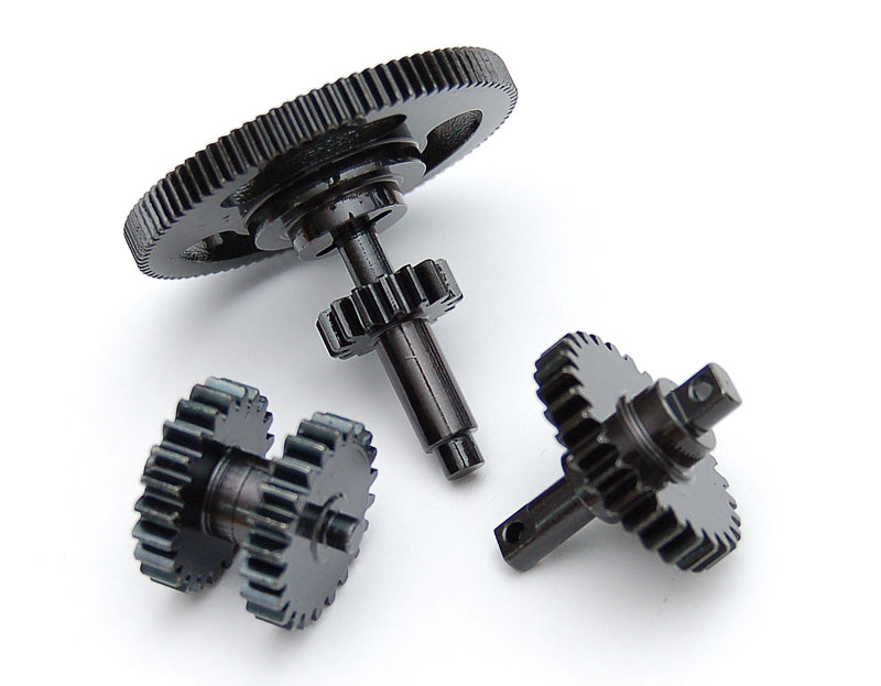

We will be shipping next few days, after some testing.

By installing this gearset, does it get rid of the stock internal "slipper"? What's the estimated price on them?

That is a great picture! You're going to make a lot of people happy with those!

Cool, but it looks like that spur gear is not detachable. I run a 72 tooth 32 pitch spur gear(that I am VERY happy with), am I screwed to use the stock upper shaft?

Ahh, I didn't notice that. Is that large gear on the topmost of the pic a spur gear? If so, it does look as though there is a through pin and the back of the spur is notched like the stock spur hub...so it should be easy enough to swap still.

I thought of that, I found another picture on their website of a frontal view. It looks to me that the spur, is part of the spur hub.
Yeah, I see what you mean. It looks to be a 90 tooth. I use 32p gears also, so if the gear doesn't come off that hub, I'd have to go back to 48p. It may be alright though since they are hardened...I only went to 32p due to strength issues.

Im betting it comes off, see the top pic and the slot for the pin to fit in? all you need to do is to do is install a screw in the center of the shaft Im betting

Here's a pic that confirms the fact that the spur gear is indeed removable
from the shaft. The steel spur included does not use the stock plastic hub,
but rather has the "hub" portion built into the spur.
