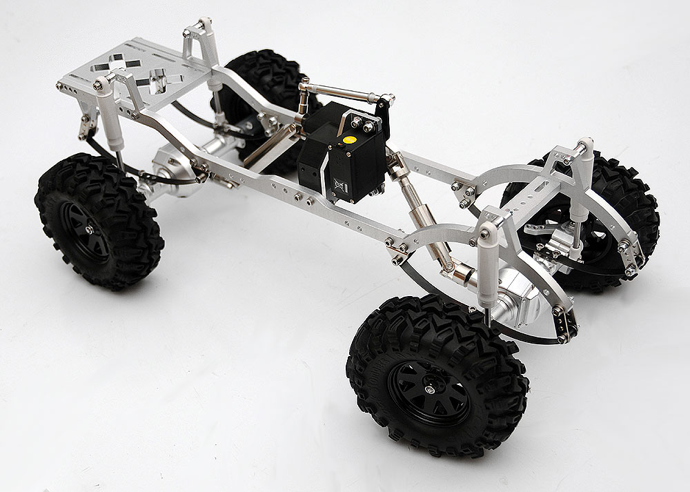

Drool! Looks great but, that rear shaft is extremely angled

Looks good i like it, rear drive angle a little steep, Did you guys ever think of maybe adding some pinion angle to your axles when you design them? just a thought.

x3, the rear angle can easily be fixed though - by adding a m3 nut between the axle/spring where the rear bolt goes through. Worked for me.
Would probably be a good idea to use 4 bolts instead of 3 to hold the rear axle on

i agree the pinion angle is an easy fix, just wonder why nobody ever designs it into the axle.

That is awesome! I am questioning the extreme angle on the Punisher shafts. Mine kind of loped and they weren't quite that extreme.
It is very difficult to machine things to have a clocked center. You would have to add another machining setup to an already complicated piece.

why not offer some degree shims to bolt under the leaf on the axle? so it would rotate the axle up.

or they could just mount the trans on the top set of holes instead of the bottom ones. that would solve everything.
