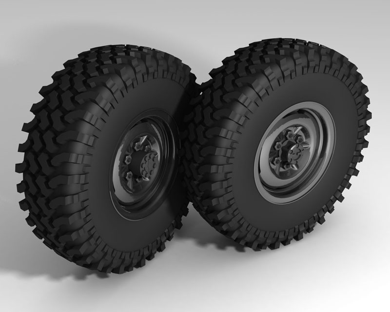

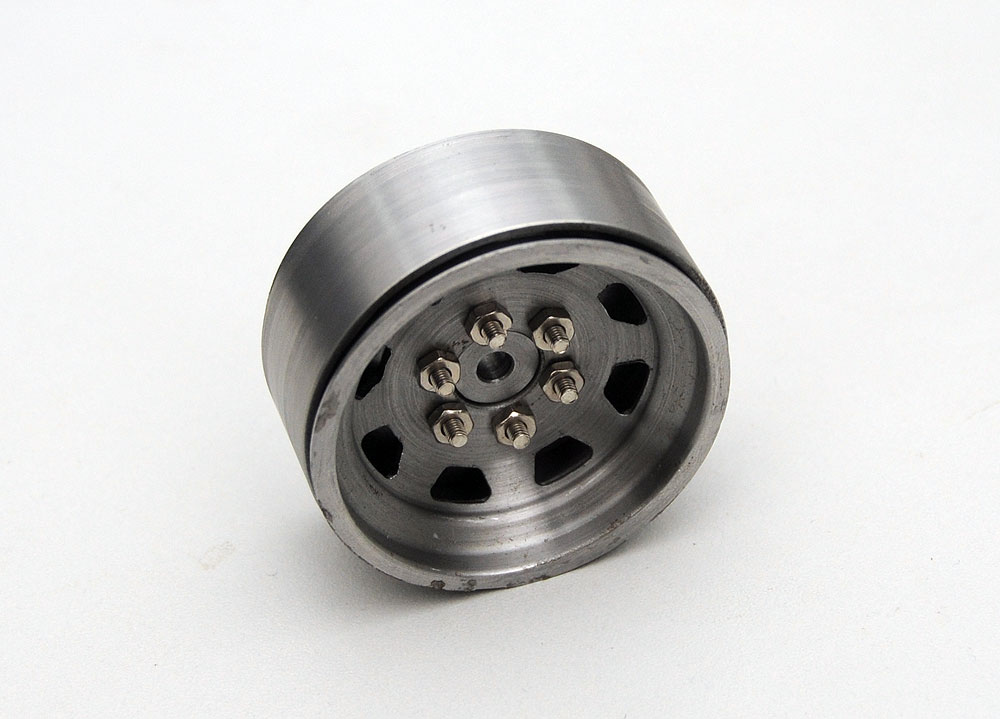

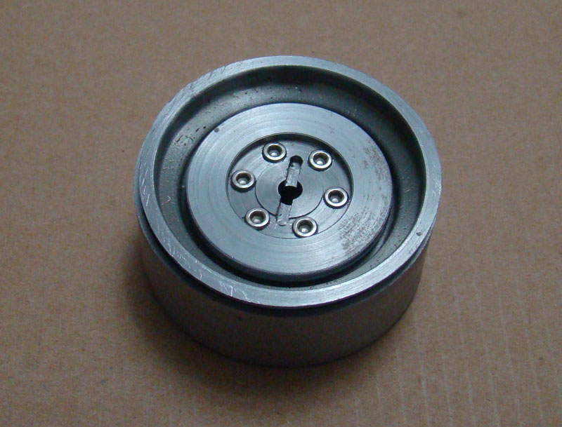

About half of a year ago, Fracture and 500swmag simultaneously contacted us about the idea creating the first stamped steel wheel.
In Fracture email, he mention various features of this dream wheel and his last sentence was "Tell me if you think you are up for the challenge."
Months has gone by, today at 5:50AM PST California Time, we finally got the first prototype made.

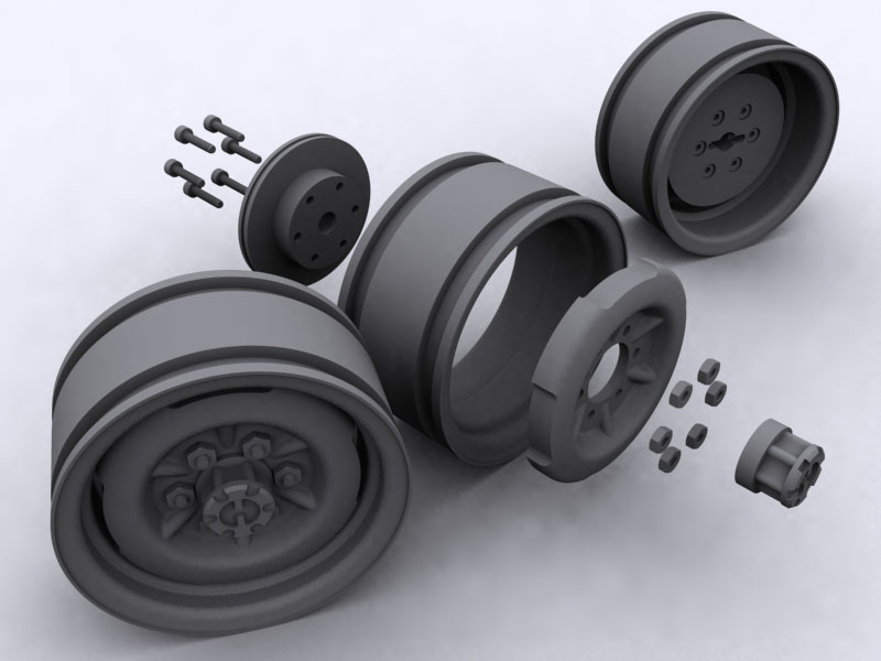

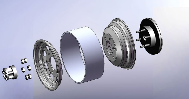

Below is another design that we are also working on, both wheel mounting systems ( 6 bolt + hubcap) is identical.
The goal is to create a pretty near replica of a fj40 stamped wheel, It is in 2 parts so that 4 slots can be added around the diameter for realism.
Fracture also designed a disk brake and hub system that looks and works pretty much like the real thing.
The disk brake has a slot for a drive pin, it slips in place and is held on by a nut in the form of a aisin locker (front) or a 8 bolt full floater (rear).
The wheel then bolts onto 6 m2 studs.
What isnt shown is 4/8 grub screws which will hold the outer rim part onto the center. Simple and strong:

looks like you nailed my version, I'm sure you will hit fractures dead on also.
looks great keep up the great work.

that is just bad ass! no doubt the first version will sell alot more though. but whats the point of the brake disc, if you cant see threw the back half of the wheel? it would be great if there were holes in the rear part that matched the front part so you could see threw the wheel for realism. (rear holes probly need to be 20% bigger so you can still see threw at side angles.

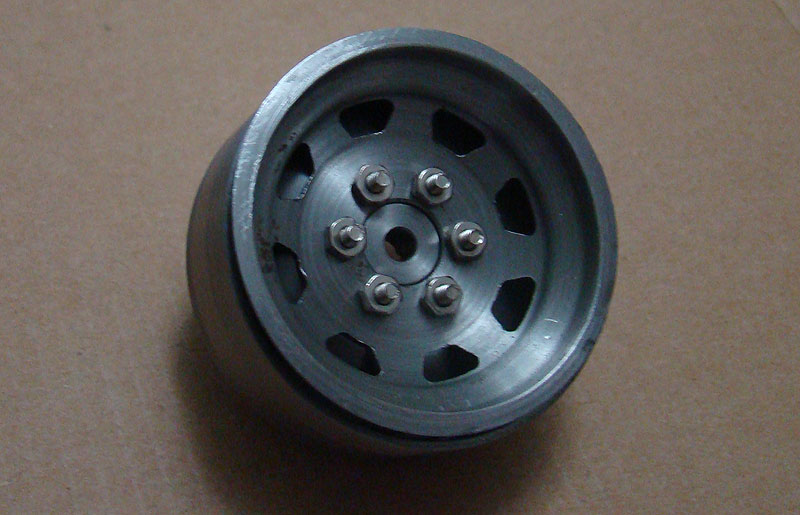

One updated picture...we going to test with M1.5 and M2 screws next few days and see if we can get it more scale looking

Much better photo. I like the idea of smaller hardware.

that first wheel looks like a copy of CAC's ringless beadlock design.
BigSki is offline   Reply With Quote
Old 02-19-2009, 06:11 PM   #20
500swmag's Avatar
Join Date: Jan 2007
Location: monson
Posts: 532
Default
I started the Centerlock design in June of 2008, lost interest and started up again a few months later. RC4WD posted up the first pics in October of 2008. To be honest I havent seen CAC's ringless design, my inspiration was an old Kyosho Double Dare that I have, that and the real beadlock designs from the early military trucks.
