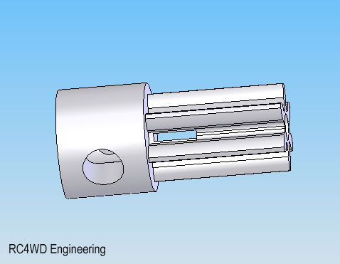

chino63, cool. I might need you to test it again when we release the final prototype:
We expect to start shipping the 32 Pitch hardened steel pinion gears within 1-2 weeks. Initially we will have 6, 7, 8 and 9 tooth available.
In terms of 48 Pitch gears, there is some delay, I expect to have it towards the end of the month.

that design looks better but how much material is actually left (9t)? this is the problem when making small pinions. the 10t 48p gear will be fine like that with a pilot hole all the way through when made of steel but the 9t 48p might be questionable. the 9t might eventually crack between the teeth and start sheering teeth. if the pilot hole goes all the way through, the motor shaft won't need to be shortened and no motor spacer required. keep it coming! these gears will be sweet once the bugs are worked out!

chino63, no keep those as souvenir.
That design was actually for 32P (long version), in terms 48P, our gears will have the same height as those from robison racing or similar companies.
