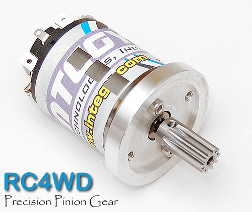

Default 540 Motor Conversion Adaptor for Bruiser
We expect to ship next week. Price is $29.99
As you can see this is also in the first one piece heat treated gear that we made, all gears in our products will be done like this.

Got it mounted up, Everything was smooth BUT I would recommend the buttom head style hardware as it has a lower profile becasue with the hardware it came with, the head of the bolt protrudes past the counter sunk part of the mount and doesnt allow the motor to sit flush
Well the mount is nice, and itll be great to use 540 can motors especially with all the different lathe and brushless motor combos out there. Only issue now is making a mount up front to hold the end bell of the motor or some sort of other custom mount to hold the assembly in place???
Right now the end bell fits into the mount but it still has alot of play up and down and to the sides.
Hope the photos help guys!
-Mike
