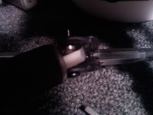

ok so i found that i really hated the stock shocks they were too soft and the pistons werent smooth at all so i stripped my losi stadium truck for its shocks and slapped em on heres a step by step on how to put losi xxxt shocks on.
first get the old shocks off you will use some of the parts to make this work. now that they are off you are going to pop the top pivot ball out of the shock.(this is the part you need)
this is the side you want to pop out as there is only one side that is pressed in. i just used some needle nose pliers to poop it out shown below.
heres what you should get
now for the losi shocks. in order for them to fit without binding you have to file the corners off the top of the shock so the eye is rounded. shown below
now you are going to mount the shock with the pivot ball that you removed from the old shock in the end you filed upside down so the filed end is on the link arm.
and on the top you will need to get some slightly smaller screws the same length as the old hard wear for the top mount and reuse the original spacer for the top mount as well. and whala aluminium threaded shocks.
on some of the newer losi shocks you dont have to file them down and some you dont need to reuse the pivot ball. you can find them all over ebay just search losi xxxt shocks.
i recomend using the front shocks for the xxxt just because they come with slightly softer springs. that rears are pretty stiff.
and dont forget losi springs are progressive so they get stiffer as they compress.
