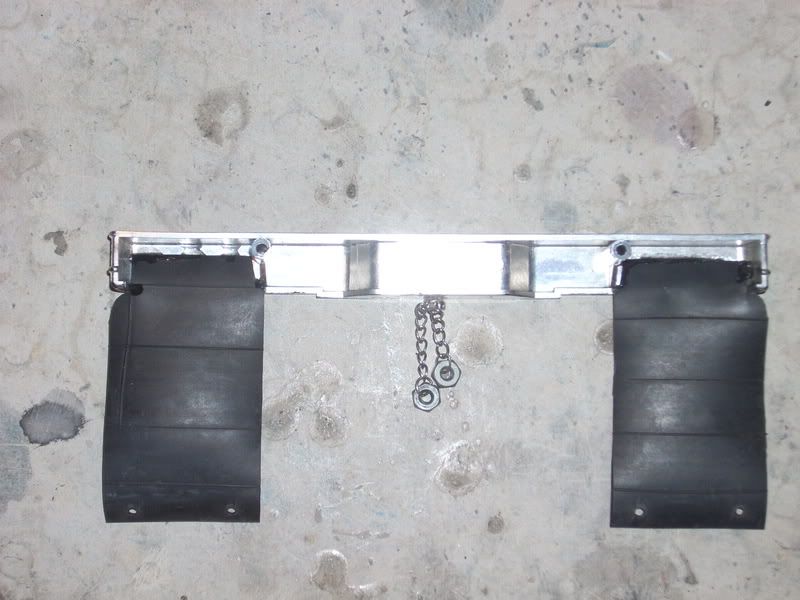

Here's a great way to make scale mud flaps...
Take an old bike tire and cut a strip as wide as you want it to be, then cut the loop apart. I used a knife razor blade and set it where i wanted to be cut. I then used a heavy tool to tap the top and it cut a strait clean line where i wanted it. This is the shape i wanted mine....
Seeing as the rubber has a tenancy to curl i cut some pieces of metal to bolt to the bottom for weight...
Used a wire brush to clean up to bare metal and painted...
I just glued mine to the back side of my bumper....
And here's the finished product. I used a leather punch to get nice round hole's, and used 4-40 hardware to mount.
Looks great, and is actually flexible unlike any others i've ever seen built. Easy, cheap and looks/acts just like 1:1

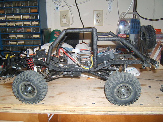

I was looking around for some padding for my rig. I found some Nerf Sonic Micro Darts at WalMart. Cut the tip off. And make a little cut all the way across the dart to fit over your bars. Then I just put electrical tape around the roll bar to hold it in place.
Padding cost is about 5 bucks for ten sticks. I needed 2.5 bags to do mine.
