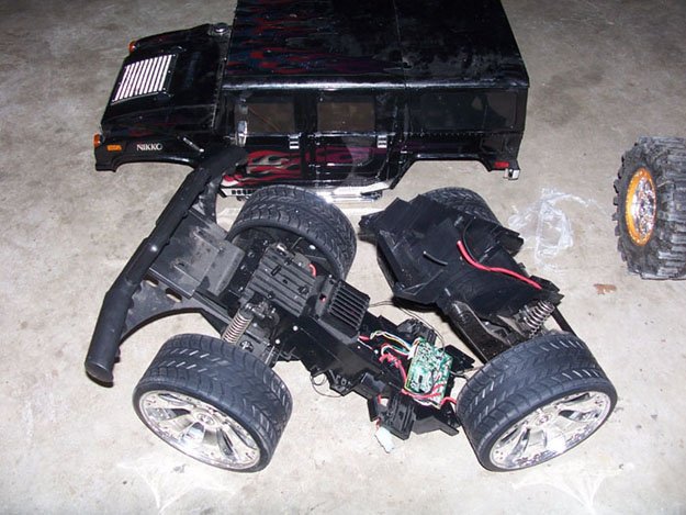

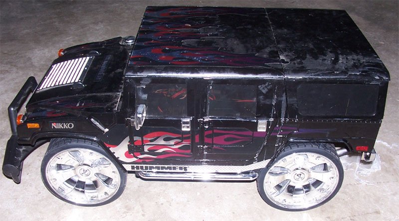

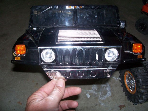

This H1 hummer body just picked up at the swap meet for 10.00 that was a rc nikko street hummer now the star of my clod based hummer that hope to take to completion over the next month or so. t's my first sart to finish scale project to date. Here in san deigo there is not a comp class for supers since there just isn't enough inerest so I'm going scale with it.
Plans are ti build a channel frame out of 1/2 or 5/8 box and cutting down the middle then building off that with 1/4 tubing for the rest. I will be using savage shocks with 3/8 or larger links with the big traxxas ends. I built a 1to 1 hummer in the past that I will post some pics of soon that doesn't have a exo cage but has no top (except for soft top) and has a huge 2" rollcage that will be the base idea of my exo cage. The nikko body even has working light built in already which was a bonus. It will end up with a removable roof rack and light rack aswell.I think after looking at the body ion my super chassis that is 17 inches long that it will need to be longer by 1/2 inch or so.
Just got started today in the tear down and start the mock up and design.I will post as I go and get the pics of the 1o1 rig soon. Can't wait to get sarted and will be geting tubing and the box for the frame soon. Hope you like it and all the input to help me out is always helpful. Thanx for looking.

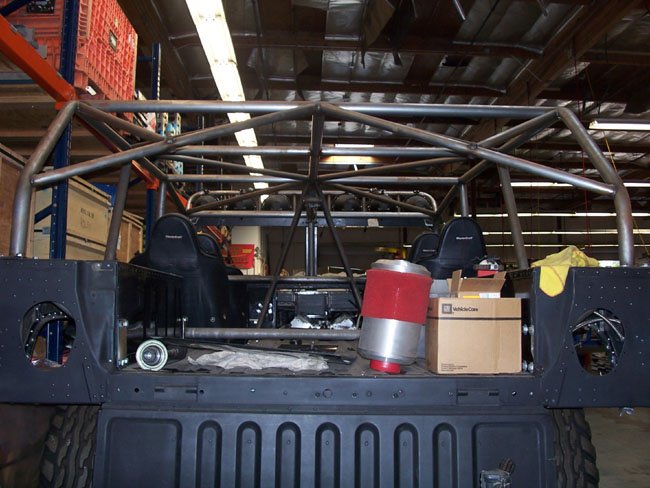

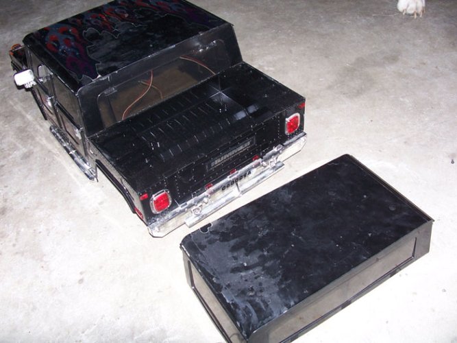

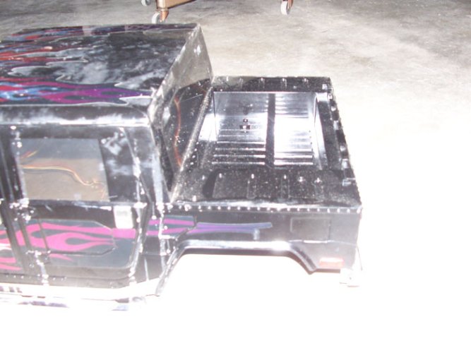

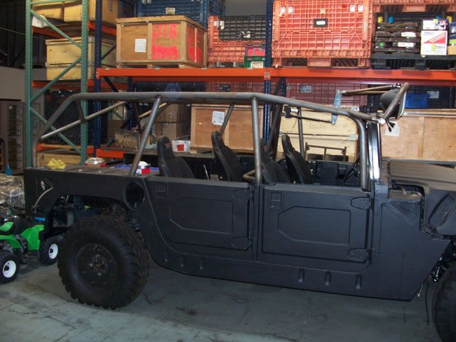

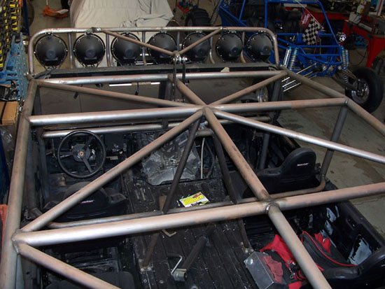

So I got the pics of the 1to1 h1 I did so you have an idea of were this one is going the only difference is it's going to be exo cage. I also think I might make the rear section removable so that I can have a slanted rear section like the 1to1 for when the h1 is truck style then pull off the rear section ad the wagon section to the body and have a different exo section for that so I can have both. I will be building a light rack like it aswell and in the last pic shows a ram style servo that adjusts tilt on the light rack which is very helpful not to blind people in the desert since you can tilt the lights up to the sky when you pass people and it is ran from buttons on the steering wheel. The 1to1 also needed the lights to tilt way down so it could go in a normal garage door. I was thinking of doing the same thing but use a servo to move the lights but same style linkage so I can hide the servo in the body.I also got the 1/2 inch .049 wall for the frame so I can get started. I will also be building a trailer to tow behind it for all my other crawlers and I'm going to use the old h1 spinner wheels for it. My son that is 8 is taking on that project so we'll see how he does. I will post up pics as that gets started aswell.

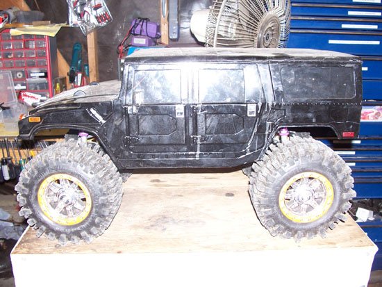

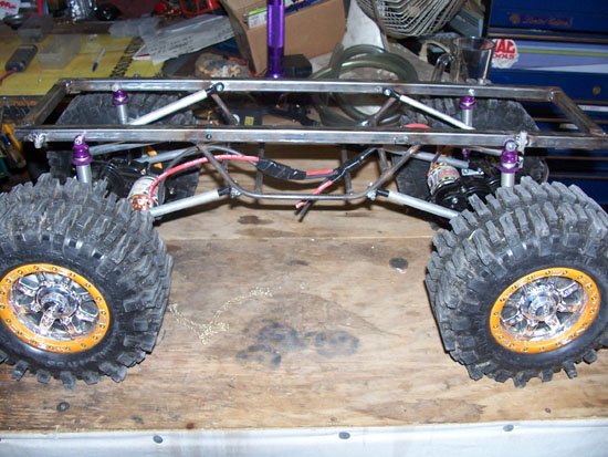

I got allittle done on it and have a main frame done now.I was going to bend the frame which is 1/2 inch box steel and cur down center to make two c channel frame rails but thought decided not to since it would need some real drastic bends in it. I used the 1/2 box for 2 frame rails then bent up the drop down out of 1/4 inch solid. Now I'm doing the links and getting it to a roller with shocks. The links are 3/8 alum drilled and tapped for 8/32 and revo rod ends. I'm using savage shocks that provide a ton of travel even in staight up mounting position. I will have roller pics in the next couple days and should have it driving but will start on the rock sliders and bumpers so the exo cage can be next. My son that is 8 has been working on the trailor for it too that will haul the other crawlers around. ( he's done the measuring,marking, cutting, grinding but I've done the welding)I will also get those pics up soon aswell. Well back to the garage for clean up.

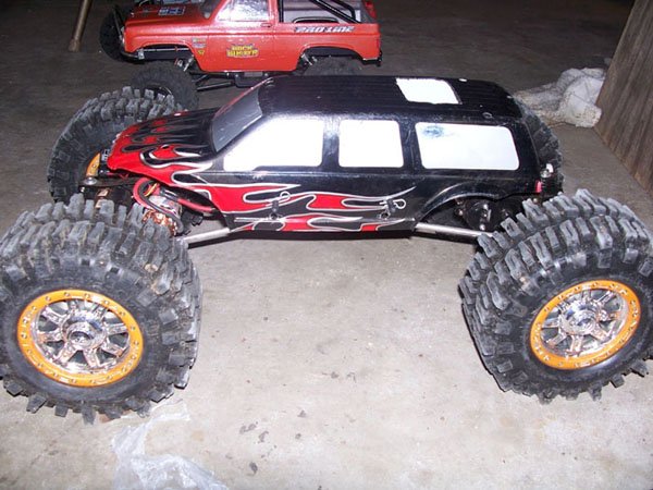

Default chassis roller
Well got some done and it's now a roller and almost ready to run. This weekend I will get it running this weekend just need to mount the steering. I have a over 300 oz torque 1/4 scale servo and since I can't afford a high dollar high torque in regular size I will make it work. I don't have room for it on the axle so I'm mounting it on the frame with linkage going to a pivot in the front to run the steering like a wheely king. Should work good and look clean without the sevo being seen. The chaasis is set up as a drooper and would like suggestions on shock oil. Next will be the rock sliders,front and rear bumpers then exo cage. (can't wait for that) Hope you guys like it. (one link is smaller 1/4 inch since I ran out of the 3/8 that I have now and will be replaced right away)

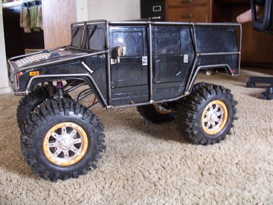

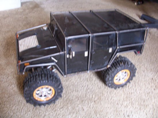

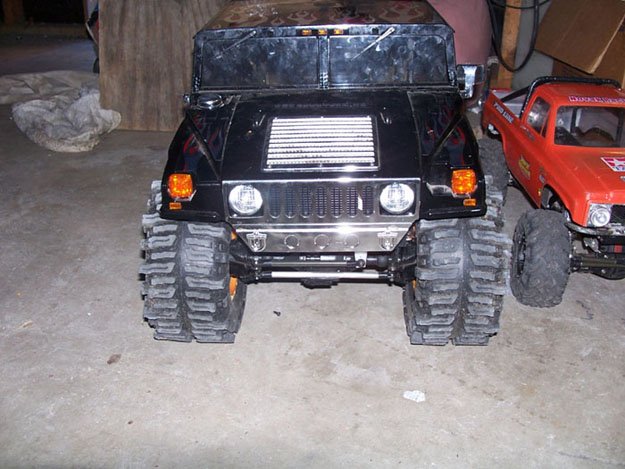

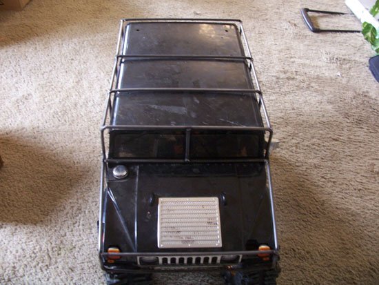

I just did some of the exocage for the hummer and now just need to add the smaller size x braces and light rack. I have enough weight on it now so I added the prings back to the savage shocks instead of being a complete drooper now it has a little spring and after the rest of the metal work should sit a little lower than in the pics. took it out crawling and it worked great but even with the weight have now it clod stalls more than like so might change the gearing some but besides that for being as big as it is it worked great in the rocks so I'm very happy.
