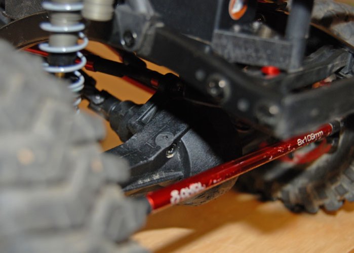

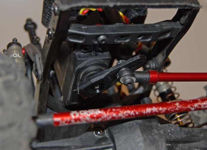

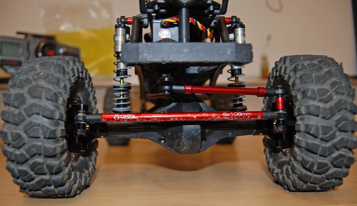

I've been driving the SCX10 pretty much stock for about a month now, and it's been awesome. But, I figured it was time to start making a few custom mods. First thing I did was re-locate the steering servo from the front axle to the chassis with a couple home made brackets that tie into the stock frame cross members. I was just able to shoe horn it in underneath the battery tray out front and get very minimal bump steer. It took a few tries to get the placement right, but it seems to be working pretty good from the couple small test runs I've got on it. I also cut the servo plate posts off the front axle to clean it up and give it a more realistic look. I also plan on cutting the posts off the rear axle as well.

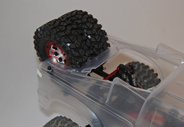

Next up was figuring out what body to run. Since I'm going to go for the pre-runner look on this particular build our Diablo body (Part # AX4002) was a prefect fit. The wheels are perfectly centered in the wheel wells without any mods to the stock SCX10 wheelbase.

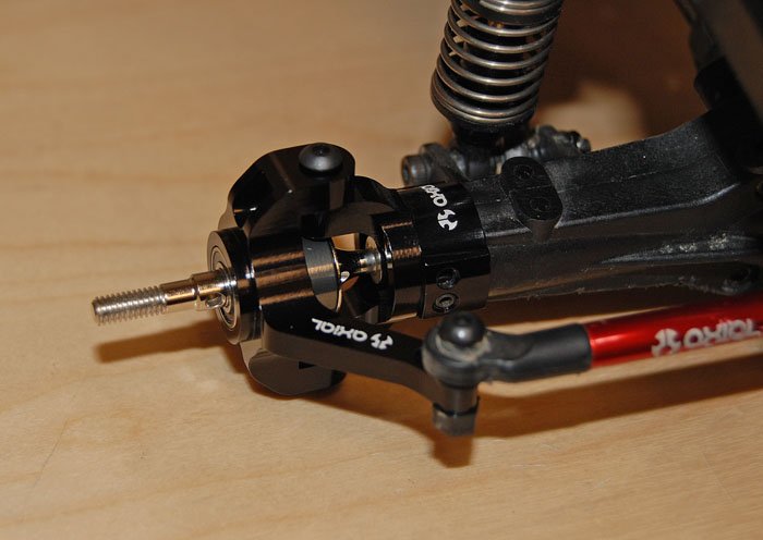

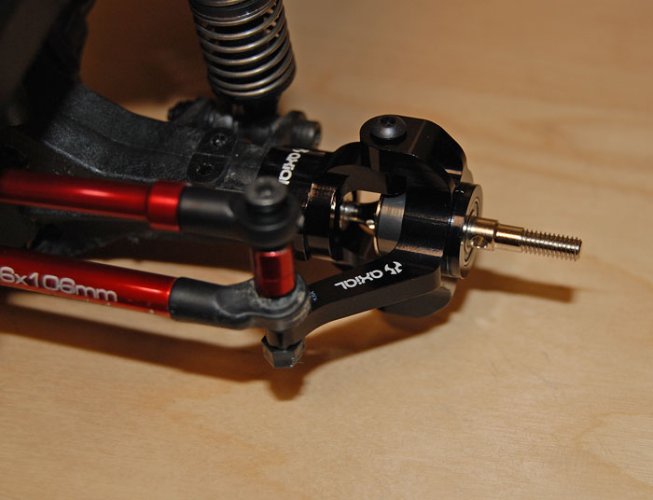

Installed some of our upgrades on the front axle..................aluminum C's and knuckles, as well as CVD's.

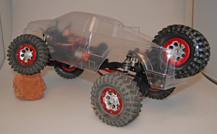

Can't have a pre-runner without some spare tires.

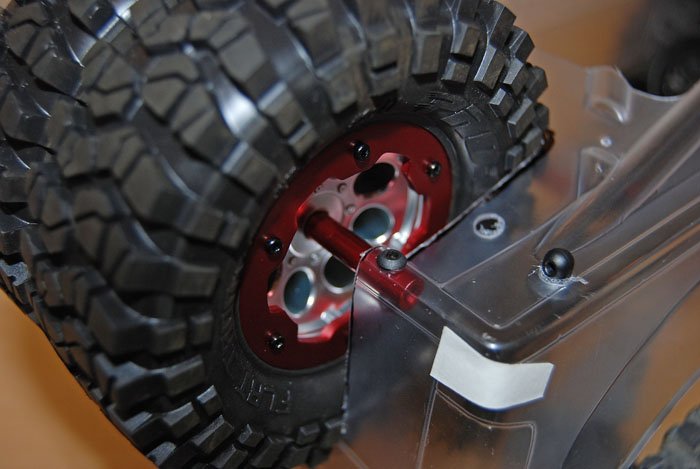

To hold the rear tires in place I used a red 98mm link, and drilled/tapped an M3 hole at each end. I opened up the holes in the center of the wheels to .236 diameter which allow the link to slide through. Then drilled a couple holes in the body that are used to attach the link to the body.
