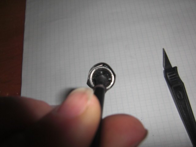

CVD bullet proofing
Ok guys, here is a couple shots of what I have been doing for the last 6 months to keep the pin from coming loose on my axle's. So far I have not had one single pin come loose since I did this mod. I know some have been shrink wrapping the stub to help keep the pin in there. I had done this as well but under hard load (dig) I found that the pin would slowly work its way out. So I started searching the internet for some very thin walled aluminum pipe that I could cut into rings, then I could "press" those onto the stub over the pin to keep it in place then put shrink tubing over that. The problem I ran into is that First, I had a heck of a time finding the tubing and Second there is a very tight tolerance to between the c-hub and the stub axle so the tubing needed to be very thin. So here is some pictures and info on what I did.
1. Cut some very thin strips out of an aluminum can
2. Shape the stip into a small "circle"
3. Wrap circle around the stub and bend it where the ends meet
4. Trim the strip so its the same size as the stub
5. Slide the strip/circle into a peice of shrink tubing, make sure you slide it in about an 1/8th of an inch past the end of the shrink tubing, so the shrink will wrap over the end of the stub to keep it from sliding off.
6. Slide this over the stub, Make sure you turn the ends of the strip so they do not line up with one of the pin ends (if your pin ends are at "12&"6" then put the ends of the strip at "3" or "9" )
7. Heat the shrink so it sucks around the stip holding it tight against the pin ends
8. Trim with razor blade so the bearing fits.
9. Thats pretty much it, the thin aluminum strip is just enough to keep the pin from pushing its way out through the shrink tubing alone.
