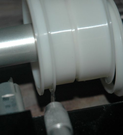

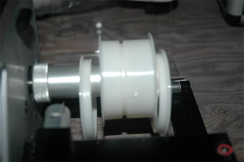

Cutting the wheels and attaching the rings:

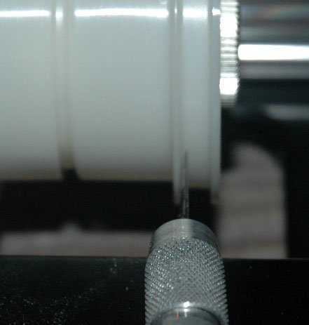

Pic 1: Wheel mounted for cutting on my tire truer
Pic 2: Outer beads cut off and mounting surface smoothed
Pic 3 and 4: I used the Heavy-Duty X-Acto handle with a #19 blade. I used the backside of the blade (non-cutting side) to cut the beads off. I also used the blade to true the mounting face of the wheel. This made for a truely flat mounting surface. I finished it off with an emory board (borrowed from the wife but you could also used 220 grit sandpaper).

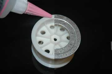

I used CA glue to attach the inner rings to the wheel. I also scuffed the matting surface of the ring with 220 grit sandpaper to allow more bitting surface for the glue.
UPDATE: When mounting the washers, the stampings (visible in pictures) should be facing outward on both rings for Moabs.
Masher 2K's have a thinner bead and he outer washer should be mounted with the stampings facing inward.

Pic 5 (coming soon): Front inner ring mounted. You will need to make sure that the ring is squarely mounted to the rim so that it is not offset creating an offset mount.

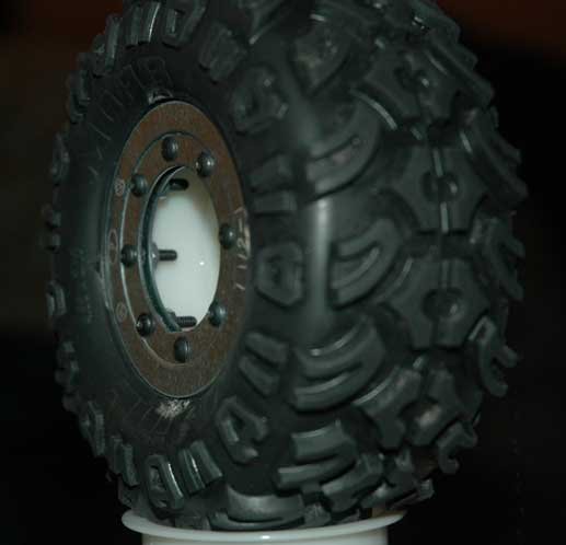

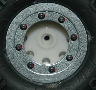

Pic 7: Tire mounted - Note the position of the tire bead around the ring. It is important to keep the bead centered around the ring.
Pic 8: I found that if you finger tighten the screws in a pattern that crosses the tire (note numbers in picture) before sinching with a wrench that it will keep the bead uniform and keeps it from deforming. Once all the screws have had the slop taken out continue in a cross pattern across the ring using the forecepts or needle nose pliers to hold the nuts. Only tighten the screws 2 to 3 full turns at a time until they are all snug.
Pic 9: Front outer ring mounted with screws and nuts
Pic 10: Back outer ring mounted with screws and nuts - This is where the curved forcepts or needle nose pliers are needed. There isn't much room between the ring the and rim.
EDIT: If you are not getting enough clamping to keep the tire in place try flipping the outer ring so that the stampings are facing in towards the wheel. This will expose the screws to the rocks more but may provide additional clamping pressure on the tires bead.

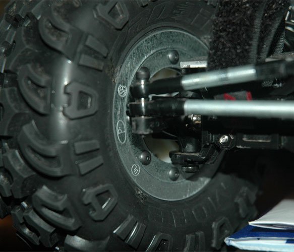

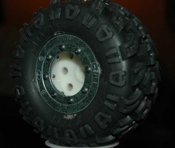

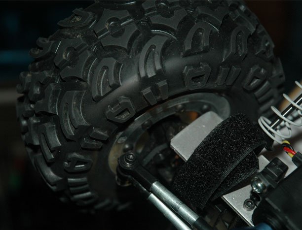

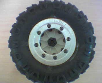

Here's the final product. I haven't had a chance to really put them through some serious testing but from what testing I have done they have not had any problems yet. I hope to visit a favorite rock spot in the next day or so to give them a good workout. I will post back with the results.
Pic 11 & 12: Finished tire
Pic 13: Clearance at knuckle on TLT
Pic 14: Another shot of the clearance
