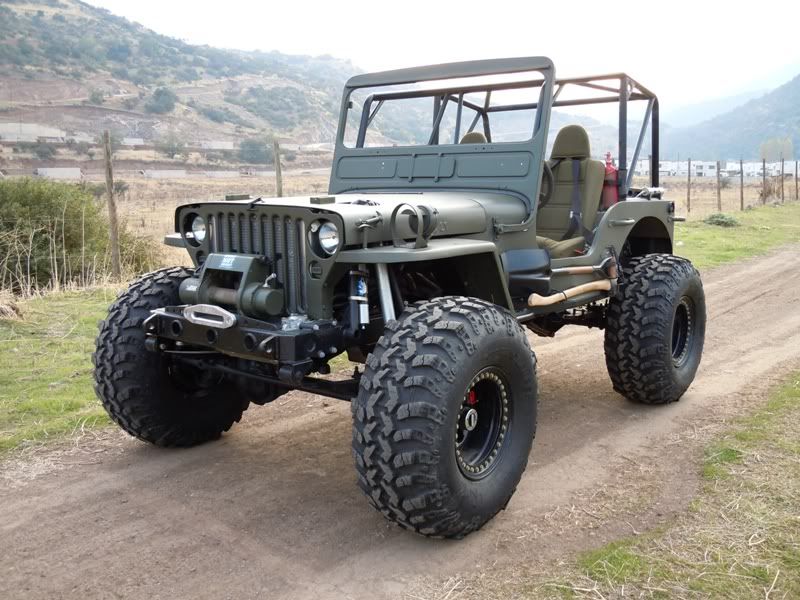

Next, I knew it had to be an old jeep because it would be easier to build the body (mostly flat panels), and I love old jeeps! Printed out a photo of a M38 grill from the interwebs and scaled it down to reproduce.

Thanks guys. Here are a couple pics I've been using for ideas and dimensions.

Just a random reference shot.
