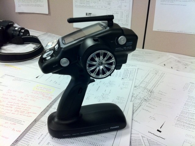

Finally, after so many months of development it finally arrived today.
I will be using this thread to help you all get the most out of the new addition from Futaba. I will be posting step by step instructions including video guides as well as wiring help to get your crawlers running with the new system.
Differences between the 4PL and 4PK
  • The digs are actuated different (with or without an update).
  • Response time on the FHSS system is slower than the FASST system.
  • 4PL only has one program mix (not including the 4WS or Dual ESC).
  • Wheel and buttons are non-adjustable and you can't use a drop down like the 4PK.
  • 4PL uses 4AA's as opposed to the 4PK requiring 5 cells.
  • RX cost is about half the cost for the 4PL.

if they would make a 4pk or 4pl that took a module i think alot of guys who have say 10+ specktrum rxs like me in all their cars would snatch up a new TX in a heartbeat .
but i gotta say that 4pl looks good!

Lucky bastard
Those ssz-9's look sick Harley seriously wanting this tx
