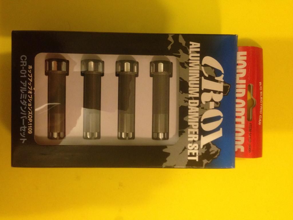

Onto the shocks, and the hop-up aluminium items. I've built loads of Tamiya shocks, right from the basic friction pogo shocks right through to TRF items on 201s, DB-01Rs and TRF801XT. These shocks are right up there in quality, but UK retail price of $195 is ludicrous; thankfully a HK seller helped me out for $60. So what do you get ? ..
Inside..
I stuck with the standard shock build instruction of 2 hole pistons, nice snug fit between the retaining e-clips..
Four (!) o rings seal the piston road - I always pull the rod right through and add the o rings (with some Associated Green Slime) before drawing them back into the shock body - this avoids damaging the o rings pushing the thread rod through them when in he confines of the shock chamber...
and slowly eased back into their chamber, before tightening the lower cap..
Adding the lower eye, I use an older set of side cutters to grip the last groove of the thread, avoids gripping and potentially marking the shaft..
adding the seal (a little green slime top and bottom) and upper ring, before clamping down with the top cap..
All done, I went with Factory Team Associated 25wt silicon oil, maybe a little bit light but should ensure quick damper responses..
