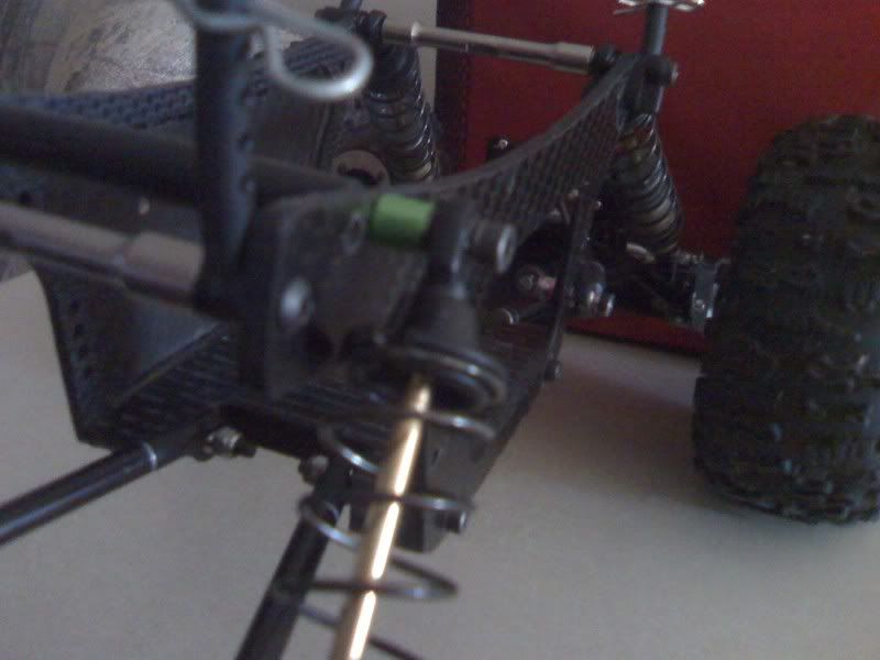

Here's the front of the chassis. I trimmed up the chassis a bit, which gave the shocks plenty of clearance. I mounted the shocks inward so they'd have a fighting chance of clearing the tires. A TLT post braced up the front perfectly

I've got this thing done. Except for mounting the transmission. The mounting holes on the Axial transmission stripped... talk about a dime holdin' up a dollar
I've mounted the batteries. I just used velcro on the side of the servo and on top of the axle case. I had to bend the suspension stays to make it work, but work it does.
I made an electronics plate from an old DVD case and got it zip-tied in place on the front links. I routed the servo wire underneath, and gave a small opening on the side for it to snake back up top. This will put both the servo and the ESC wires side by side... I'm going for somewhat clean wiring...
And, I finished up the rear with an axle truss. E-Z Designs Axle truss II to be exact... Upper links are allthread with Axial and Stampede ends covered in aluminum. Works perfect.
You might be able to tell from the pics, but I moved the upper links up on the chassis. My lowers were hitting my uppers, and binding, and this fixed it perfect. I didn't really try, but I managed to mount everythging up front. All the (moveable) weight is over or right behind the front axle...
