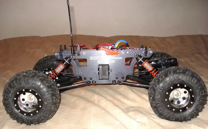

RYY's first attempt at a TLT crawler;
12.25 wheel base
G-made widners
Sw2 chassis
Jrxs, Tekin rebel II, Matrix 55t pro, Locked pedes, Locked TLT diffs.
Narrowed HPI w/ custom foams.
Name:  Ryan truck 005.jpg
I am hooked w/ more to come.............

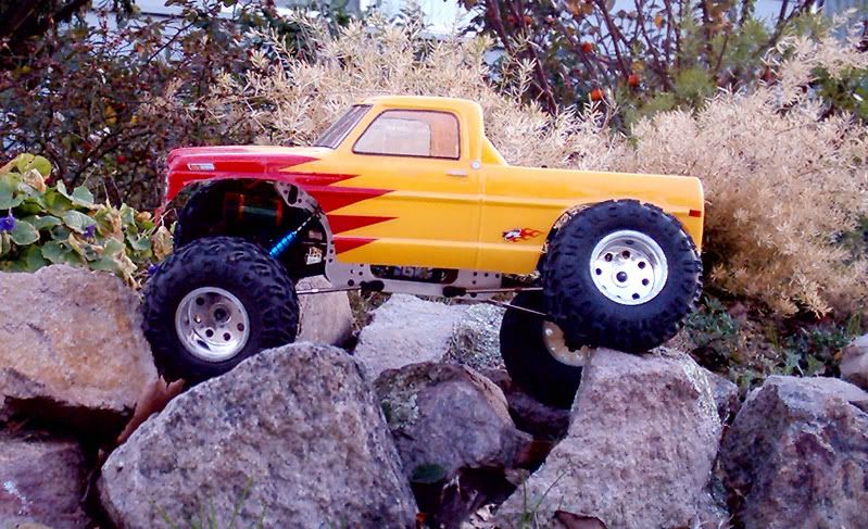

My first cut up stock chassis:
My new Kuala chassis:
Current stats:
Kuala chassis
Stampede tranny locked with JB Weld
Traxxas hard anodized aluminum idler gear
Traxxas steel outdrives at the axles, plastic at the tranny
Pede axle driveshafts
TLT-1 axles locked with JB Weld
Tamiya TG-10 stub axles (so the wheelnuts have full thread engagement)
Stampede wheel hexes
Maxx lower links
AE 4" shocks inverted
Pede rear wheels
Pro-Line Moab 2.2s
Hi-Tec HS645MG steering servo
Inverted Y steering linkage (thanks to Deiselpower for the idea)
Integy 45 turn lathe motor
12/87 gearing
Airtronics MX-3 tx
Novak Rooster ESC
Hi-Tec micro rx
12.5" wheelbase
Proline 70 Ford F100 body
