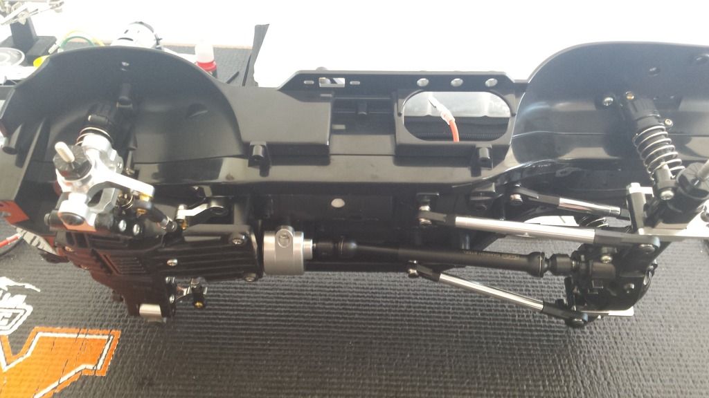

So now that the chassis has been rebuilt, gears cleaned, greased and full bearings installed, shocks rebuilt, I started on the GPM ugrades. In the pics you can see that I used the GPM 4-link kit (truck already came with the GPM rear shock axle mounts), GPM bottom gear cover, c-hubs, steering knuckles, steering bellcrank kit, steering links kit, servo mount. It took me a little bit to figure out the steering setup and get it to work right, but now that it's done, I have ZERO slop in the steering. I also installed a Junfac steel drive shaft in the rear.

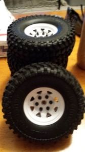

Picked up a set of "take off" RC4WD 1.55" Mud Thrasher tires and steel wheels for this build.

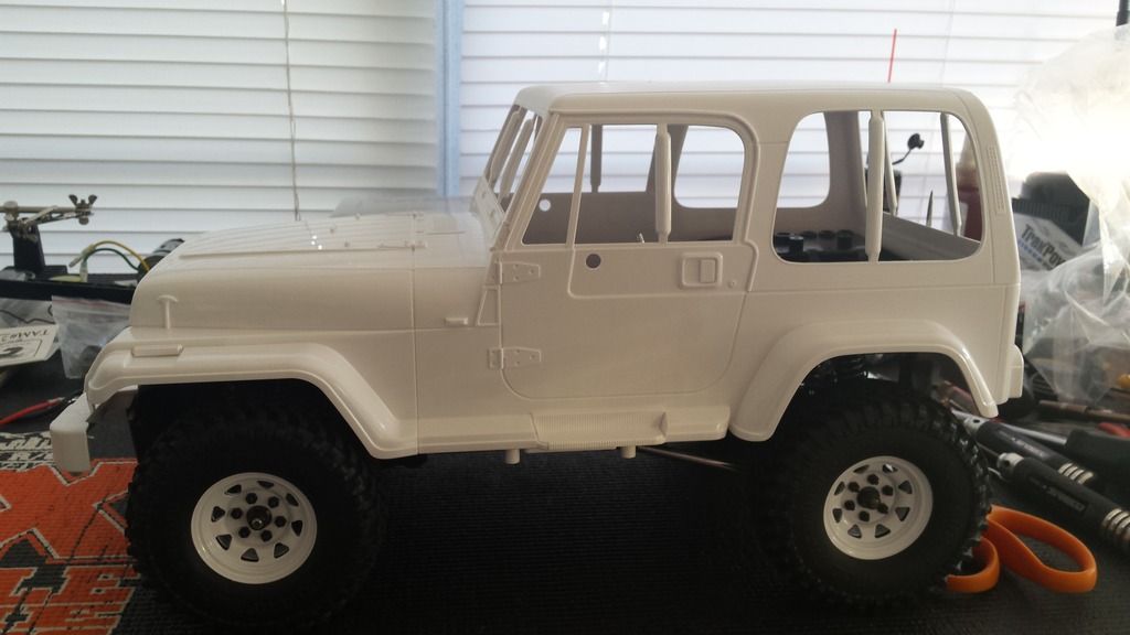

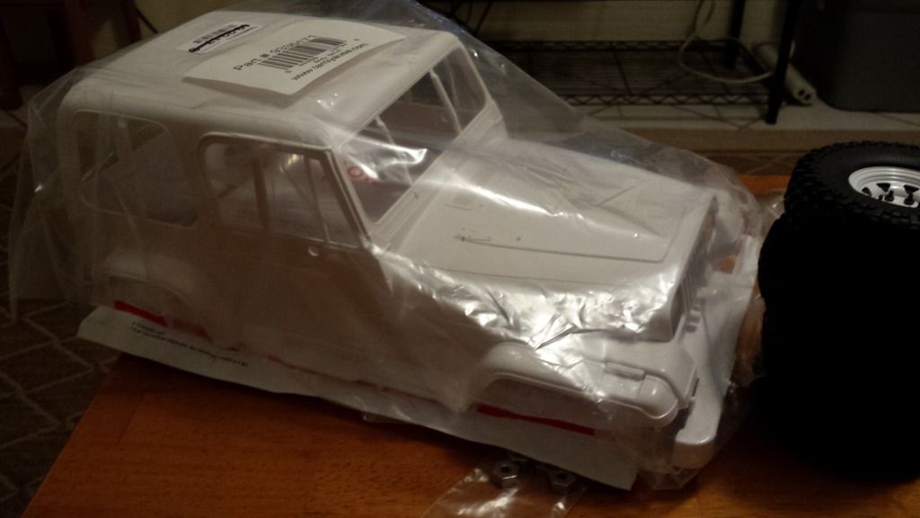

And a Tamiya Jeep Wrangler body from RPP.
Body mocked up on the chassis, still wiating on some misc parts and a parts tree from RCMart with the Wrangler body mounts I need.
