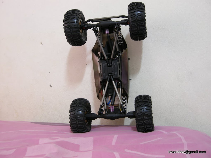

after fix cvd & gear 6packon this track and NO problem cvd.
have motor heat only.

I do like this /cover cvd,shaft drive and limit steering
