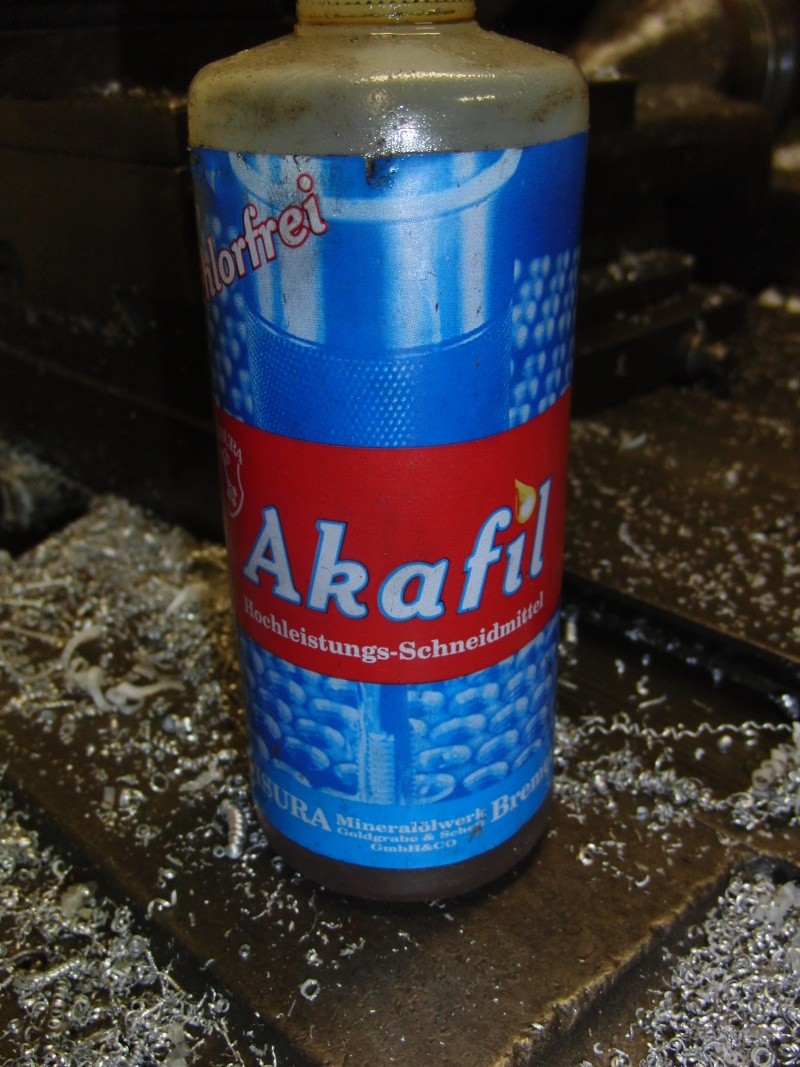

thats the one i use for Titanium , 7075 , stainless , spring steel , tool steel
and ...
EGRESSor is offline   Reply With Quote

itīs the low thermal conductivity + the high tensile strength what makes it hard to machine
i like the cutting fluid more than the paste , works better for me
