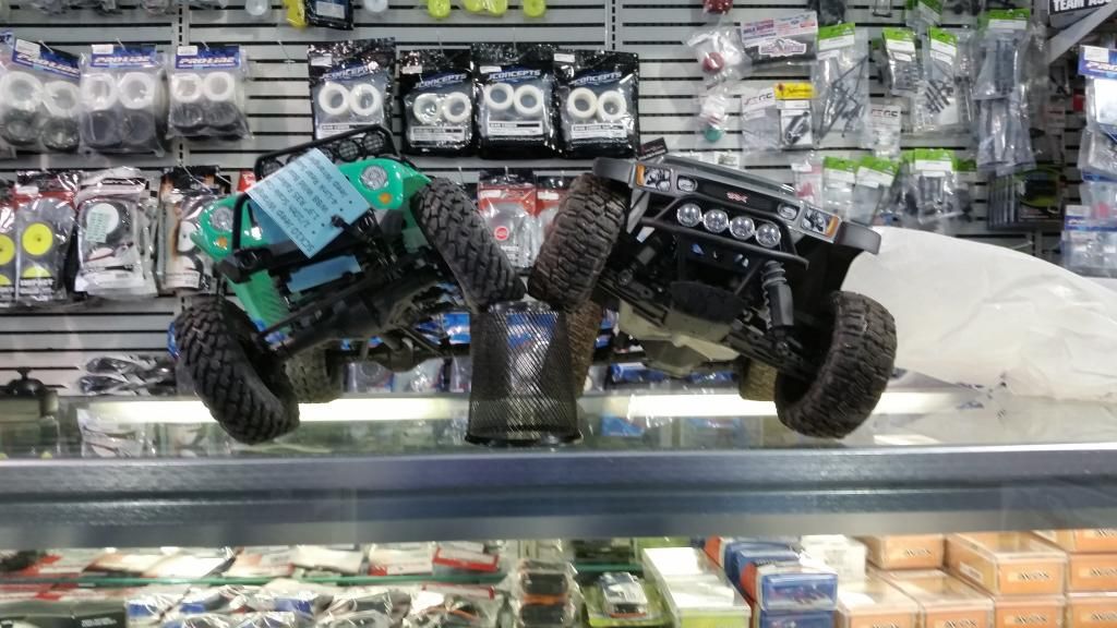

Straight out of the gate here is some eye candy...
Basically I mixed some Stampede 4x4 into my Telluride roller I bought as well as some spares from my SCX10 Dingo and exo terra (wheels) with trencher tires. It all married up with a Pro-Line 1991 Jeep Cherokee body I picked up at my local hobby shop "Pete's R/C Hobbies" in Dallastown, PA.
Here are a few more pictures...
The tires tuck up nicely with no rubbing and the VXL system is more than enough power. Over all it goes flat out like a scalded dog, hill climbs like a rock bouncer, and provides for some "spirited" trail running. Picture SRT8 Cherokee on the trail....
Future plans are to do the HPI gear reduction, rear locker and some 100K front diff fluid to make it a little more crawl then speed demon.

Quote:
Originally Posted by jrkilburn View Post
What are those side-guards? Are those a stock Traxxas part? Where can I get them?
fyrstormer is offline   Reply With Quote

Quote:
I think those are standard Axial parts...........may have to get a pair and rig them up on my Telluride

Posts: 127
Default Re: Telluride scale rig (attempt 1)
Ya their stock axial rock sliders for the scx10.

Posts: 810
Correct, they are stock axial dingo sliders. I drilled two mounting holes per side on the tub. The battery side of the tub I used button head hardware with the nut on the outside. Did that for proper battery fitment.

Posts: 1,607
Cool, thanks. I added it to my shopping list.
