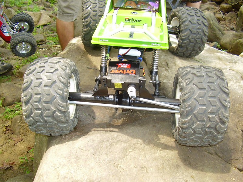

Today i went to the hard ware store to get some steel to make them.And today i got them all together besidedes getting the tubes to bult up to the diff.I still have to make the servo mounts and link mounts.I also need to make the linkage.Heres kinda what they look like but my servo is going to to the right of the diffNo winpy as.s plastic here.............it steel baby!
Click the image to open in full size...Not over the top.

Finnally here are the pics.This is the front in progress and done.It took me and my uncle about 6 hours to make the front.Tell me what you think.
here is one side.
3 pegs to hold it together
This is where we had to cut the washer for the knukle and linkage to fit right
Heres it bolted together.It has a sleeve in the middle and so it hold them tight
The links nad shock mount to the same piece of metal.To make it simple and easy.
Servo mount
The axels have WAY more turning than the tock ones for some reason.So i will get some pics of the linkage on here tomorow and with the tires on.TELL ME WHAT ZYOU THINK!!!!!!

6 hours? Even with that much time you still didn't even raise the diff. That is the main point to building a crawler with Maxx diffs, better diff clearance.
Also, you built it based around Maxx shafts... you have not done any research here on RCC before you started building. Maxx shafts break left and right. Revo swap is the only mega tough option.
Guess you'll get one run and have to rebuild it.

Well lets se here.Im 14,i just learned how to weld and i use my chore money to but stuff.In the pics it looks like they weigh a ton.But i just weighed them and they weigh about 1 pound.I am going to be doing the revo swap soon.S o take it easy on my okay?

I don't care how old you are, hell... I've seen worse from the old guys on here before. I just wanted to know why you wouldn't use the Maxx diffs to your advantage, that's all.
Quote:
Originally Posted by crawlerman
Will revo shafts clear inside those tubes? Go with CVD's to be on the safe side. I think it's sweet. Sure it isnt the typical maxx, but using a maxx isnt only to get diff clearance. This axle looks twice as scale as any clod axle I have seen, so why dog on him for building somthing different? As seen here, maxx diffs have been made scale appearing. Cooler than locked ones with diff clearance like I have, pretty sweet idea if you ask me.
Revo shafts are pretty big compared to the Maxx units but by looking at the pictures I think it might fit. Only real issue is where the knuckle attaches. The Revo knuckles have a different distance between the upper and lower piviot balls compared to the Maxx ones.
Did I "dog" him about the axles not looking scale? Hell, I never even noticed him mentioning scale axles in this thread. If I missed that please point it out. Only reason to build a Maxx is for two reasons:
1. To be different.
2. To build an axle with more ground clearance,
That's it.

Hey thanks toyofast.I mean i dont want to get on your bad side but i was kinda going for the scale look.AAns i would also thank you for showing me the pic of the revo knukle.If i buy 2 more washers and re drill and tap them they schould work out fine.And this is more of a go out and fid some rocks to crawl on.Not a comp crawler so than clearence doesnt really matter to me.
