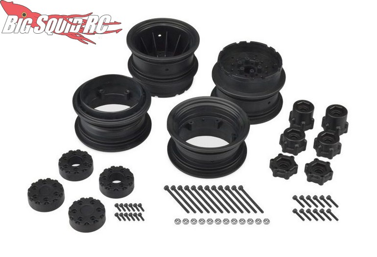

Like all good trucks, this one keeps me wanting to try out new ideas. Lets give these +17mm hex extension kits by GPM a shot.
They only measure out a couple millimeters wider per side than the extension kit I already had on there, so it probably wasn't worth doing. I didn't need clearance or anything, I just wanted "more big" . If you're wondering how the scrub radius on the steering is doing with all this extra width, it is, uh... not good. But that's life when you try to go as wide as possible on stock axles.
Next up, tires. During the holiday sales last year I picked up this set of JConcepts 2.6" dually Fling Kings, which were on my bucket list since they came out.
It's a cool look but the smaller size is actually pretty noticeable compared to the original Firestorms, and because the theme of this truck is bigger=better, they probably won't stay on.
So no major wins to report this time (unlike the 570 Arrma motor from earlier, which continues to be really good) but I have at least one more idea in the works for this guy.
