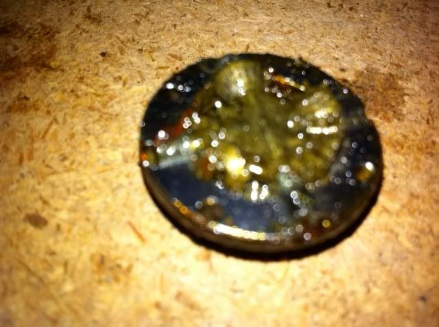

3rd time out with my creeper safari, my front tires stopped turning. i thought
the drive line fell off. but the pinion was turning. so i took the axle apart and
this is what i found.
stripped spider gears

EVERYONES EVENTUALLY DOES THAT, JB WELD THEM FOR A QUICK CHEAP FIX THAT LASTS, OR THERE ARE OTHER OPTIONS LIKE RMDW'S LINCOLN LOCKERS

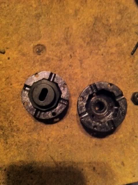

FYI the venom heavy duty diff. case will only accept the venom spider gear locker.

I installed a set of front and rear Venom lockers (P/N 8410) and ran into the same loose fitting issues as blackbart. On it's maiden voyage and within 10 feet of driving, both lockers just spun within the case. They spun bad and quickly enough that they don't even allow the truck to move on flat ground.
This is with a stock plastic differential housing, removed spiders and removed locker collar/hub.
Are we missing something as far as required parts to make for a proper fit? The HD differential case perhaps?
