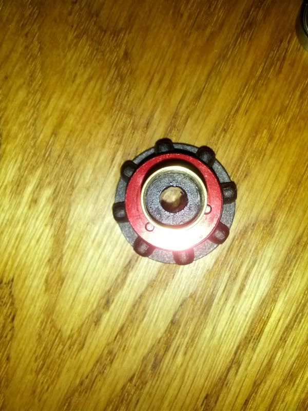

Default Re: Official venom factory support thread
Just got my Creeper a couple days ago and have been working on it off and on.I went to assemble the diffs today and the long side of the diff case is to big for the bearing or the brass sleeve to fit over.[IMG][/IMG]
I tried sanding it some and it still would not slide [IMG][/IMG]on.I tried the other one of this piece and the same thing.I tried to tap the bearing on and ended up breaking the center out of the diff housing.
I have emailed customer support to see what they will do to resolve this.I really don't want to wait for them to ship me another set and have the same problem and be down another week.
I was going to order the metal diff case and lockers but I think I will wait and see what they say first.
