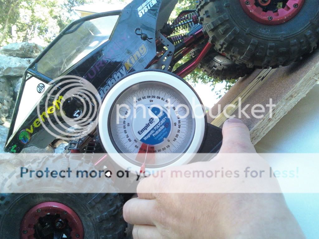

i've seen a couple threads with people talking about little to no TT. i've raised and spread my rear links (see picks) and can get to about 60 degrees vertical climb but it seems like the right front still picks up a fair amount. i was curious if anyone had a measure of torque twist. something like amount of weight required to keep the right front on under power. more weight needed, more TT you have. any thoughts?

Jebster,,,youll never get rid of all the TT. Period. How much weight are you running in the front end?
Try a little more spring preload in the right front and left rear and a little less preload in the left front. One thing to remember is that when you get the front axle closer to the apex of the vehicle angle,,in other words the front axle is close to vertically parallel with the rear axle it starts losing vertcle eight and becomes spinning mass on the ends of the links. The more verticle you get the harder it will become to keep the axle from trying to wrap to the left. Alot of our TT comes from rotational forces fighting each other and the differences in weight placement versus shock/spring-link geometry.you can also try spreading the front links a little further apart. Add another 6mm spacer between the link tabs and the rod ends for both front upper links. Remember too,,60 degrees aint no joke.

Check out page 2 of my thread... I'm getting 58 degrees incline Creeper-wise without ANY wheel weights at all... Kinda surprised me, since I put a fair bit of work into my AX since I got it and I thought it would be better... I actually kept all 4 tires on the board, even when it started slipping...

RM, i'll make some pre-load adjustments as you suggested. i'm also going to try spreading my front upper link spacing at the axle. currently i have 5.25oz in each front wheel, none in the back.
getting to 60 degrees was a goal of mind for no better reason that most people in these forums see that as a good benchmark. in all honesty i've only had a couple hours runtime on the rocks (you've probably noticed the lack of action pics) due to work schedule but i'm hoping to get a lot of time to try my rig out this weekend. pics and results on the way.
