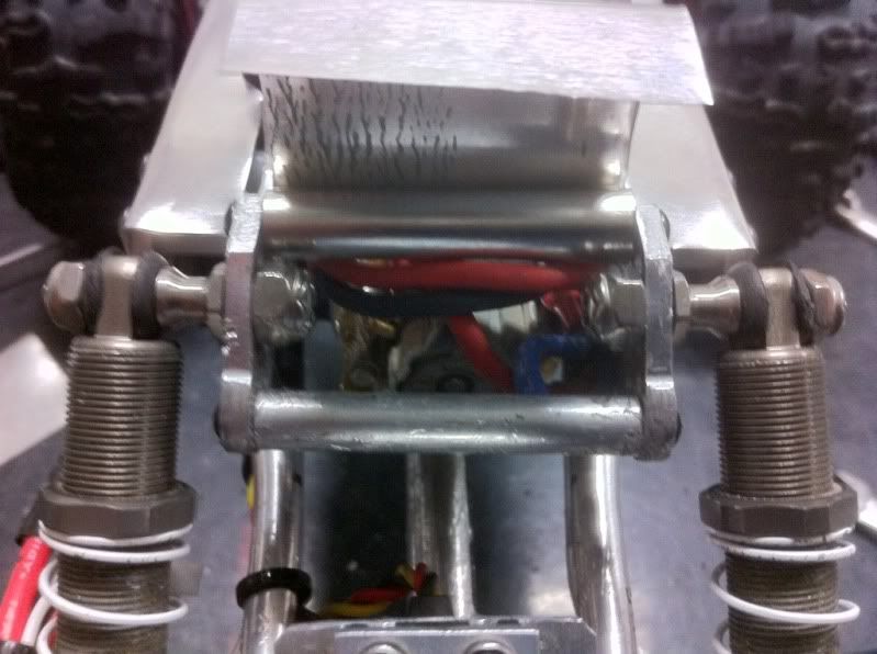

First up was re-mounting the losi shocks. Using the suplied mounts or doing the fuel tube mod I could'nt get the mounts as solid as I'd like so I stole an idea from my Dark Soul shock shafts on my 5T. I picked up a set of Hillman rubber grommets from Lowes. They're 7/16 od and 3/16 id, a tight fit into the eyelet but they do fit.
I also bought the Losi titanium mounts thinking they would be direct fit but sadly they're not....I had to slightly enlarge the hole on the chassis but not by much. I also checked the grommets with just a spacer and 3mm screws and I was able to get the mount tight and still have play for shock movement. These grommets are a much better option than fuel tubing imo...and cheap at only $1.27 each.
I shortened my rear lower links to maintain the 12-1/2" wheelbase per comp rules. Re-adusted my front upper links for better ackerman after fixing the c-hub oops..

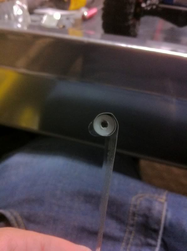

Next was finishing the panels. The tin was really easy to work with and was able to get the roof and hood mounted just by rolling the tin around the chassis brace.
