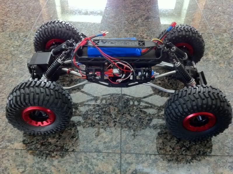

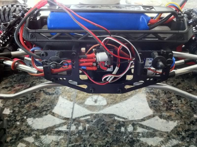

Got some wrok done today on the Creeper. I made a rear link mount/battery holder. Grinding the lower rear pumpkin smooth. Reversed the rear skid plate. Mounted the shocks to lower links and to chassis.(also flipped them upright as I'm having leak issues) (Though the fronts need to be moved inward). Also made a protective cover for the battery capacitor on the ESC. Big thanks for all of your guy's build threads to make getting a creeper set-up easy for us noobs...especially, rmdesignworks. On to pics...but flaked on getting pics of the rear plate fab. Here's the capacitor exposed.. ![]() And the new protector plate ![]() ![]() ![]() new rear link and battery mount ![]() ![]() ![]() ![]() front shocks that need to move inward to allow for more steering ![]() |

I'm still getting pretty bad torque twist with this set-up. If I go up an incline with my left front tire only, the right front will be higher (still suspended). If I go up an incline with my right tire then the left will follow. Going straight up will both wheels the right lifts and it wants to steer left. Looking at my rig what all can I do to help this? I'm still running the shocks stock, what would be a good beginning shock set-up to tweak from? |

| ![]() Quote:
TT is mainly link geometry...you have the rear set up well enough but you also need to seperate the front uppers...move them to the outside of the link tabs on the axle...15mm worth of spacer/s will be needed between the tabs or two rod end balls. Heres the problem...the front axle roll center is still too close to the front axle. Also your shocks need to angle outward from the chassis to the axle mounting points...not like stock but a little. Having them so far apart at the top and almost equally spread at the axle/s makes for less outward spring response. My front shocks are almost straight up and down from the chassis to the axle but my front upper links are spread apart. How much weight are you currently running in your front wheels? You need at least 3-4oz to help the front end settle the spring pre-loads. | |
