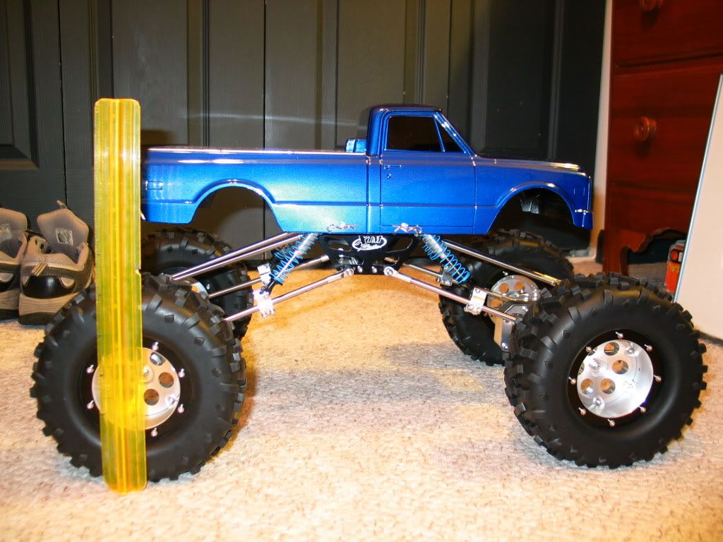

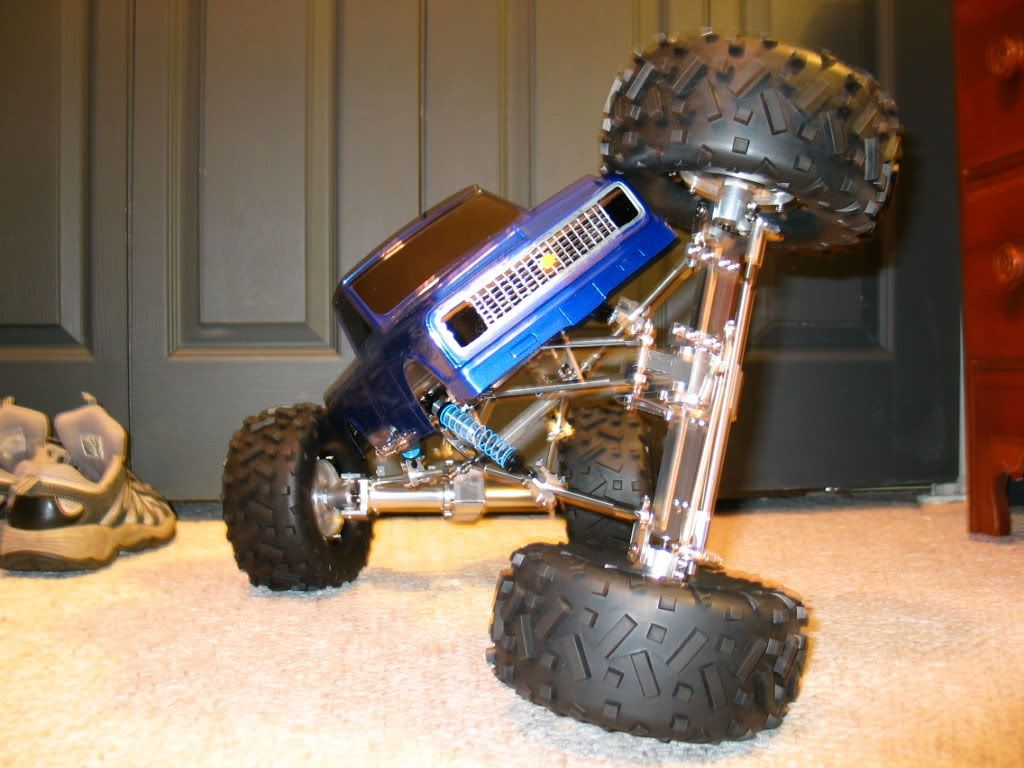

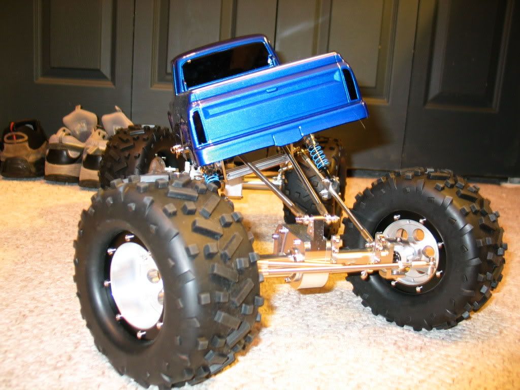

Here's my X-Crawler.
Right now it has a Parma 72 Chevy Truck body. Pactra True Blue Pearl with Indy Silver for the bed topper.
Gonna run Airtronics 94780M servos, CC bec, Spektrum Sr300 receiver, Tekin FX-R esc, Tekin Pro 55T motors, 8 EnerG 4600 nimh cells mounted to the axles.
Upgrades will include hardened steel screws, possibly RC4wd heim joint ball ends, diamond plate aluminum bumper/skid plates front and rear, and much more as I go along.

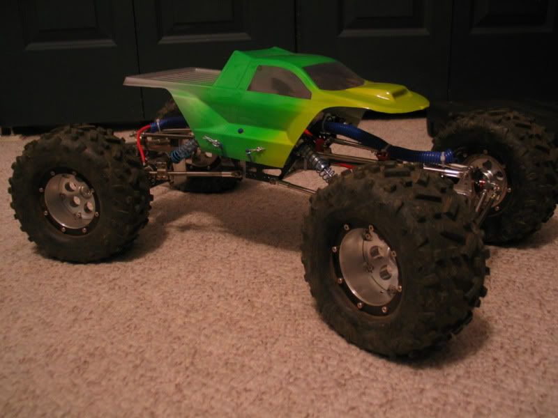

I haven't updated in a while. So here goes.
Wish I had gotten some pics of the build process, but oh well.
The new body, its also been lowered, a lot.
The mouse nest... Gonna clean this up once I get the FXR to put in it.
The bent sideplate. I bent it back as best I could, not worth replacing it just yet.
The shorter screws, and the servo arm (red was the only color they had).
The undercarriage. The battery is just temporary. I have the 8 cells which I had planned to mount on the axles, but they don't do me much good with the Rooster ESC, since it can only do 7. Gonna mount those when I get the FXR as well.
And it's still got that flex, though not quite as much now.
